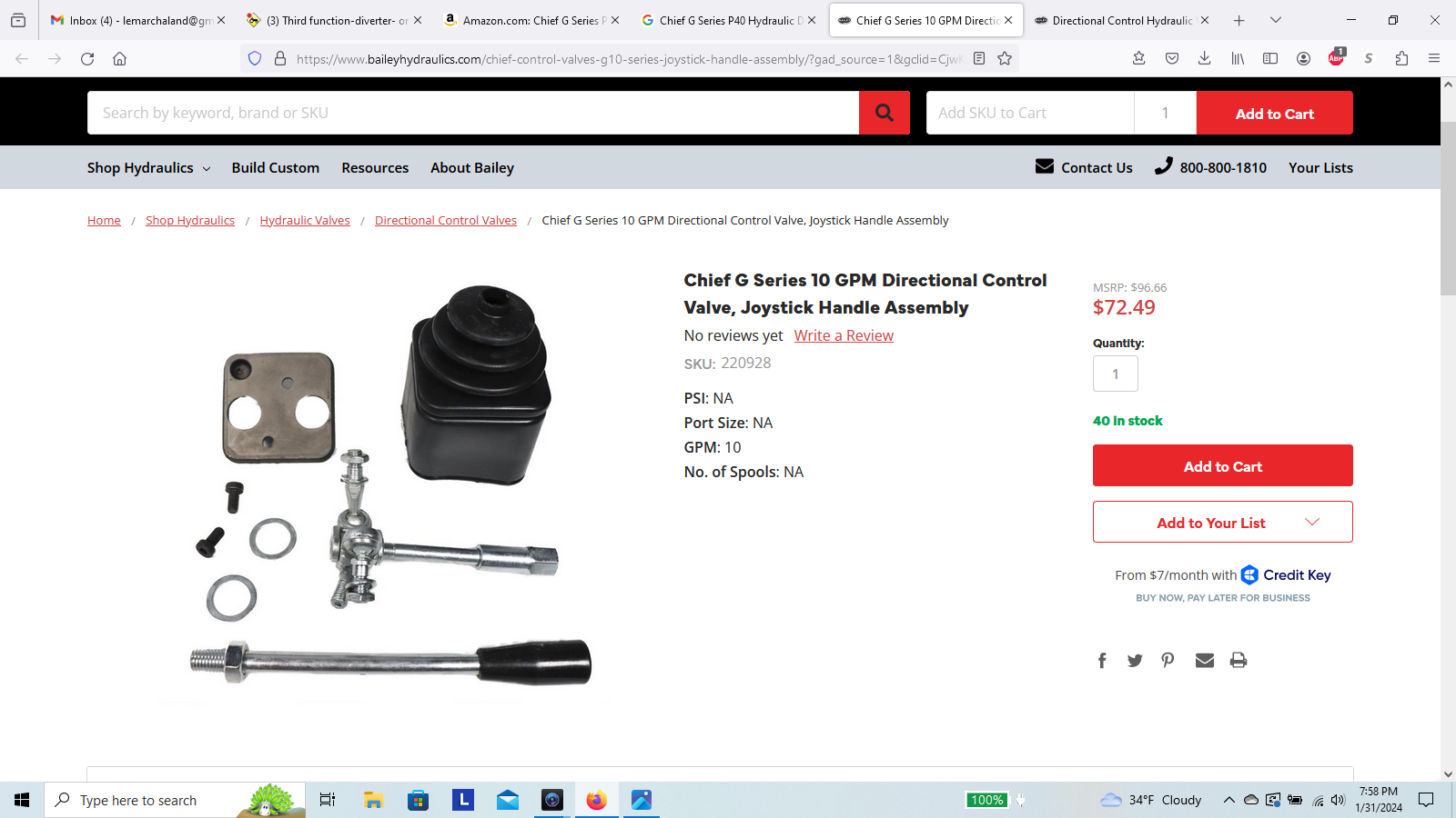

Beating the horse again, but I think... I found the correct spool valve.
As per earlier reply's, this one has float on the left stick, and I believe power beyond.
If I add the cost of two hoses, (or 4 + quick disconnects) maybe I can actually make this happen.
That valve and the plumbing will cost about the same as installing a diverter.
Also you can add a joystick to operate two of those spools for about $75.
And Bailey hydraulics has that valve for the same money, very likely the reseller on Amazon.
It's power beyond CAPABLE, but you need to order the sleeve separately. Did you do that?
