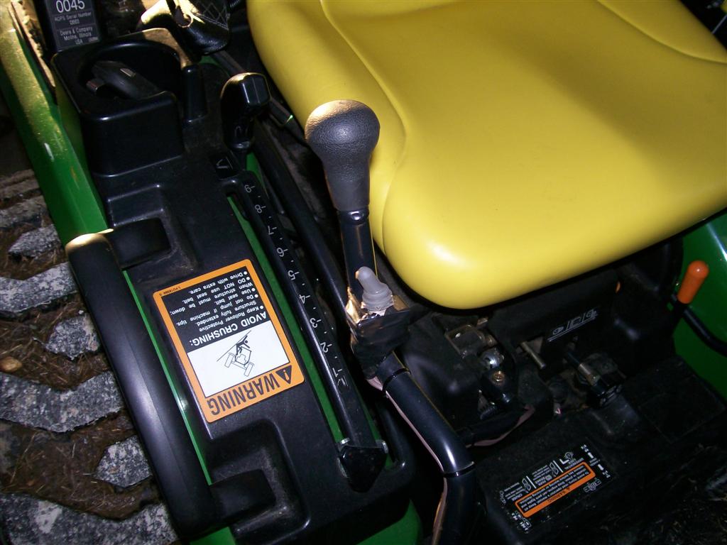

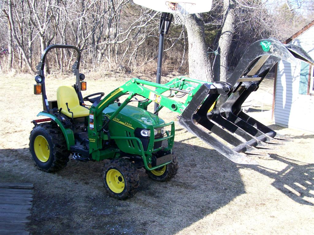

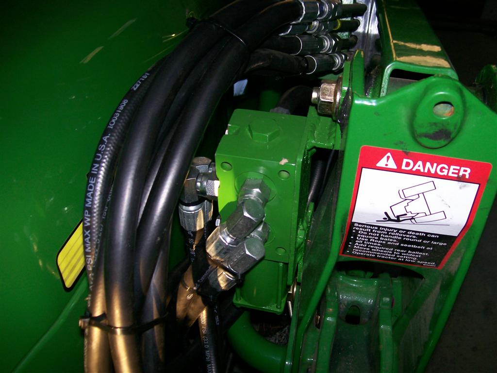

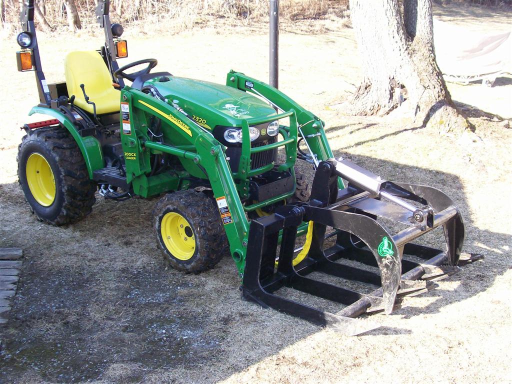

Dale I have done the exact setup that you want to do on my 2320 and it works great:DThe way I did it was to add a diverter valve on the loader mast with a switch on the joystick.With the valve off ,the loader works as normal for dump,curl.Flip the switch on the joystick to energize the valve and hydraulic fluid is diverted from the loader dump cylinders to the grapple.The grapple I got from Markham welding.I did this last winter.The grapple was $1000.00 delivered,the diverter valve I got from the surplus center for around $230.00 and have about another $250.00 in hoses and fittings.Hope this helps.Tim.

The diverter ONLY "diverts" the dump/curl circuit of the loader, it has NO effect on the lift/lower function of the loader. Basically when the switch is held (a momentary switch is used), moving the joystick left/right causes the grapple to open/close. Releasing the switch returns all functions to normal.

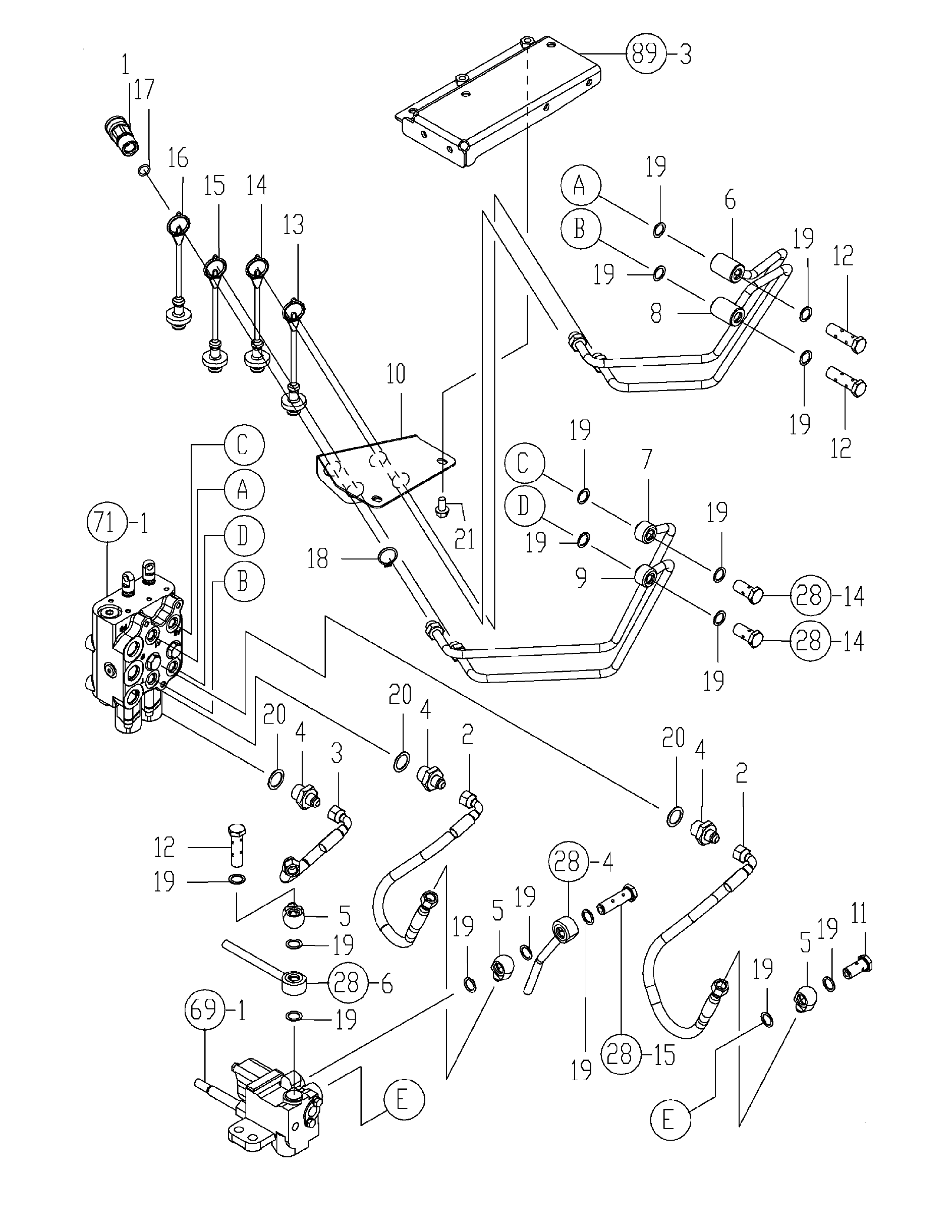

The weight of the 4n1 weighs 340 pounds. So it looks like a 40 pound difference between the grapple and 4n1. Like you say, brush isn't really heavy it's just bulky. I went over to the dealer this past weekend to check out a Sc2400 he had setup with the 4n1 and the WR Long kit, but being that it was a holiday weekend, he wasn't open. So I took a look at my hydraulics a little tonight to see how it plumbs and it looks like my 3 point is running off the PB port on the loader valve. Here's a picture of the loader valve. It looks like there might be a unused port on the 3 point that I might be able to tap into. I think I would probably split the line from the loader valve to the 3 point and run the controls off of that. That is if it's possible. I might just go with the WR long kit and be done with it as it would include everything I need and after pricing some items, the cost might be close to what the WR long kit is. I appreciate the help as I'm always looking to learn new things which is one reason I might go with piecing some things together so I can learn/understand how it all works. Attached is a picture of the loader valve.

Feeding a 3rd function valve from the PB port is great way to get this done.

I realise this is an old thread but hoping someone will reply. I own a EA2400 - the Australian version of the SC2400, and am trying to understand the hydraulic setup of my machine. Can someone tell me which are the power beyond, pressure and tank return ports on the left side of the fel valve (no. 71) in the picture in post 18? Thanking you in anticipation.
