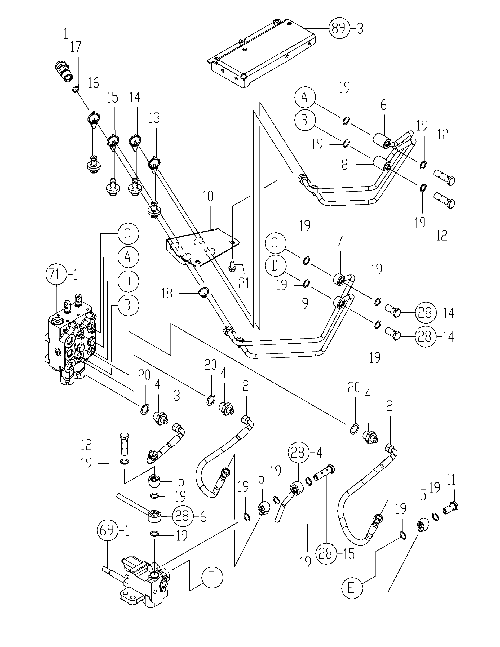

The weight of the 4n1 weighs 340 pounds. So it looks like a 40 pound difference between the grapple and 4n1. Like you say, brush isn't really heavy it's just bulky. I went over to the dealer this past weekend to check out a Sc2400 he had setup with the 4n1 and the WR Long kit, but being that it was a holiday weekend, he wasn't open. So I took a look at my hydraulics a little tonight to see how it plumbs and it looks like my 3 point is running off the PB port on the loader valve. Here's a picture of the loader valve. It looks like there might be a unused port on the 3 point that I might be able to tap into. I think I would probably split the line from the loader valve to the 3 point and run the controls off of that. That is if it's possible. I might just go with the WR long kit and be done with it as it would include everything I need and after pricing some items, the cost might be close to what the WR long kit is. I appreciate the help as I'm always looking to learn new things which is one reason I might go with piecing some things together so I can learn/understand how it all works. Attached is a picture of the loader valve.

The WR Long kit is a good deal...a few dollars can be saved piecing it together yourself, but a lot of time is lost-and you can loose money very quickly in shipping cost's from different suppliers.
Feeding a 3rd function valve from the PB port is great way to get this done.
   / third function for 2320 Hydraulics? #20
I realise this is an old thread but hoping someone will reply. I own a EA2400 - the Australian version of the SC2400, and am trying to understand the hydraulic setup of my machine. Can someone tell me which are the power beyond, pressure and tank return ports on the left side of the fel valve (no. 71) in the picture in post 18? Thanking you in anticipation.
