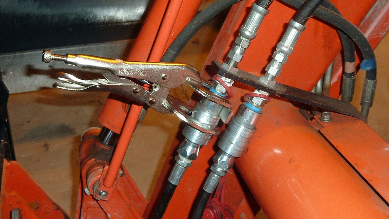

Need 2 couplers the Parker 4250-4 are a push pull with breakaway so equivalent to the 9500-4 in that function.
2*19=$38
Clamp to hold the couplers

I had the same issue. found an article that said to cover the flat surface with a rag the tap it with a hammer. It releases the pressure and they go together nice. I was gun shy at first about hitting it with a hammer but was tired of fitting it every time. works great for me.
What I do and I hook and unhook a lot of hydraulic couplers. Have my wife hold the male or female end, cover it with a rag and use a brass punch and a hammer to pop the poppet and relieve the pressure. I lose some fluid in the process but I always have at least a full 5 gallon bucket on hand to refill if low.
