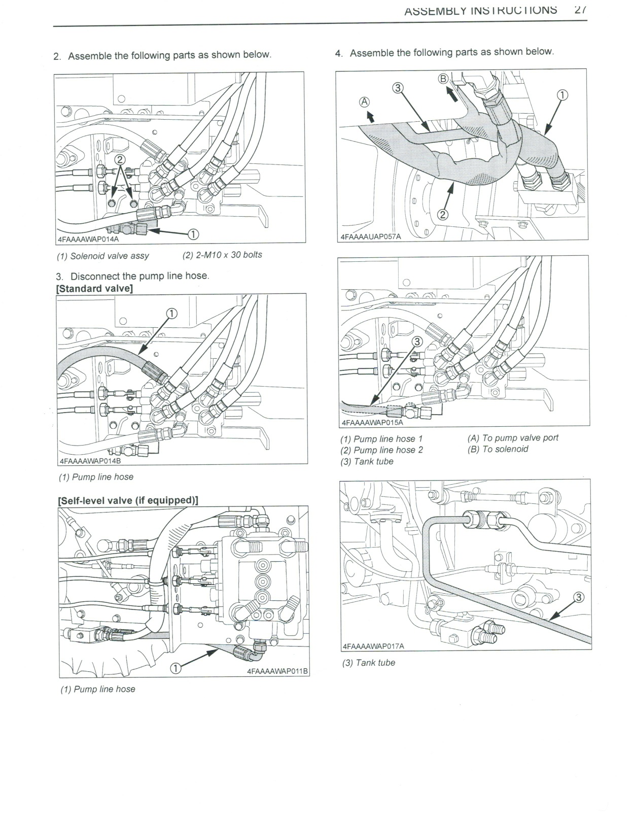

If you have a double solenoid valve, it will have 4 ports, and work the grapple when the button is selected.
If your valve has 6 ports, it is a diverter valve and uses the curl circuit for hyd.
I just can't see any 3rd function valve or diverter valve installed before the loader. The service guys from Messicks says it isn't so.
So someone is saying that the pump flow goes into the 3 function valve first. Show me some pictures. Please.
   / third function value help with Kubota #16
"Someone" pulled this from his loader manual and the hose routing matches what is installed on "Someone's" machine. "Someone's" machine has the self-leveling valve. Unlike the standard valve, the self-leveling valve is supplied (the pump port) from the bottom. The PB (nearest) and tank (rear most) ports are both on top. The pressure line runs from pump to block inner port to 3FV to loader to block outer port to rear of machine. The instructions assume that one is adding the 3FV to an existing loader installation. The instructions say to disconnect the pump line hose. Figure 4 shows Hose (1) running from the pump block to the inlet of the 3FV. Hose (2) runs from the PB of the 3FV to the inlet (pump port) of the loader valve (where the pump line was removed in the above instruction). The PB line from the loader valve to the pump block is unchanged. The tank lines are merged.
