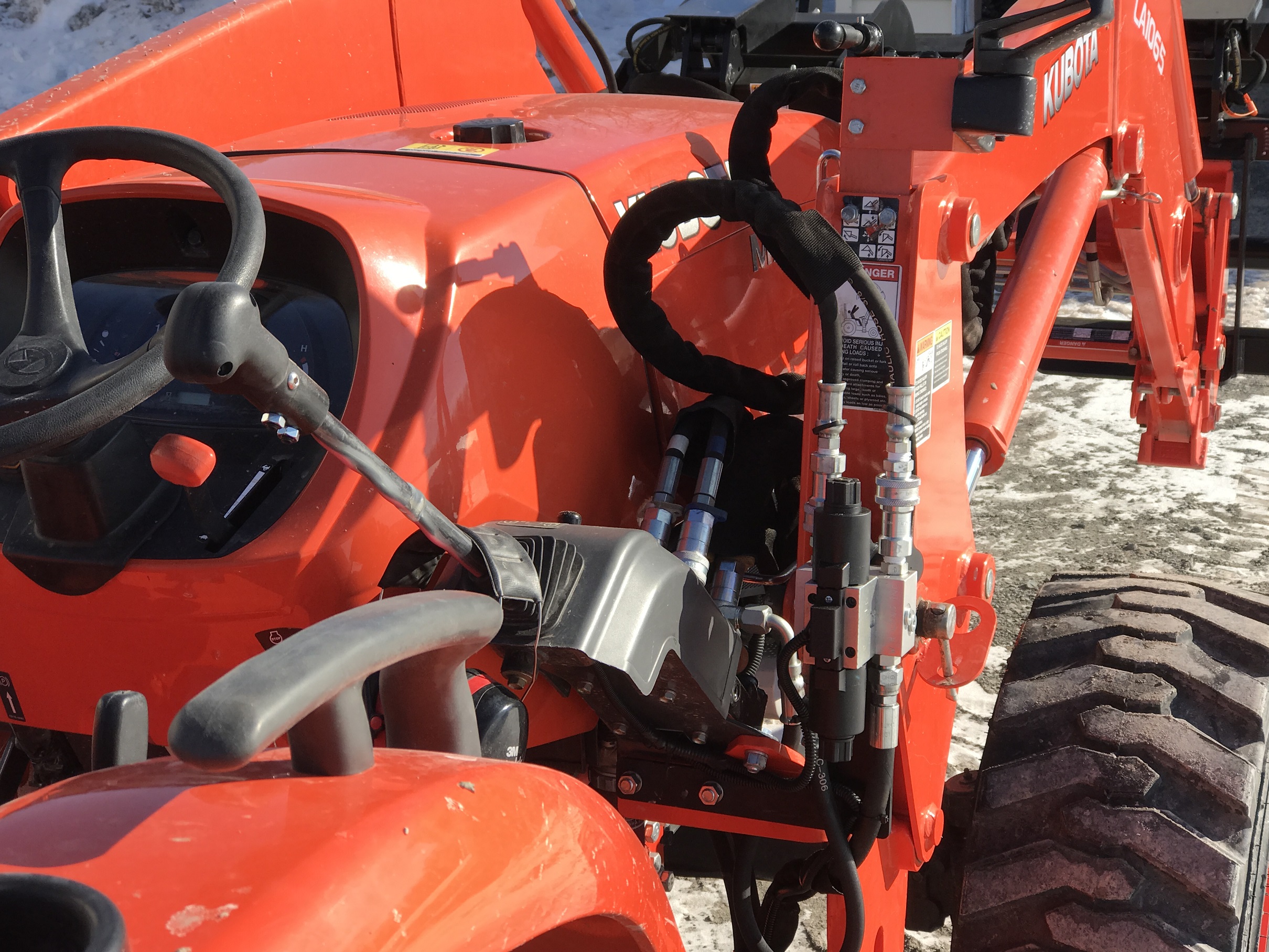

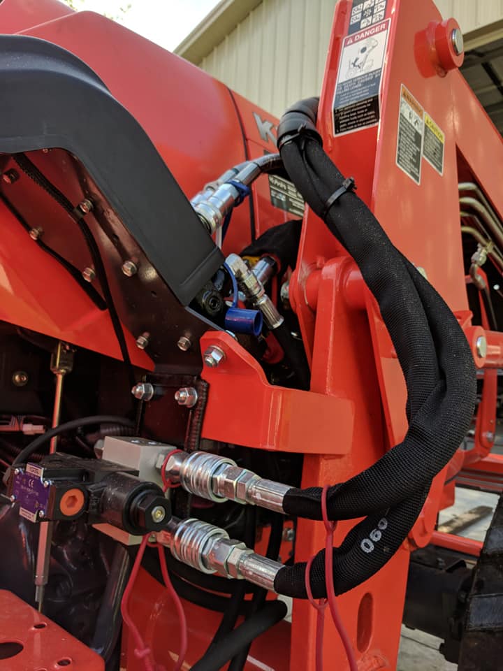

W&R Long 3rd function valve kit on my MX5800:
Easy 90 minute install. Works well and no complaints. I also installed one on my L6060.

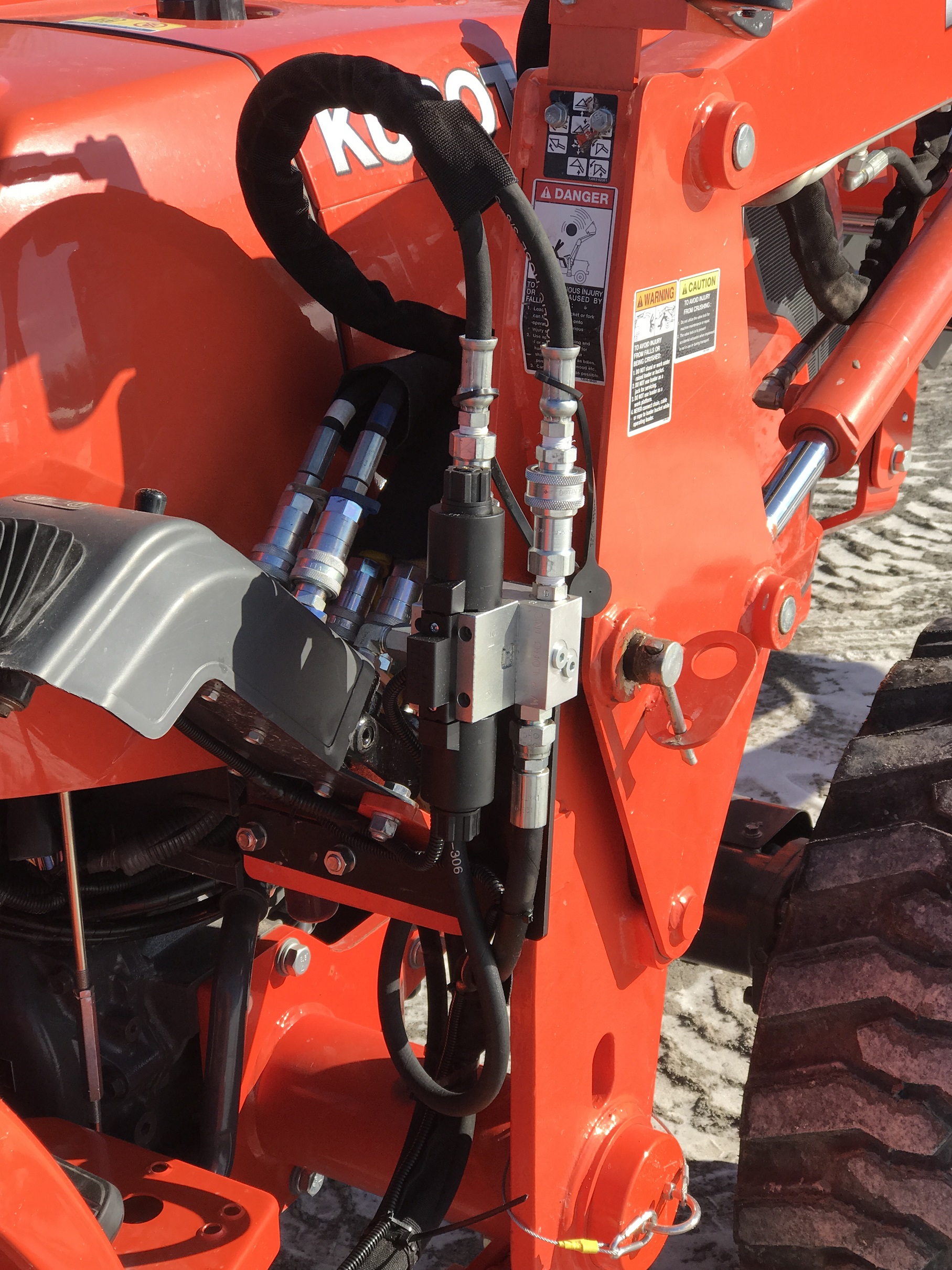

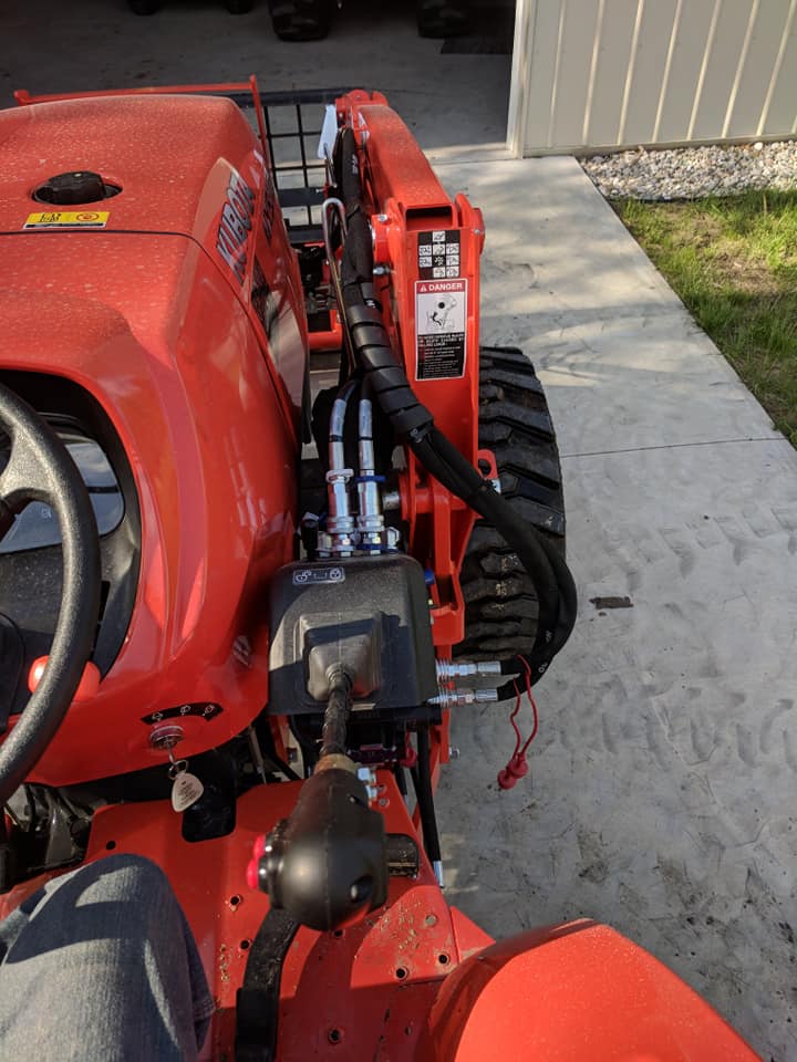

Just like nbking - I had the dealer install my W R Long valve kit and grapple. Everything is on the inside of the FEL arms and protected from limbs, roots, stobs etc. A couple of pics will explain. Everything is either between the FEL and tractor body or covered by that "shield".
View attachment 593709View attachment 593710
