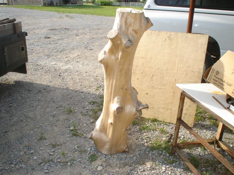

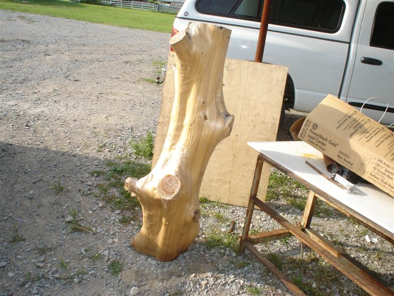

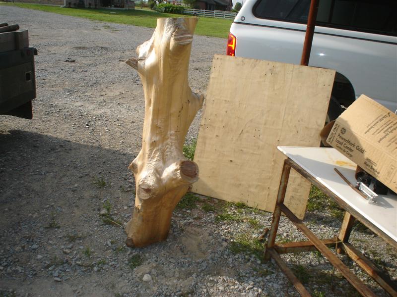

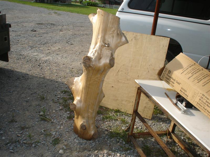

Sometimes you get hooked on an idea. This log got me. She just screamed she wanted to be the key pad holder for the big timber gate.

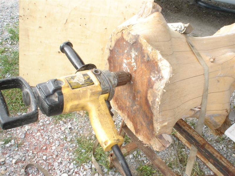

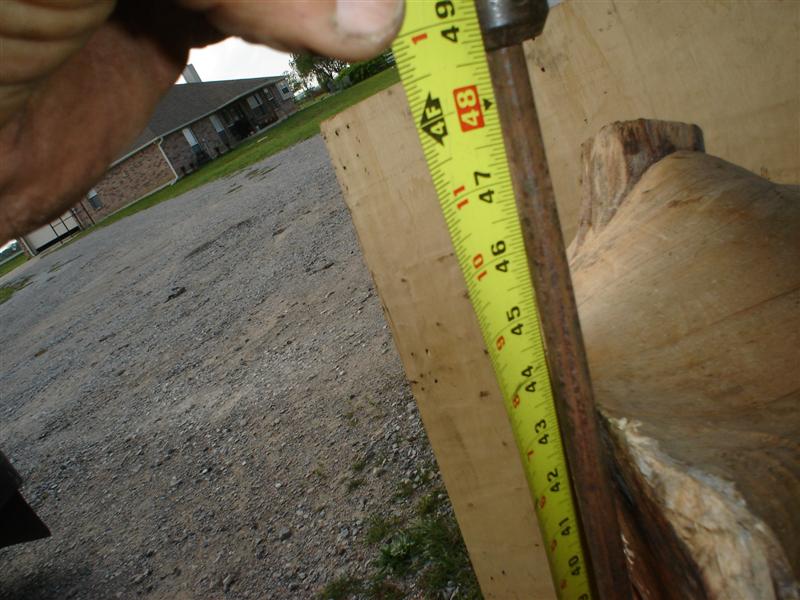

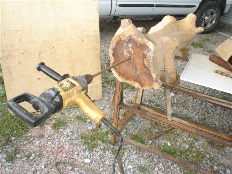

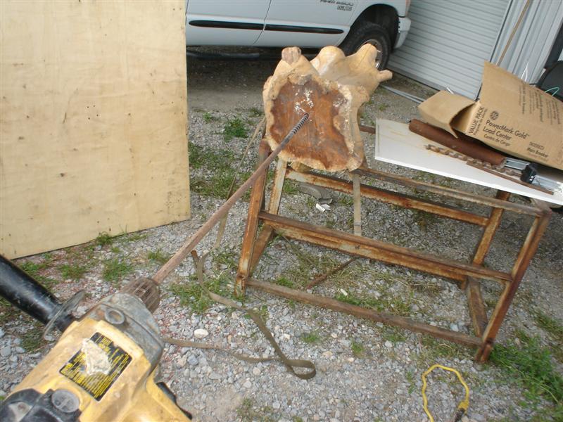

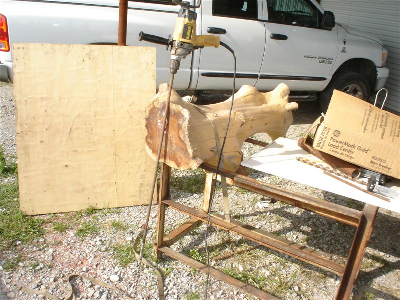

Of course the hiccup in the getup is she needed plumbing. You know, plumbing, electrical plumbing.
I needed a three quarter on an inch hole from what she sits on to about forty five inches above grade. That's where the key pad will sit and I need an eight conductor wire to the key pad. I don't want the wiring to show. So all I had to do was drill a three quarter inch hole about four feet long bottomside up.
Nothing but a thing.

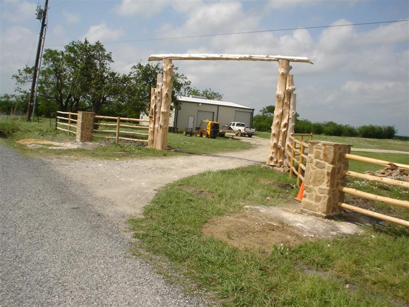

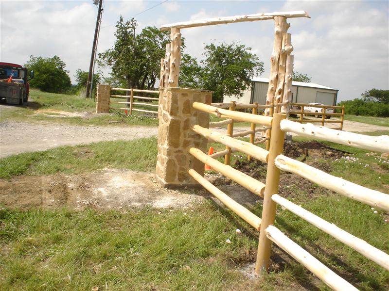

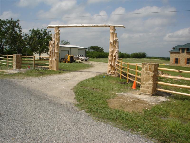

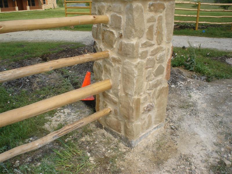

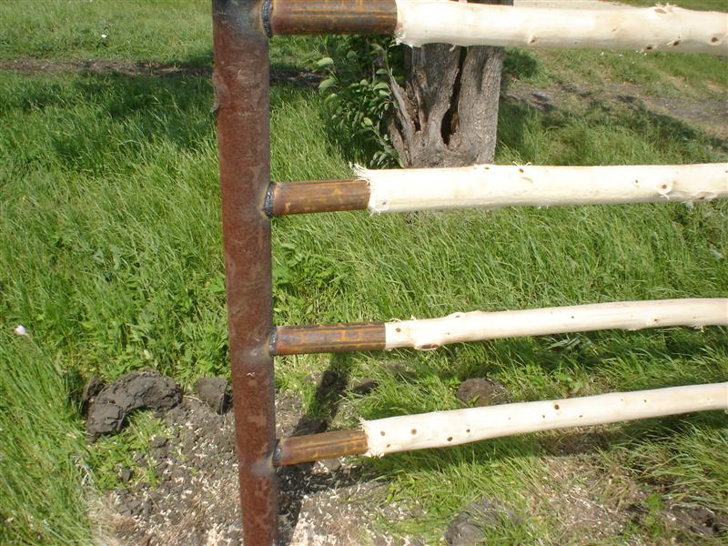

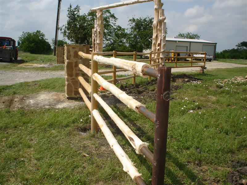

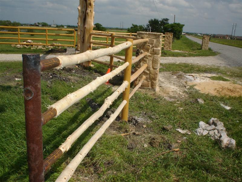

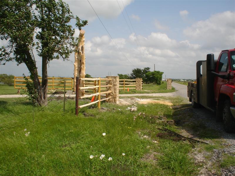

It's coming together a little more each day. The masons are done with the columns and I finished the transition panels from the new fence to the old barbwire and t post fenc.

Harvey: That entranceway is rapidly changing from a project to a statement. The statement is, "Hey, let's see you top this!" That is one beautiful piece of work.
