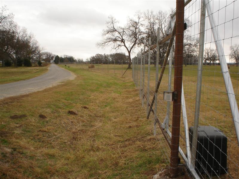

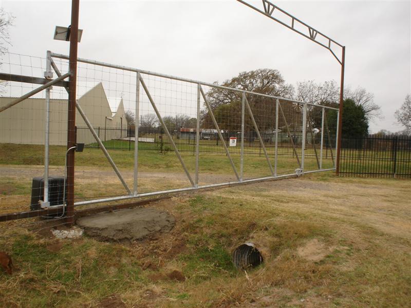

We got back from vacation and went straight to Eddies for the Octoberfest get together.
Since then we've stretched and tied in about eleven hundred feet of eight feet high fence. The posts and braces were done by others. We stretched and tied in one strand of barbwire top and bottom. Posts were set on fourteen foot centers and the pulling brace was in the middle.

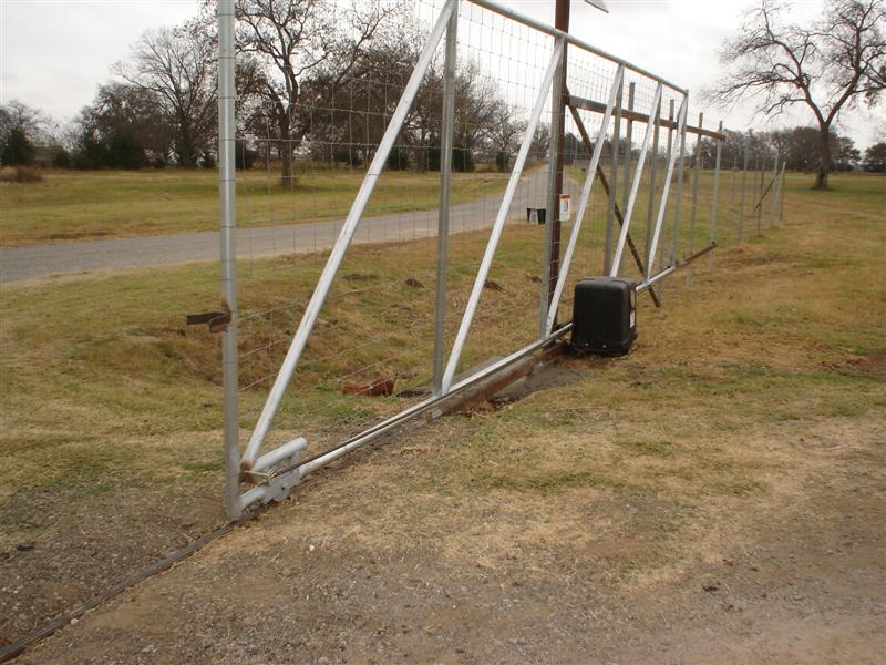

The client had a forty foot opening and wanted a slide gate. I talked them into a thirty foot slide with a ten foot swing gate for those rare occasions they need the extra clearance.

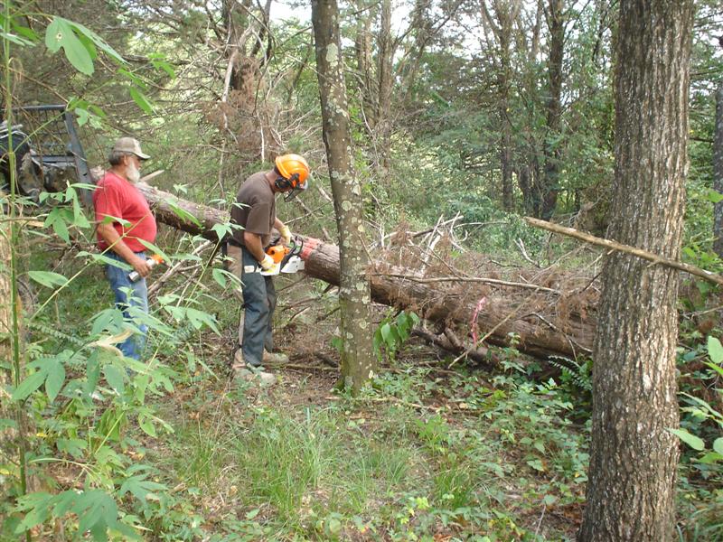

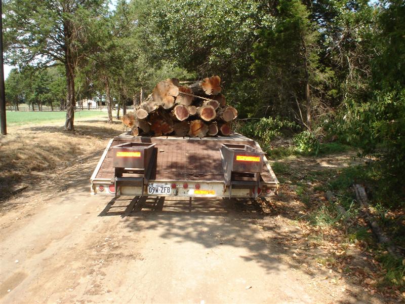

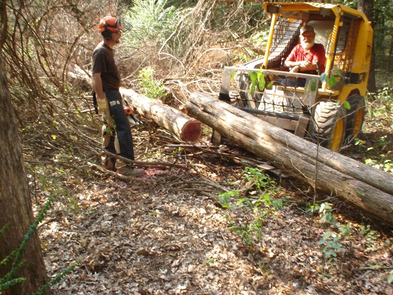

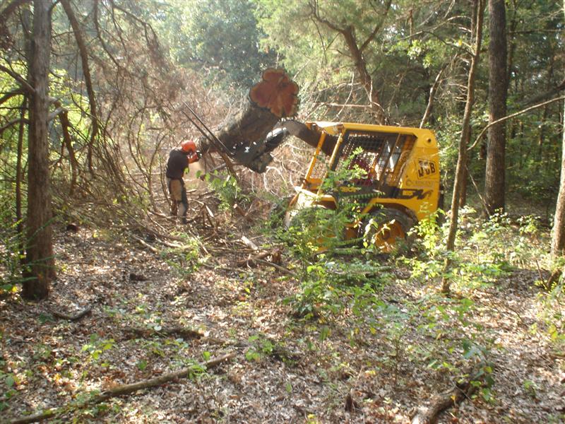

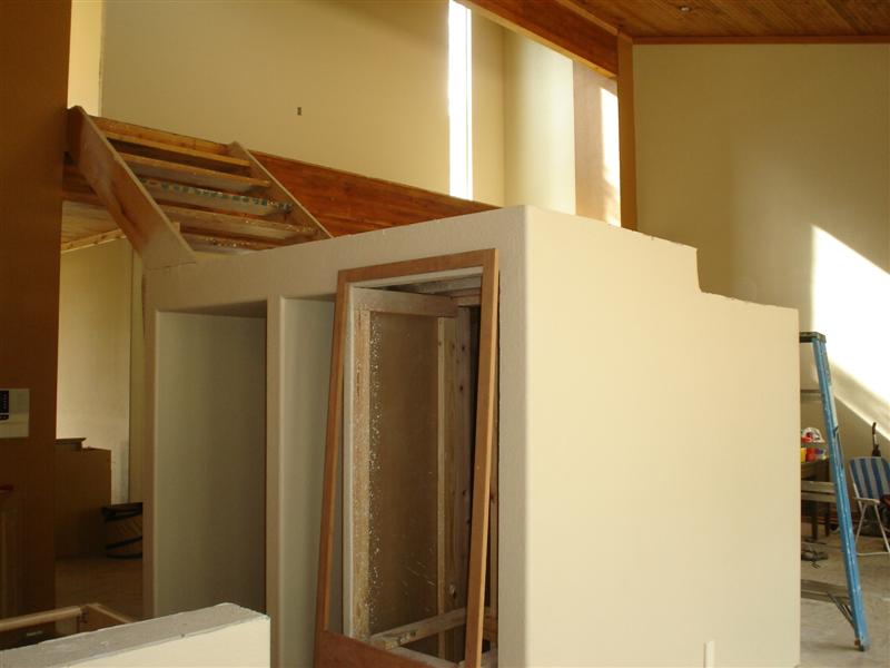

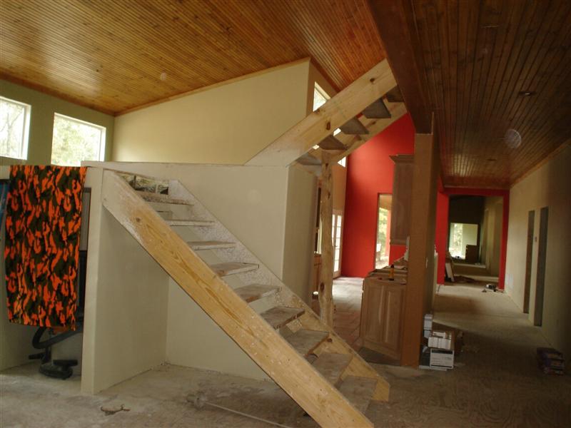

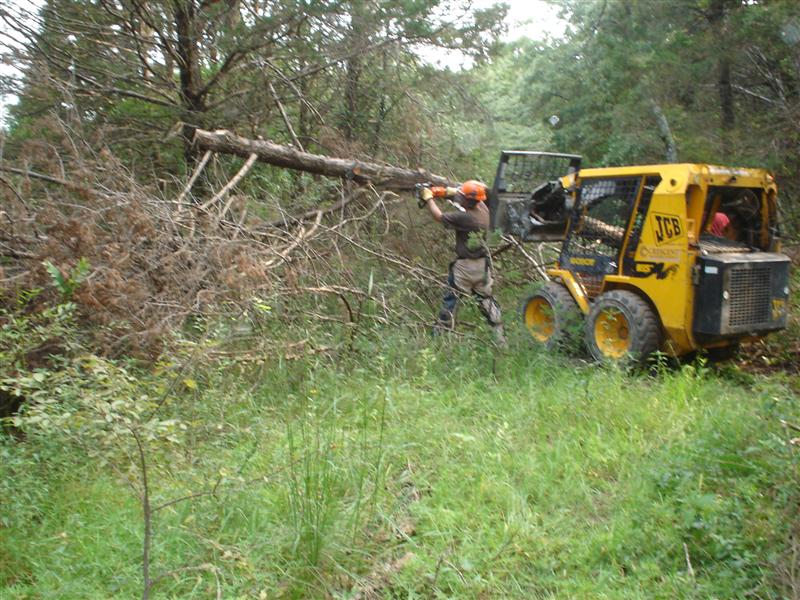

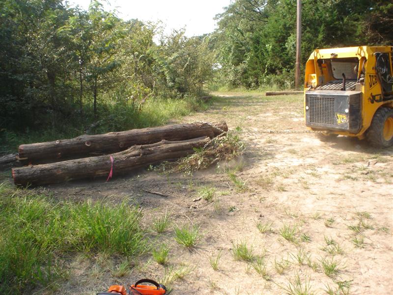

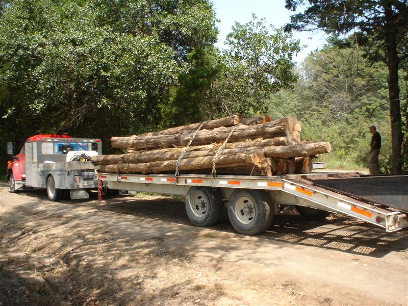

Back in August we started a staircase with a client.
They bought into my idea of a eastern red cedar staircase. So back in August we went into the woods and cut us some logs.

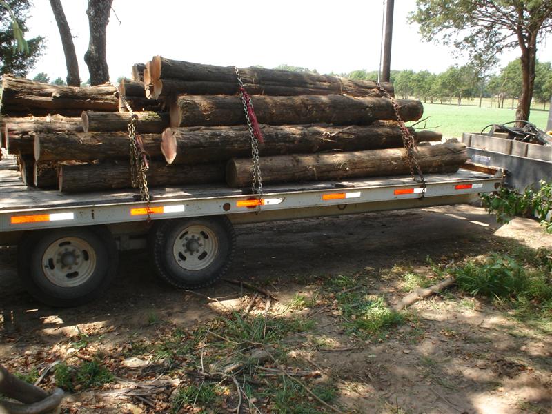

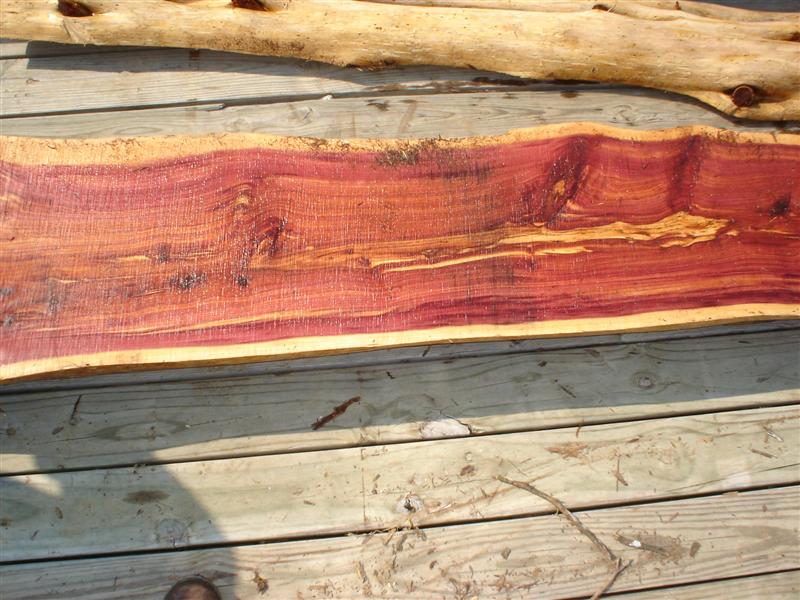

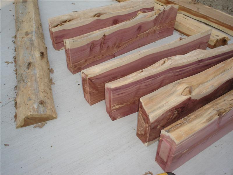

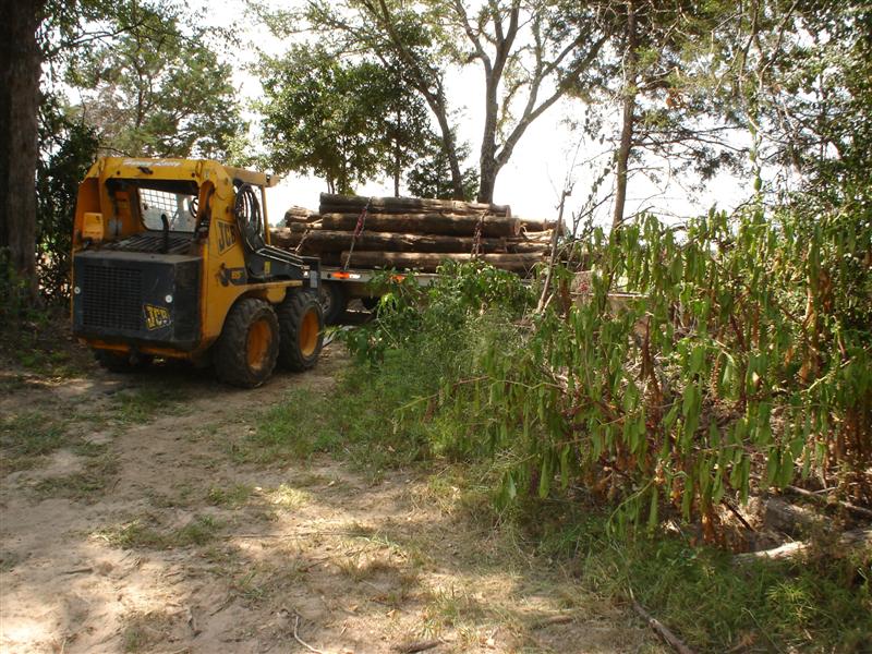

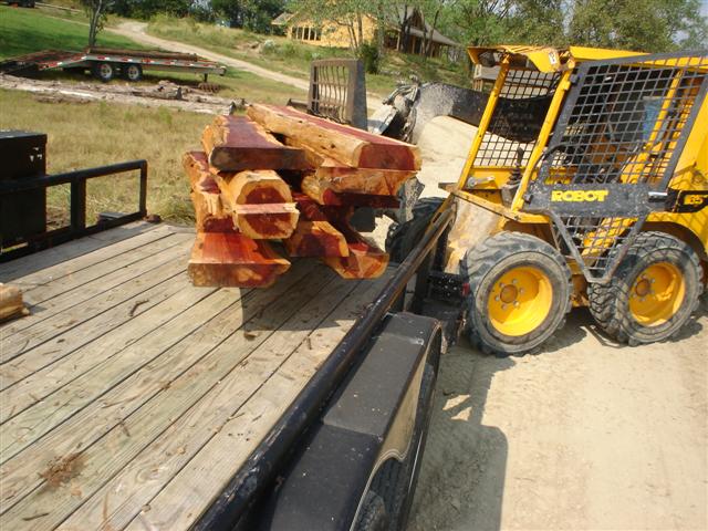

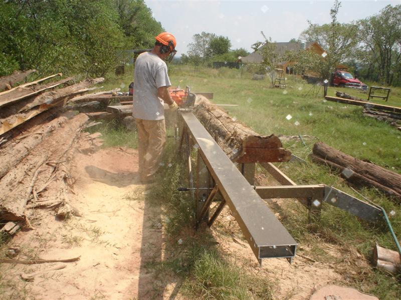

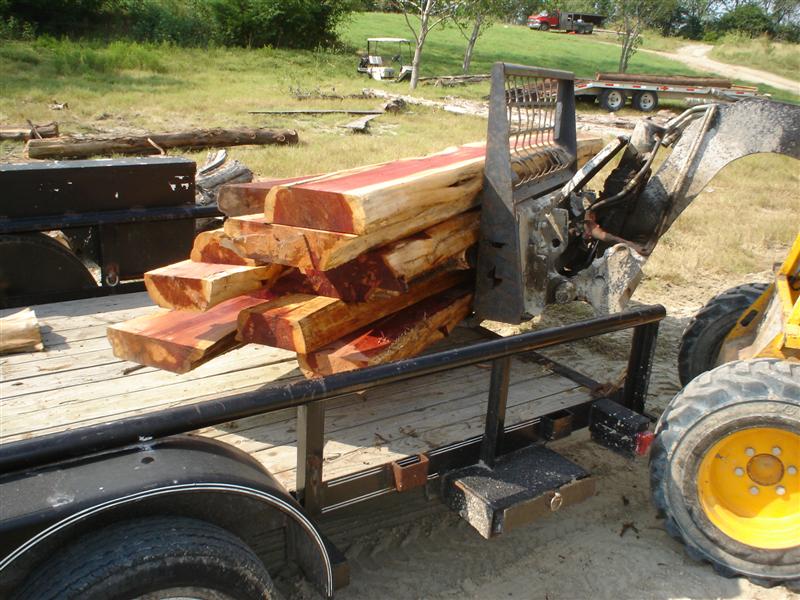

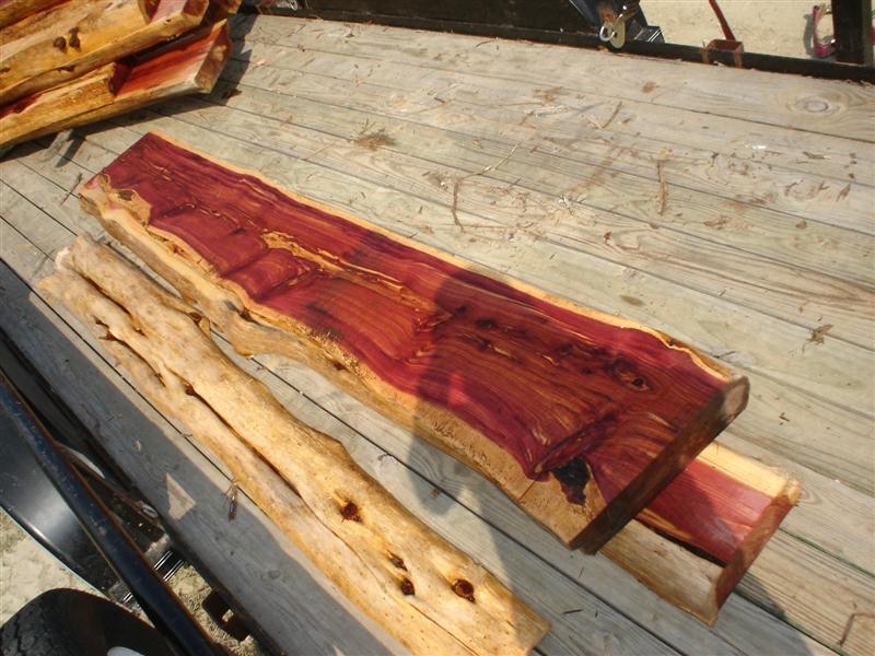

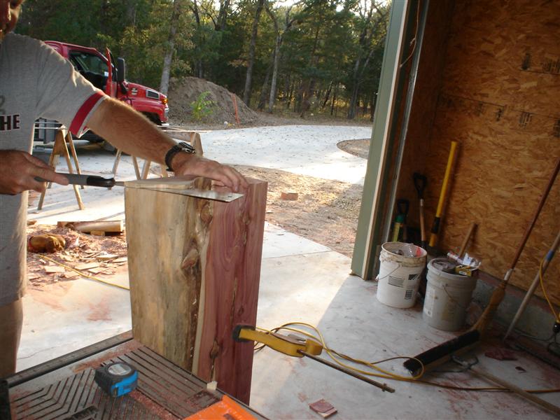

Then we took the logs to a friends place and cut them into slabs for use as runners and treads.

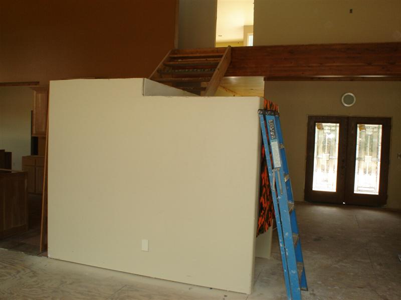

Life has been busy for both of us, the client and myself.
Here's what we're looking at.

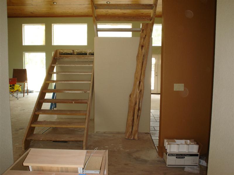

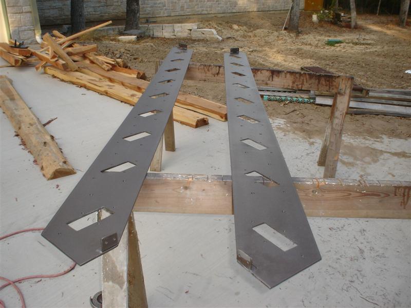

What the client fell for, my ideas, unproven, unusual, etc and so on, was big cedar treads mortise and tenoned into a steel skeleton hidden in a cedar runner.
Something like this:
/ This, that, and the other

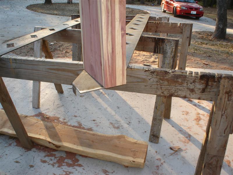

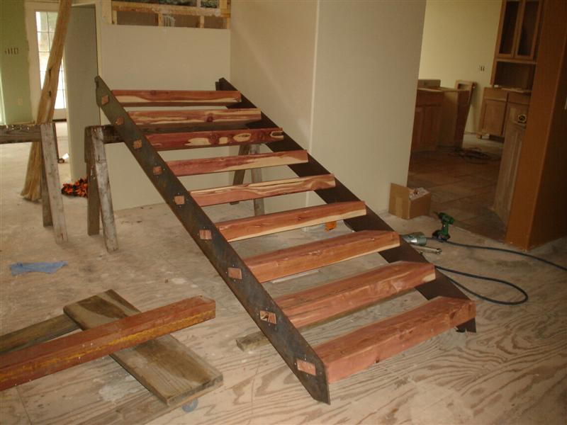

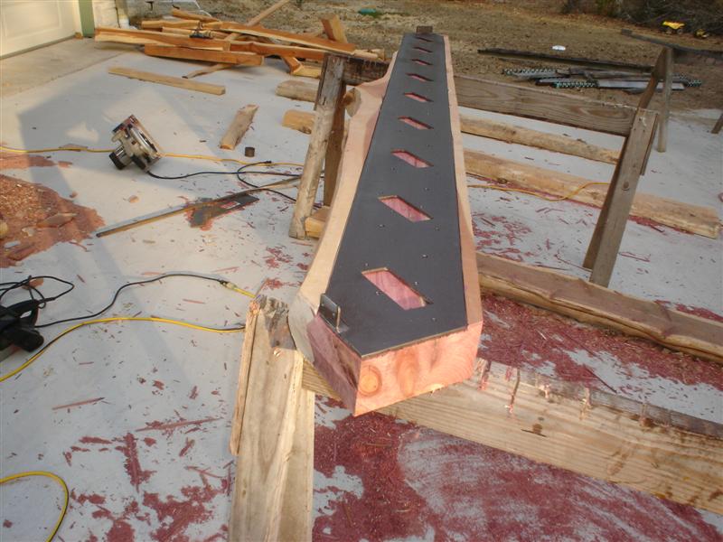

Like a lot of my projects, this is a twofer one. What I mean by that is we get not only the fun of building the project, we get to build the tooling etc too.
One of the pleasures of this particular project is the client is an artist and can visualize concepts immediately. It's growing as it's going up.

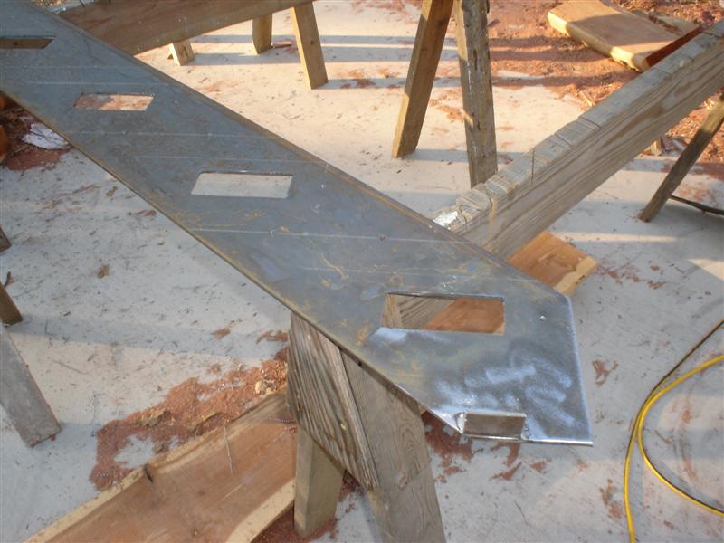

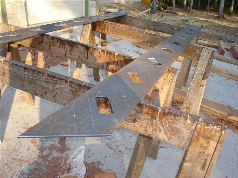

As of now here's the plan. We're taking the nine worst treads for the lower staircase. Worst as in the most un-nice unfinished edge that goes to the rear of the tread. The poorest of the poor will go to the bottom two treads, you'll have to be on your knees to inspect them. The next two poorest will go at the top of the bottom section where they'll be facing the wall of the pantry/fridge pedestal.
We've got to build a temporary carriage to handle the completed section as we move it in and out cutting the runners in. The inside one will be tricky because the bottom half will have handrail and the upper half will not.
The treads will be cut into the mortises of the quarter by eight inch steel skeleton. We're also attaching the skeleton to the treads with stainless screws. Then the runners will be cut to accept the skeleton. The runners will also be attached to the skeleton by way of semi-hidden stainless screws. Hopefully the steel skeleton will noticed only by the most observant.
The runners are four inches wide. On top of them we'll attach a three by three rail drilled to accept the pickets. Right now our plan is to cut out and lathe round the pickets out of scraps. We want red and white with no knots. The hand rail on top of the picket will be cedar cut and shaped by us also. The hand rails along the hallway at the top of the stairs will match the construction of the staircase.
Over the next couple of weeks I'll try to update the photos as we go along.

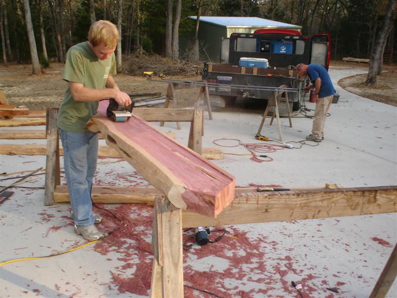

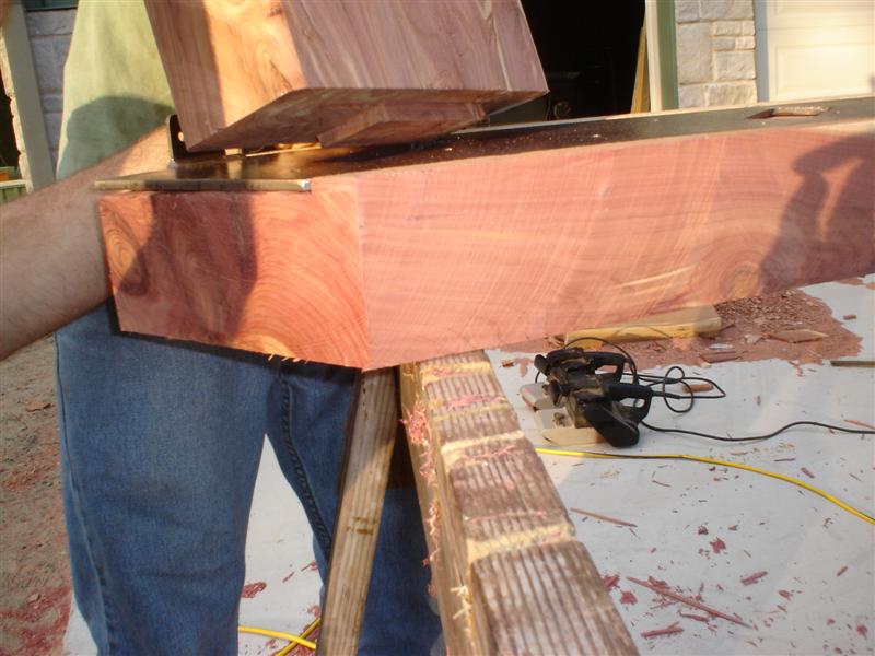

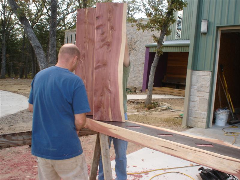

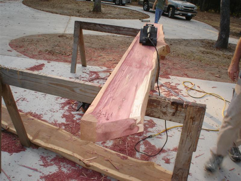

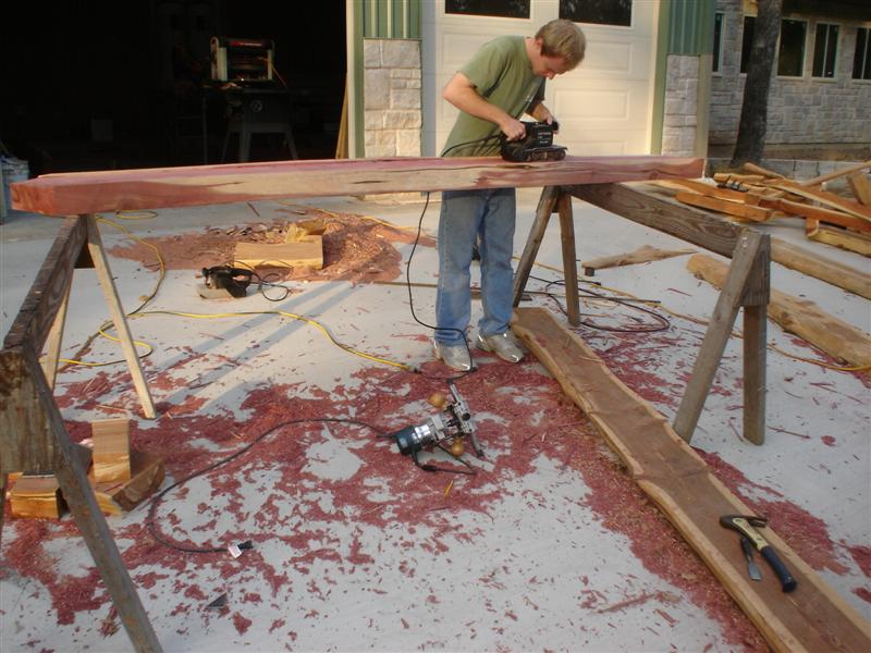

Today was a good day. It got even better when I was able to break away from work work and go over to the staircase project.

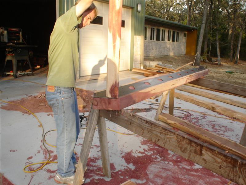

They had finished cutting the tenons on the treads and so we got down to carving a runner for the steel skeleton. We used a circular saw, a router, chisels, and finished it off with belt sanders.

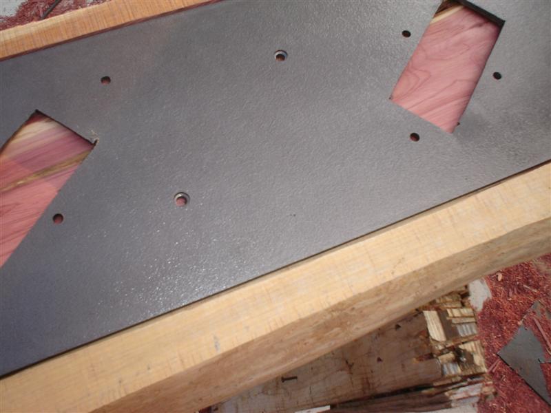

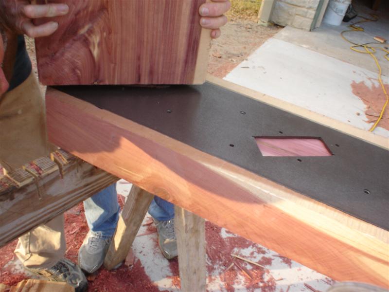

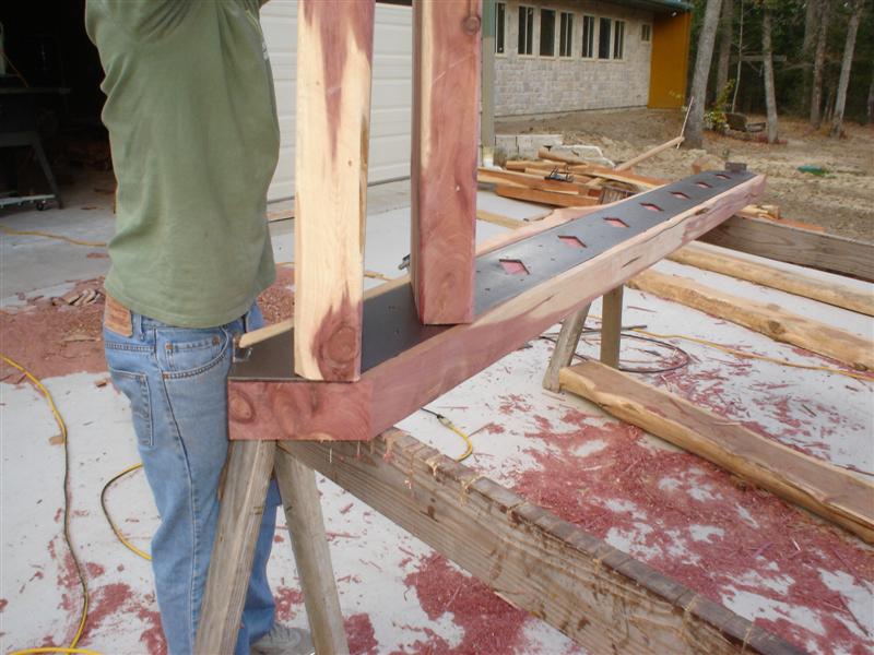

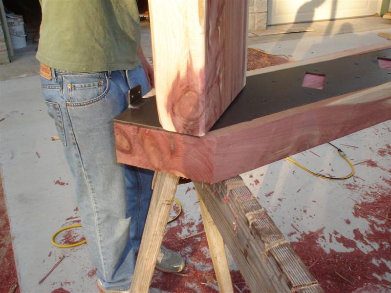

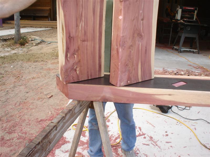

The way it will work is we'll attach the treads to the steel skeleton. Then we'll remove the excess tenon material. Then the runners will be attached.
We countersunk all the screw holes. Some of the holes are for the treads and some are for the runner.
Of course we had to do a trial fit.

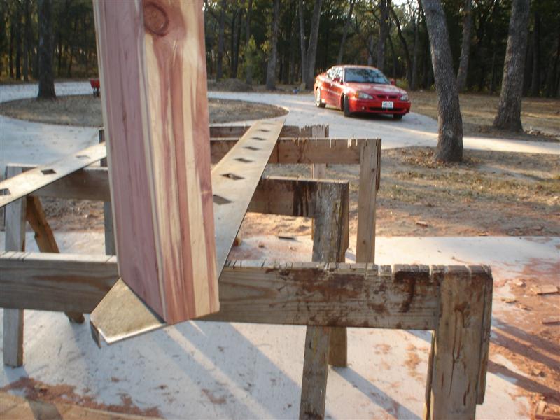

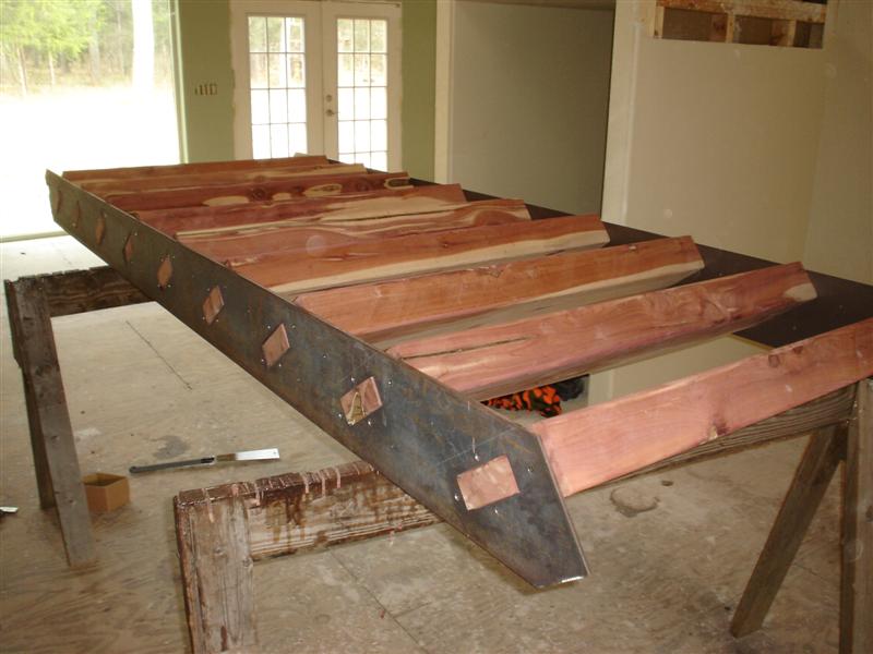

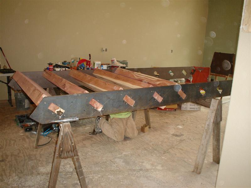

Maybe the best way to explain how I come up with these things is to define it as a reaction. In an empty room with no stimulus I'd be as creative as a log. But when something stimulates me I'm along for the ride. I can't take credit for the ideas because I have no control over them. One minute there's nothing and the next there's not only a concept but a good idea about how to make it happen.
These stairs are a classic example of that phenomena. Client/friend asks me for ideas on some stairs. He wants something unique and he hasn't found anything that catches his fancy. Out of clear air I suggest big beam cedar open stairs. What's funny in it's own way was as I was explaining my idea to him I was seeing the finished product. Of course he had questions about the details. I was able to answer his questions and we decided to go ahead as time allowed.

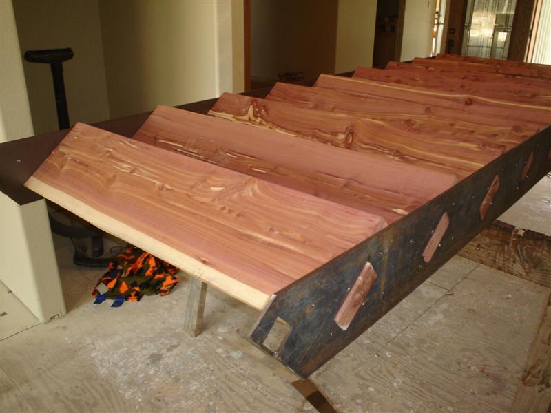

Today was one of those great ones. I got to see in three D touchy feely what we'd discussed initially. What is even more fun or rewarding if you will was the client/friend's reaction.

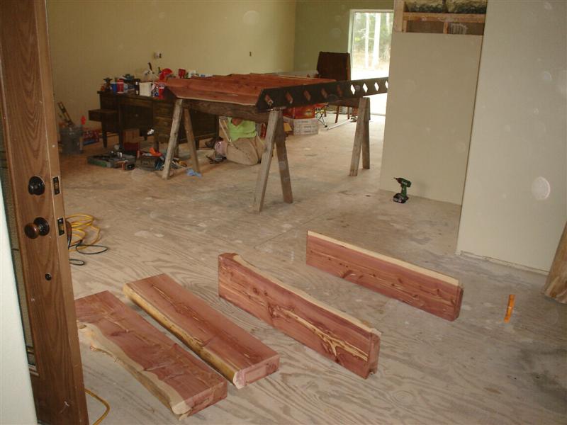

It started off with us assemblying the parts.
