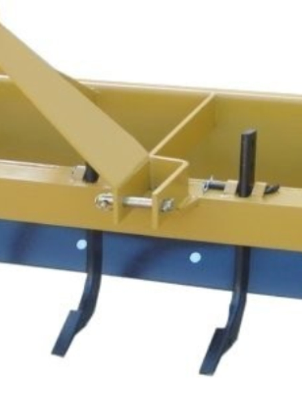

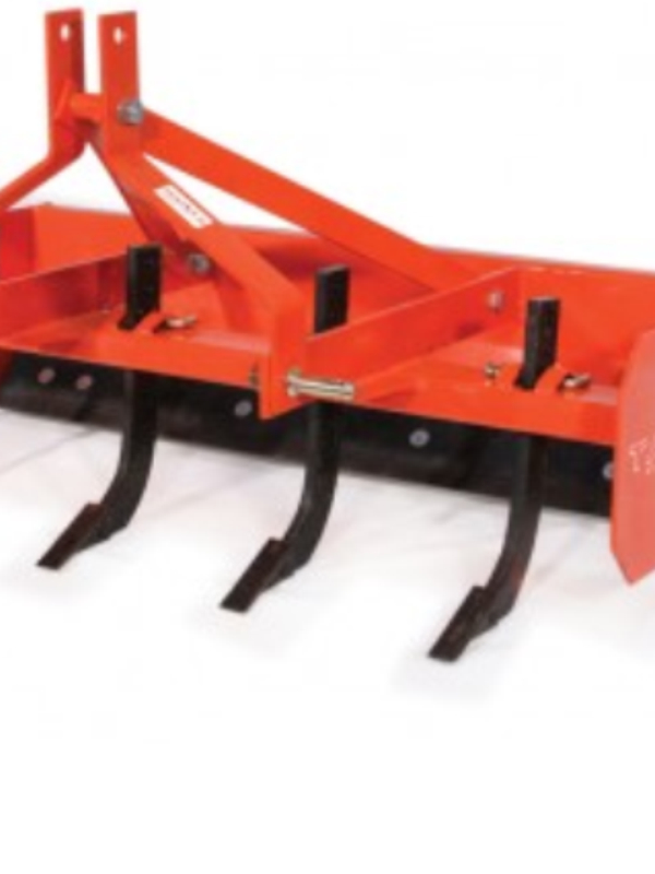

For the grading/trail maintenance I am thinking box blade. 48" seems to be the magic number for the little tractors, so that is where I am heading.

Box Blade (link is to Rural King, but TS has the exact same model in stores
Tarter 4' Box Blade SC BBSCR4 by Tarter (ORANGE color) for $521.97 in Box Blades - 3 Point Blades & Box Blades - 3 Point Equipment & Accessories - Agriculture : Rural King

Sounds like you are headed in the right direction. I would price Land Pride implements before going to TSC. In my opinion, they are of a better grade and offer colors that match your BX-25. The yellow color of the other brand clash too much with the Kubota orange for my liking.
   / This tractor thing is addicting, need some guidance on implements #4
My 60" land pride box blade was only $450 from my dealer....

Your tractor might not be strong enough to make any difference, but any box blade that doesn't have reinforcement on the hitch pins is junk.
