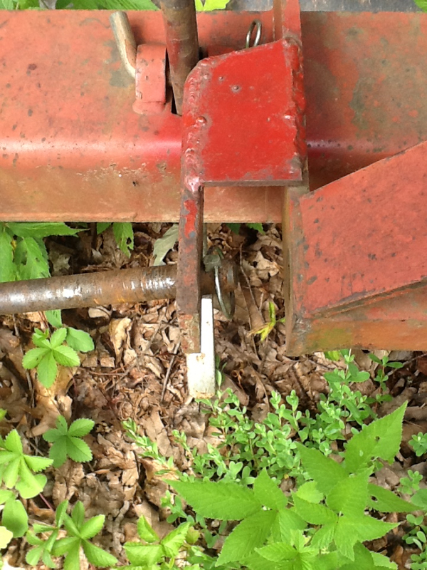

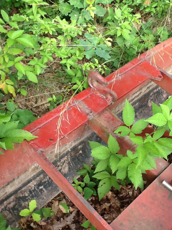

My box blade had reinforcements on the pins and I still bent them. I welded a 1/4 plate across the top. While I has at it I added a bar across the back to weld a chain hook on.
