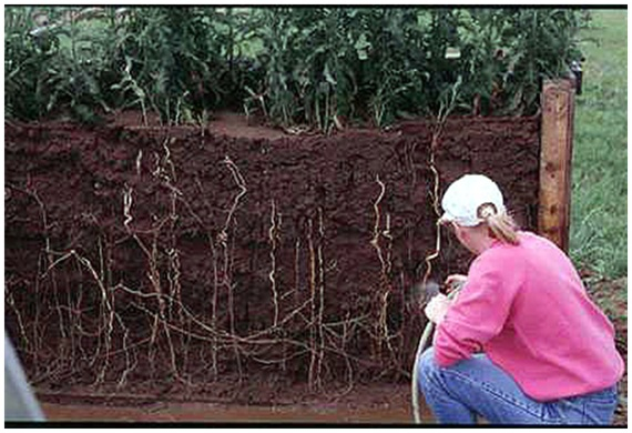

Not to pop anyone's bubble but pulling the roots on a Canada Thistle is not what you might think. The roots are very deep and have lateral spreading roots. See stock pictures from Google searches. Cultivation can work, but since the roots re-sprout, you must stay after them to starve out the roots. Seed is proficient but viability is low when the seeds land on other crops but are very effective when they land on open soil. Locally they are likely to spread by the lateral roots, with seed for establishing new or distant areas of infestation. What is unclear to me is if herbicides like Roundup, which attacks the roots, can kill plants across the lateral roots. They did not become a noxious weed in as many states and countries as they have because they are easy to control.
