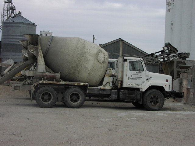

In my experience, the only sure, immediate, and permanent thistle solution comes in these trucks.
Bruce
   / Thistle epidemic... how to handle? #35
Bruce
<img src="http://www.tractorbynet.com/forums/attachment.php?attachmentid=340608"/>
At least until it cracks
Bruce
Actually, Canada Thistle grows very well in Concrete.
