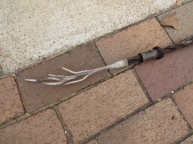

I found a devil’s fork lightning rod on my place with a metal detector, it looks evil.
   / Those with lightning storms, how do you protect electronics? #64
Could you post a picture, if it's not much trouble.
   / Those with lightning storms, how do you protect electronics? #67
I use it on top of my keyhole garden roof for an item of interest.
