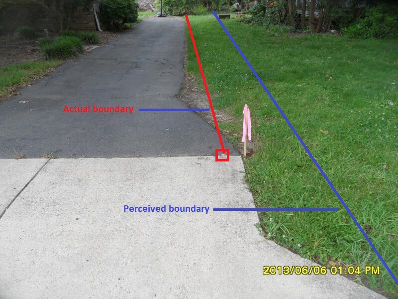

I've lived in Fairfax County, Virginia since the mid-70's. It is home to the USGS and and has an excellent mapping department. Despite that when they redid the street in front of a house I own they messed up the driveway apron. Now for perspective, based on valuation for taxes, land around my house goes for about $850,000 dollars an acre.
Here's the apron:
attachment.php
I own to the right.
A guy bought the house to the left and was flipping it. He wanted to widen his drive to the perceived boundary. I caught him and told him NO, I own much of that. So I immediately got a survey. It shows as inside the driveway apron by about 4 inches. He went and got a survey. They confirmed my survey.
He flipped the house.
We have not even asked the county to relocate the apron. The new owners are aware of the actual property line.
I've also got houses and land in northeast Mississippi. The county has what they call a GIS section and there is a firm that publishes plat books based on the county maps. Now as I'd say down south, these are good people, they mean well.
But they constantly get properties mislabeled. We've properties where the deed shows my wifes last name and my last name. The plat map may show my middle name and her first name. Or the names jumbled up.
One of the properties was part of a 200 acre parcel from an Aunts estate. We bought the west half, another person bought the east half.
The maps showed up with it split on latitude, not longitude, with us owning the north and the other person owning the south. But like I said they are good people and mean well.
