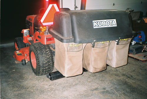

Unless you are mowing a huge area, the baggers don't have to be emptied too often. In the peak season I empy my bags 2-3x while mowing 2 acres. I like the exercise.
Installing / removing bagger isn't bad on a level concrete surface.
In the U.S., the only Kubota bagger that dumps from the driver seat is the direct shoot system on their riding mowers.
Or you could do what this goofy SOB does:
YouTube - Lawn Tractor Leaf Bag-Chute Adapter Kit
