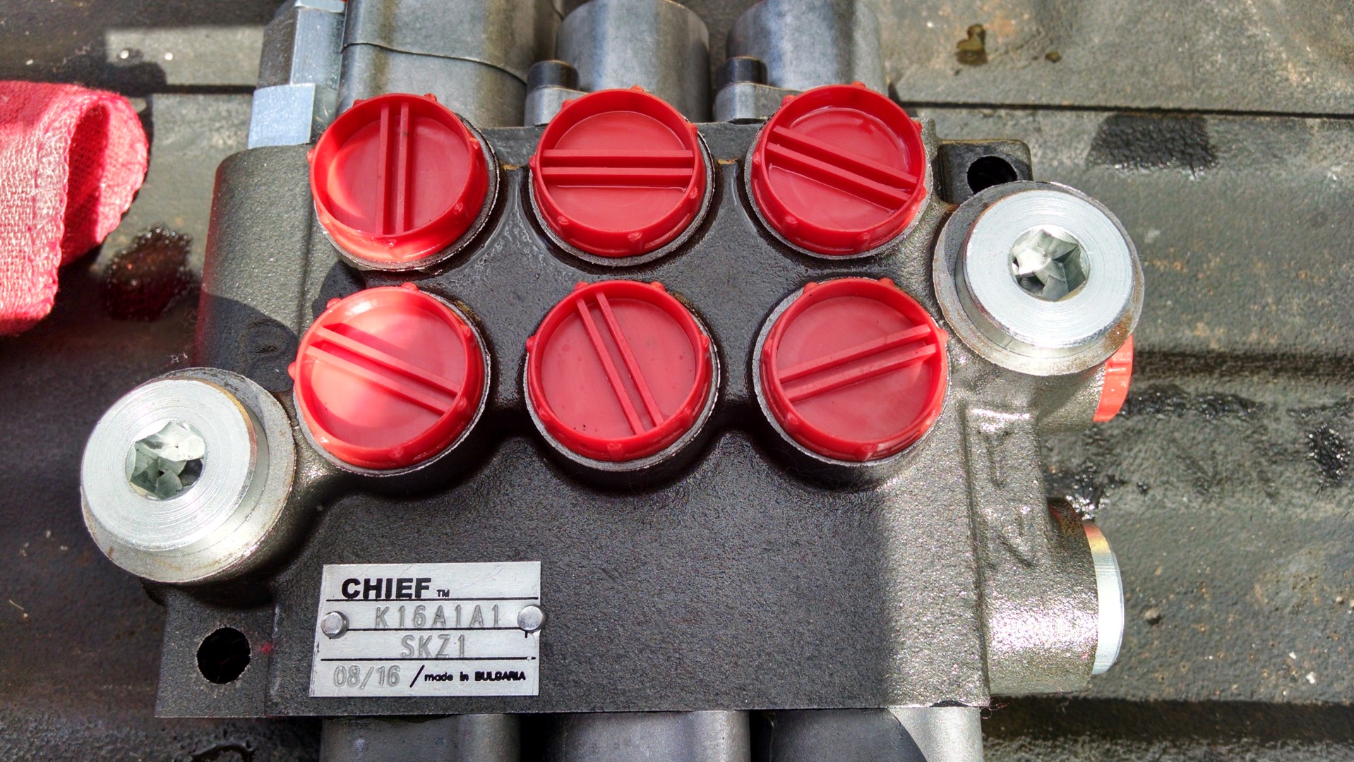

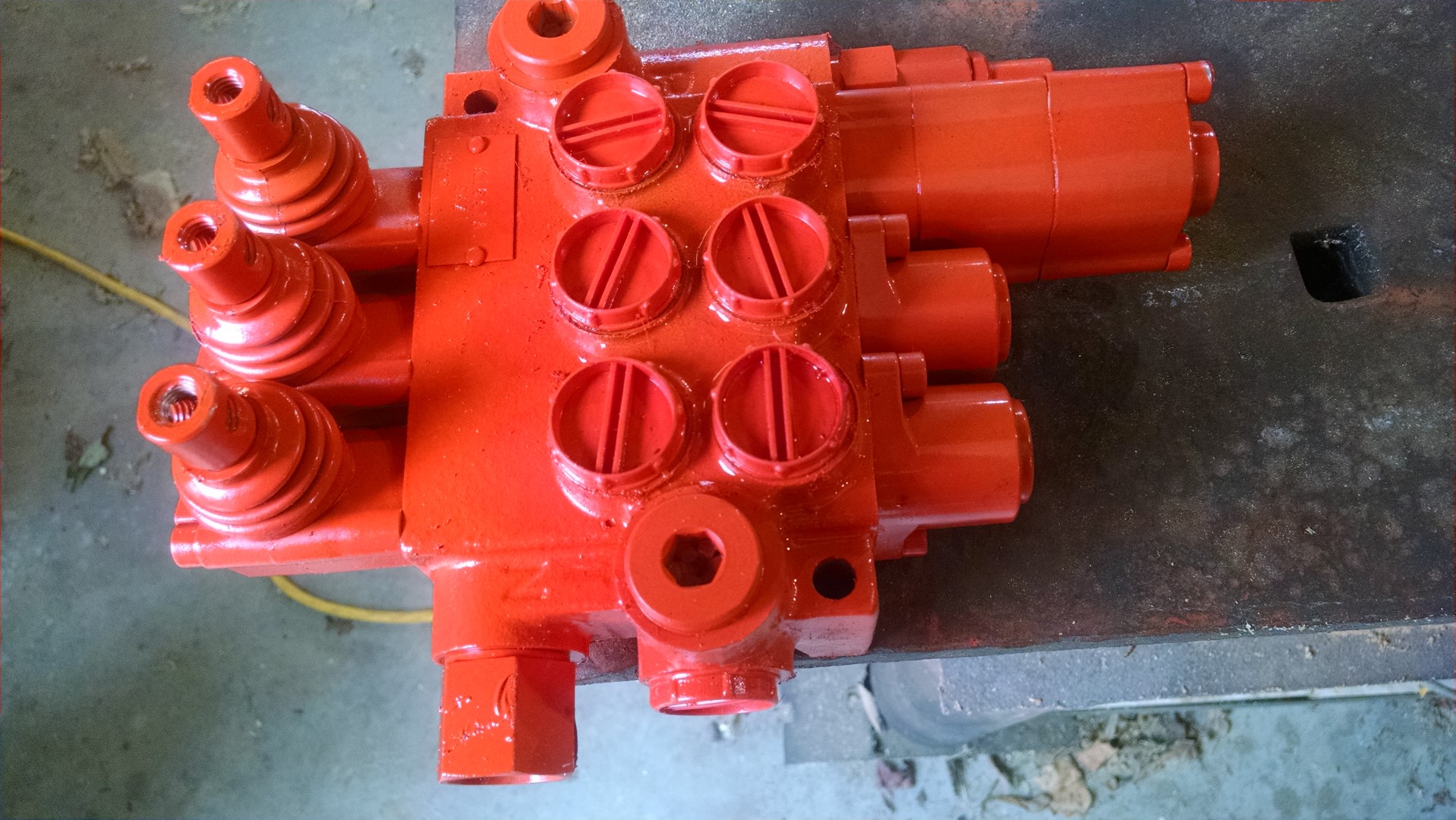

On the left in the picture......the top 90* fitting is coming out of the PB plug. The bottom one is the Tank line.....and you can see that around on the face is a hex plug right beside that tank port. That plug can be put in the side and you can use the port on the face for tank if you wish

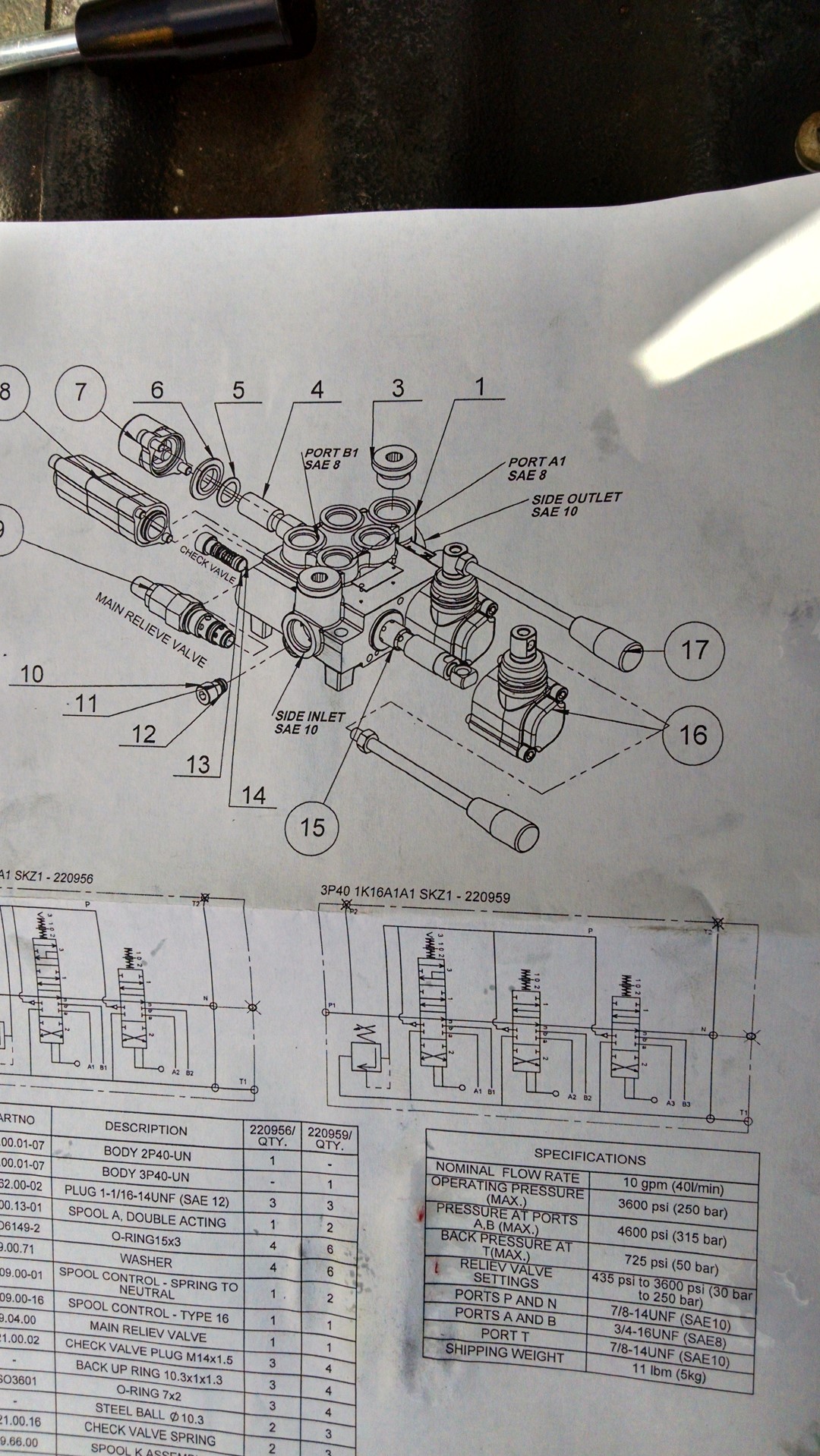

I would *assume* P T N means P=pump T=Tank N=Next (power beyoNd)
But I would confirm that by hooking up an air supply to the P port and operating the valves and watching what happens when they are operated.
You're exactly right. After looking more at the parts sheet that came with the valve, there is a diagram with world's smallest font size identifying the three ports. You can see that the flow through the valve and the ports identified.
It''s hard to see in this pic, but it's the diagram on the right center of the page. The left center is "P", the right center is "N" and the lower right is "T". The upper left and upper right are the plugged "P" and "T" ports discussed by LD above.

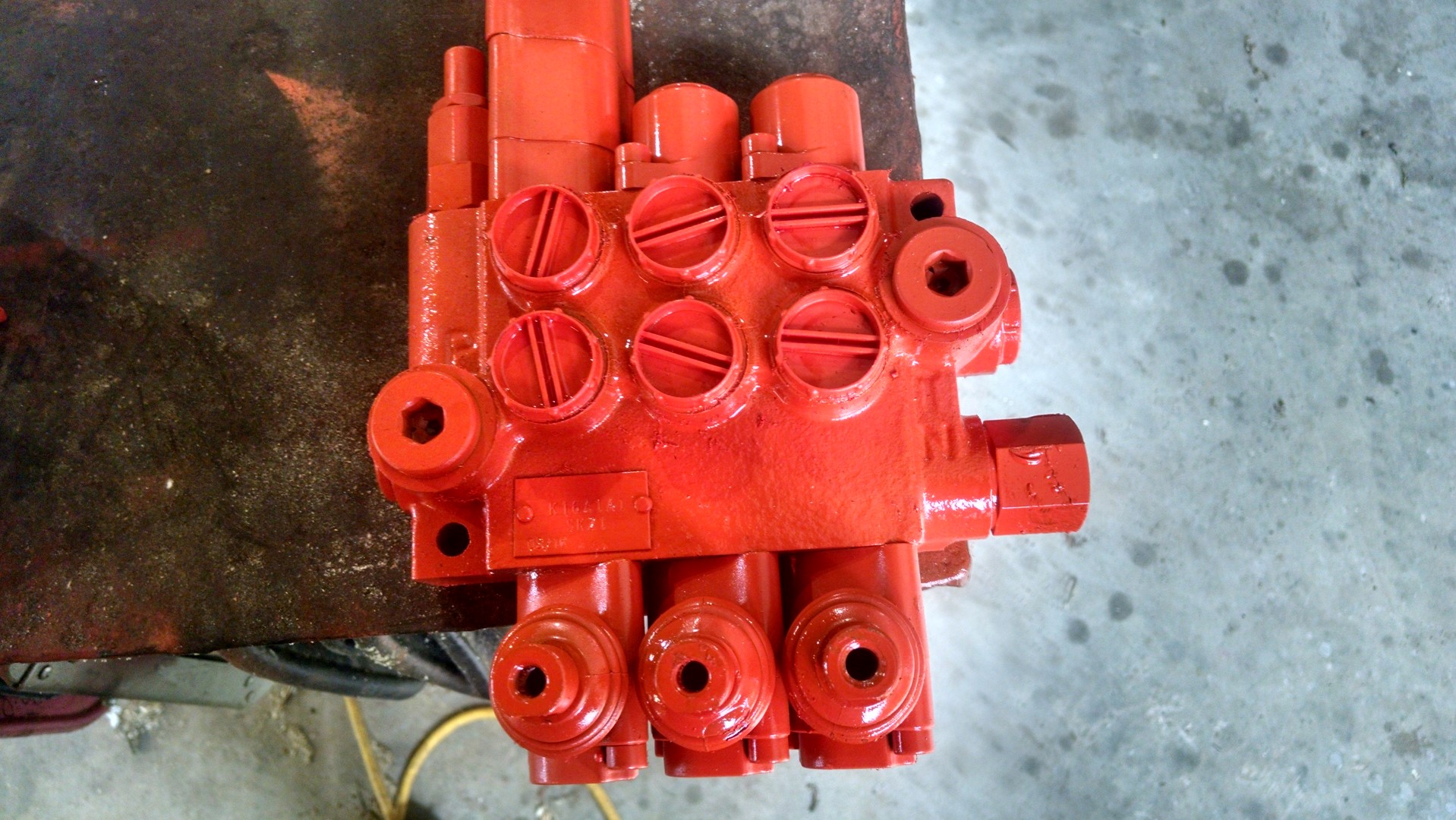

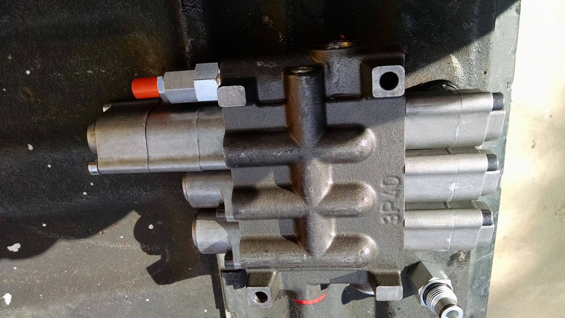

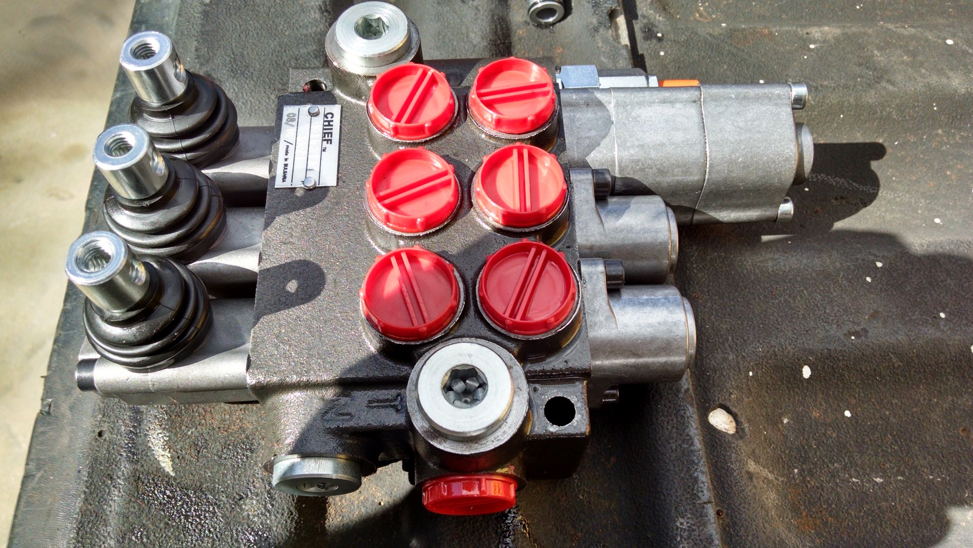

Pics of the valve.
You can see the ports marked "P", "T", and "N" in the upper side of the valve. The valve has now been painted but I don't have pics of it yet.

I didnt noticce those on mone.
Yep, N is where the PB plug goes, T is the two options (top and side) for the tank line....same with P for pressure line

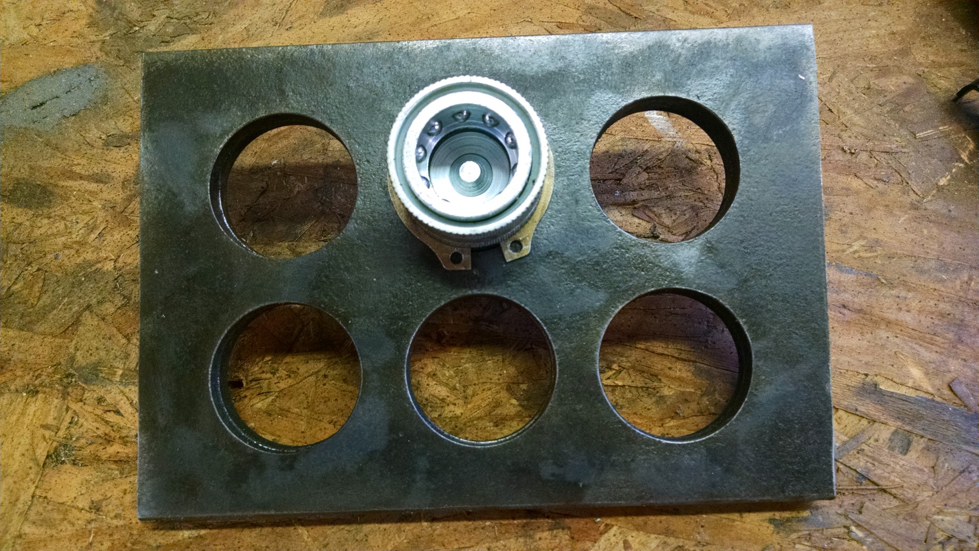

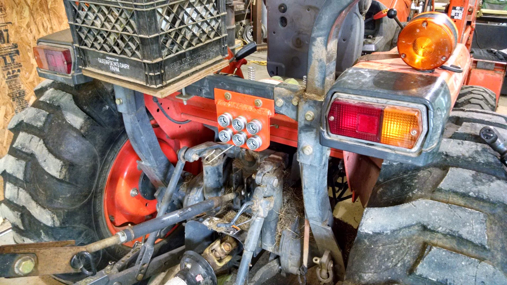

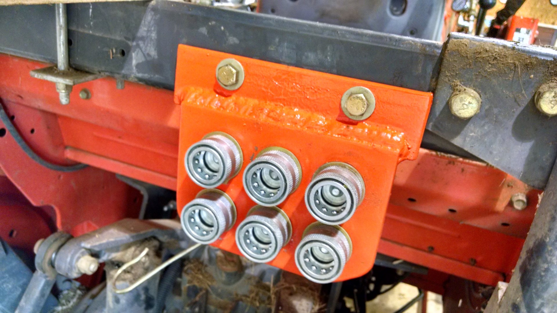

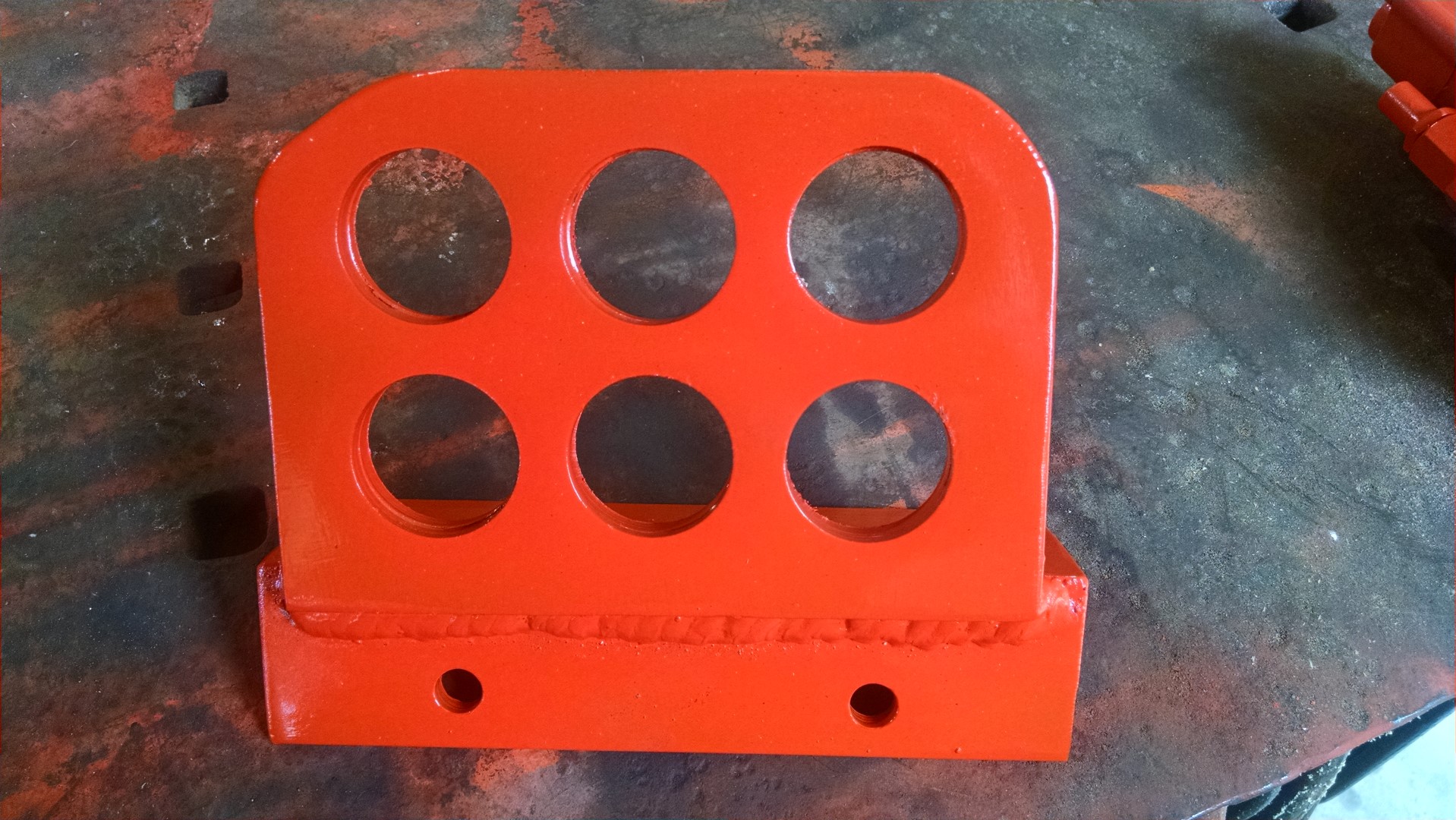

Pics of the Bulkhead Mount for the Ag connectors:
IMG_20160817_132231452 (Large).jpgIMG_20160817_144840157_HDR (Large).jpgIMG_20160817_145058557 (Large).jpgIMG_20160819_121454522 (Large).jpgIMG_20160819_124723216_HDR (Large).jpgIMG_20160819_124729472_HDR (Large).jpg

And pics of the now-painted valve:
   / Thoughts on this grapple from a local dealer? #108
Nice. You decide to make the bulkhead yourself?

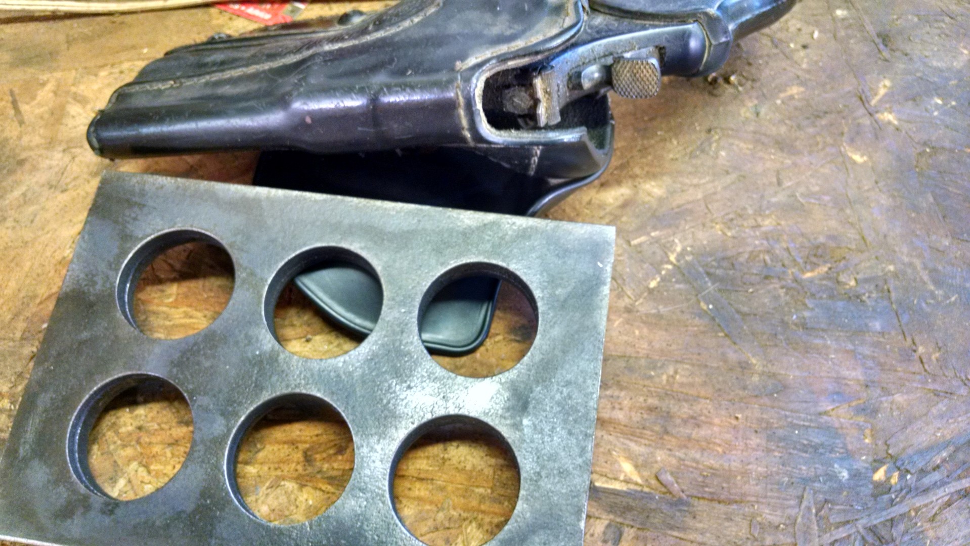

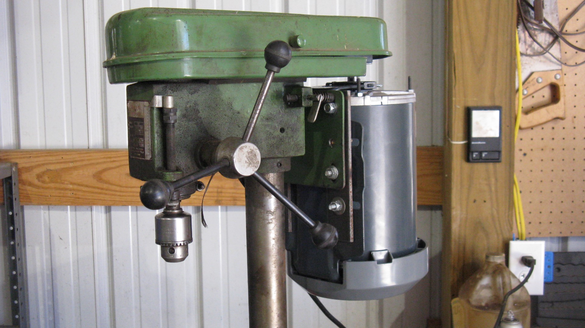

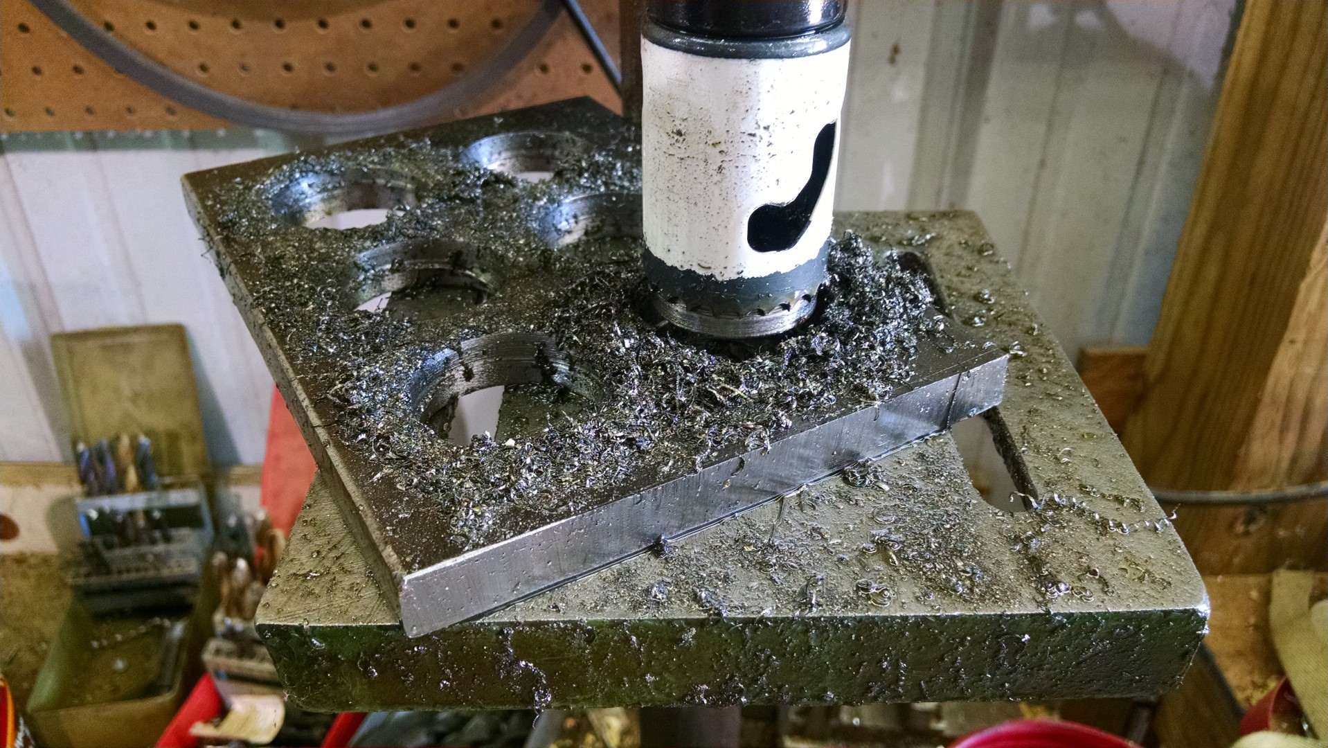

#109
It was decided for me. Worked out alright though. A lot easier to drill the six holes than I thought it would be. Good thing I upgraded my old Central Machinery drill press years ago with a real 1/2 hp motor though.
