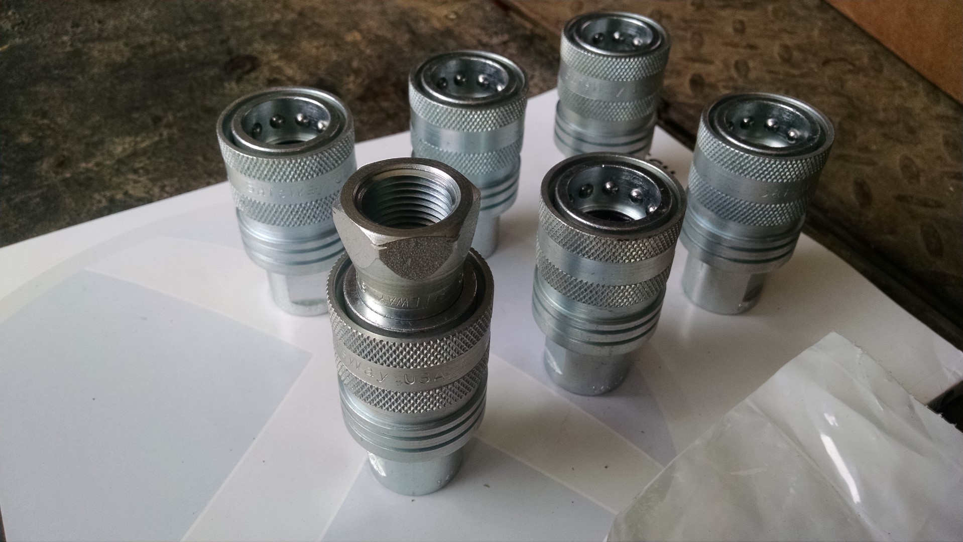

Ok, time for some pics!
Do these look pretty or what?
Plus 25 1.5" snap rings:
Bulkhead thickness measurement, right around .297":
And body diameter measurement, right at 1.489":
Oh and I did the LD *connector-in-the-vise* trick and it worked beautifully! Simply push the male connector in, snaps right in! Pull the male connector out, disconnects easily! Two way connectors are the bomb!
Hope you enjoy!
Thanks,

You forgot a 4 in that body diameter.
I thought you got the wrong couplers, but then looked at the pic. 1.4890
   / Thoughts on this grapple from a local dealer?
#93
Well Cpap!!! Stupid Windows 10 Auto-Connect!!!

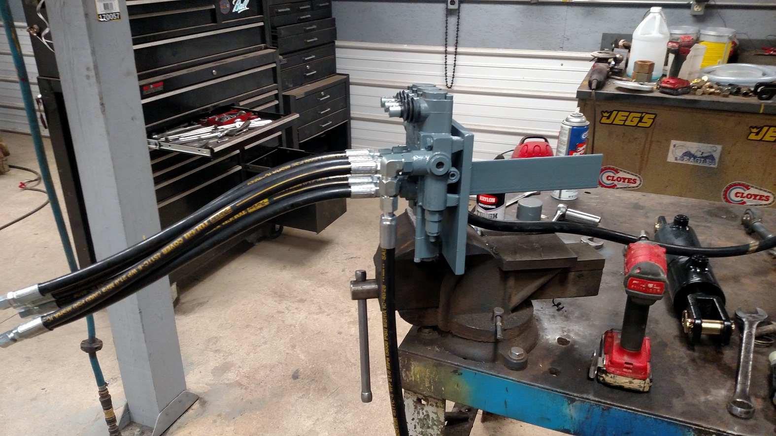

What valve did you get from Baileys? If you got the same chief I did, There is no directions as to where the PB plug goes, but there is only 1 port it fits in. And I didn't mention it in my thread, but the PB plug was just a hair too long. When torqued in, it bound up the one spool on that side. No big deal, just shaved .010" off on the lathe. But could have easily been done with a file, grinder, belt sander etc. So just something to keep an eye out for. Same with any valve really, once all your ORB port adapters are installed, make sure all spools still operate smoothly. Which is why I install the fittings on the bench before mounting everything
Ld, looking at all your valve pics, this looks like the only one that showed the PB plug. Is the PB plug installed on the port that is right next to the #1 spool that has the float? See your pic from the other thread below.

Ld, looking at all your valve pics, this looks like the only one that *appears* to show the PB plug. Is it the port that is right next to the #1 spool that has the float? See your pic from the other thread below.
BTW, the valve has three ports marked "P", "T" and "N". I *assume* the "P" means Power Beyond and "T" means Tank. What does "N" mean and what is it used for? The diagram that came with the valve doesn't say anything about the three ports that I could see.

I would *assume* P T N means P=pump T=Tank N=Next (power beyoNd)
But I would confirm that by hooking up an air supply to the P port and operating the valves and watching what happens when they are operated.
   / Thoughts on this grapple from a local dealer? #100
That picture dont show the plug.
that side of the valve is for pressure in. The plug on the side that you can see can simply be removed, and you can use THAT spot for pressure IN. and use the plug to plug the top hole where I have the pressure in hose currently.
The PB blug really isnt a "plug" rather something that looks like an adapter.
On the 3rd spool side of the valve.....there will be 3 ports/plugs. Any three can be used for tank if not using PB and the other two simply plugged.
If you want PB, the plug goes in one of the side ports, NOT the one on the face. And if you look down inside the port......there is only one place it will go. But I dont remember which one that was. And dont recall seeing P T N marks on my valve.
As James said, you can air test if in doubt. Put air at P, and it should come out T.......or out a work port if moving a lever.
With the PB plug installed, with air P there should never be air coming out of T......only PB.
And if operating a lever.......One of the work ports should open to T (to return fluid coming out of cylinder). Other work port would be connected to P
