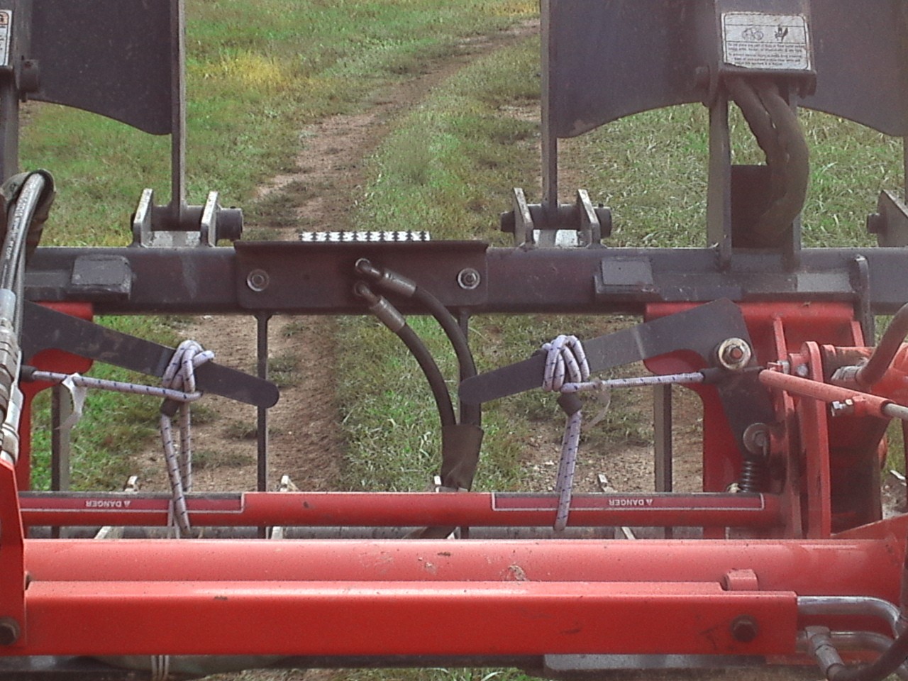

I would be worried about stuff pushing up as you close the arms and hitting a fitting. Since that is a good price, you may want to have someone weld plates to the bottom of the arms if you get one. I own two grapples, a 62" and a 72", I like the 62" best and use it the most on my L45 TLB. The 72" eats too much lift capacity and the extra width is not needed for 95% of the jobs grapples are used.
You may never need the shielding around the cylinders but my experience made me happy I purchased a grapple with shielded cylinders. On double cylinders grapples, one side almost always clamps down before the other starts to move, as I was picking up several 6-12" logs in a pile, one rolled down on top of the of the closed side and as the open side clamped down on the log, it smashed the guard on the the other side. Did not hurt the cylinder but the guard was toast. Called the vendor and they sent me one for the cost of shipping. I purchased my 72" from these guys...Skid Steer Root Grapple but picked up the 62" at a auction for a good price after I bought the 72".
BTW- see my picture, lots of folks have tweaked their QA on their loaders when a QA latch gets hit by brush and opens on one side with out being noticed until it is too late.

If it was me I would get the 60 inch. I have a 50 inch and have not wanted for more width. I have wanted less width several times. I have seen lots of arguments here about widths. Everyone has their ideas. Also their own uses and needs.

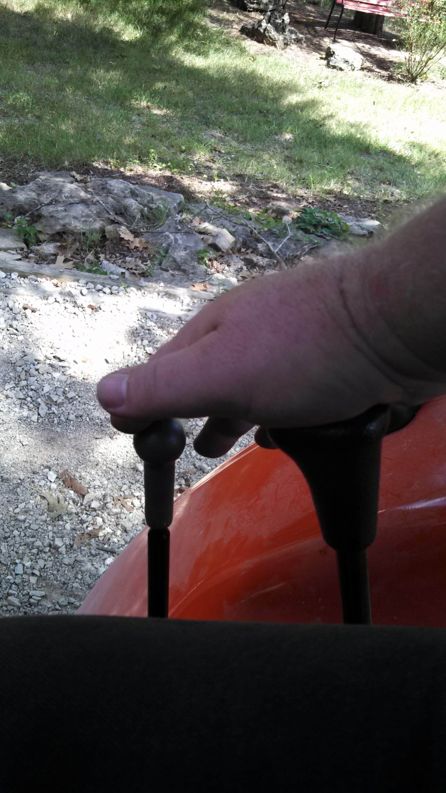

On my grapple install, I used an existing rear remote, so I had about $150 in the complete install. The remote on the Kioti is very handy near the main joystick, so I don't feel I have lost a thing.. But if I did not have a handy to operate remote I would be looking at a diverter setup. But that is my preference. Others will differ and say the only way to go is 3rd function. I have never felt hampered by operating another lever next to my loader joystick. But maybe your work would differ.
