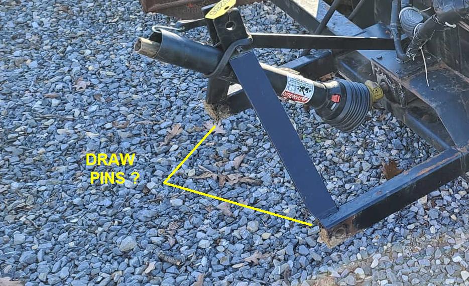

Geez maybe I can't see but where are the 3 point pins for picking up snow blower?
DevilDog
   / Thoughts/Opinions on a Used Blower #19
DevilDog
Good eye ! pins appear to have been "borrowed". Common $7 part - example here.
