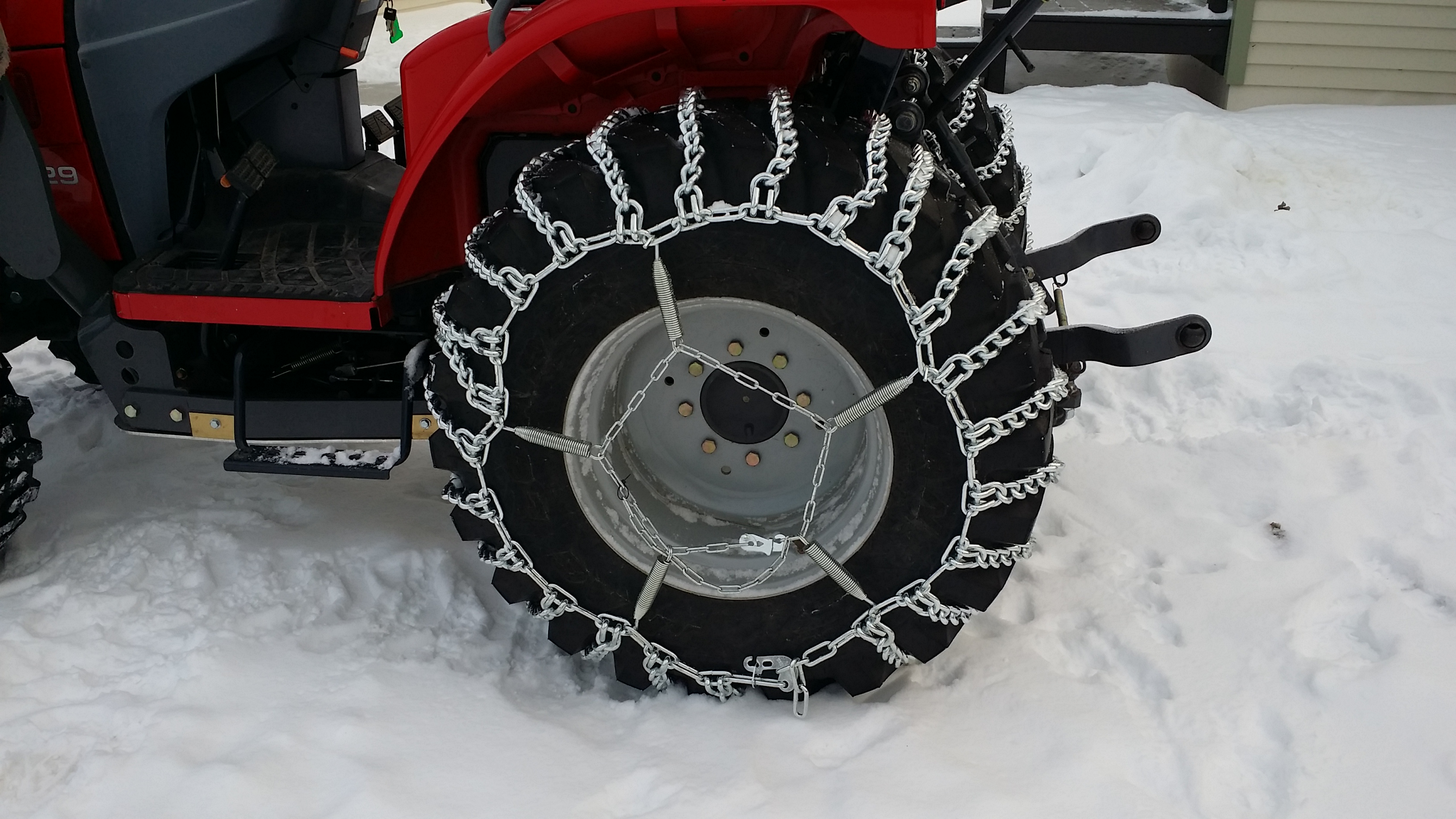

"Ah shucks!" (That, in no way comes close to what I want to say!) With 2-1/2 feet of snow to deal with, neither the Chevy/Plow nor the MF1529 had a chance, in dealing with it! Both are stuck in the middle of the driveway ... helpless! I can't even tell where the driveway "used to be"! The Massey would do much better, with chains! Tractor rubber on snow, "Is like a hog on ice!" It definitely needs chains, especially with R4s.... and from my experience, Ag tires are NOT much better. .. especially in reverse.
Tomorrow, is another day. I'll wade to the two and swamp them with coal ash! The 6 hours I spent today, was enough!
   / Thread for MF 1529 #80
The 1529 enjoys having a set of chains. I put a set on the rear tires and it made a notable difference for me here in northern Minnesota this winter.
