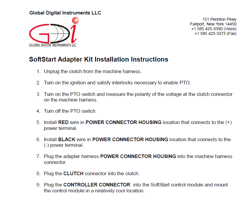

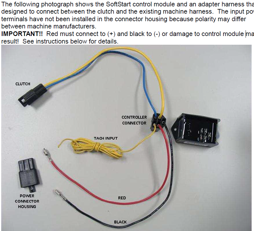

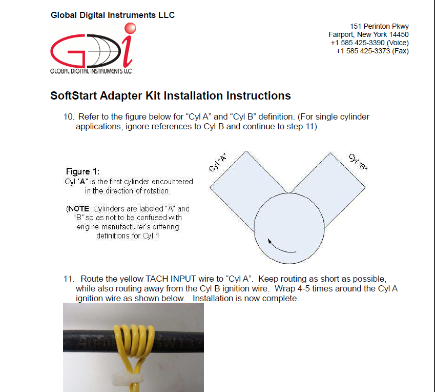

The more I learn, the "less intimidating" it looks! Here is a much better explanation of what needs to be done. I'll try to further enlighten, as I get into it.
The instructions, seem to indicate, that you simply find the clutch connector, separate it, insert the factory installed plug into the clutch end of the harness, verify which is the +12 volt wire on the tractor side and insert the red wire into the corresponding slot in the empty plug and then the black wire into the other empty slot in the plug, which will then plug into the tractor side of the harness. The yellow tach wire is optional. The attached diagram shows the tach wire wrapped around a spark plug wire for a gas engine, while diesel, would have it going to the alternator "tach output". Also, if you accidentally get the "slide in contact" in the wrong slot, they can be removed, by inserting a small, flat tool and depressing the little bit, which holds them in place.
