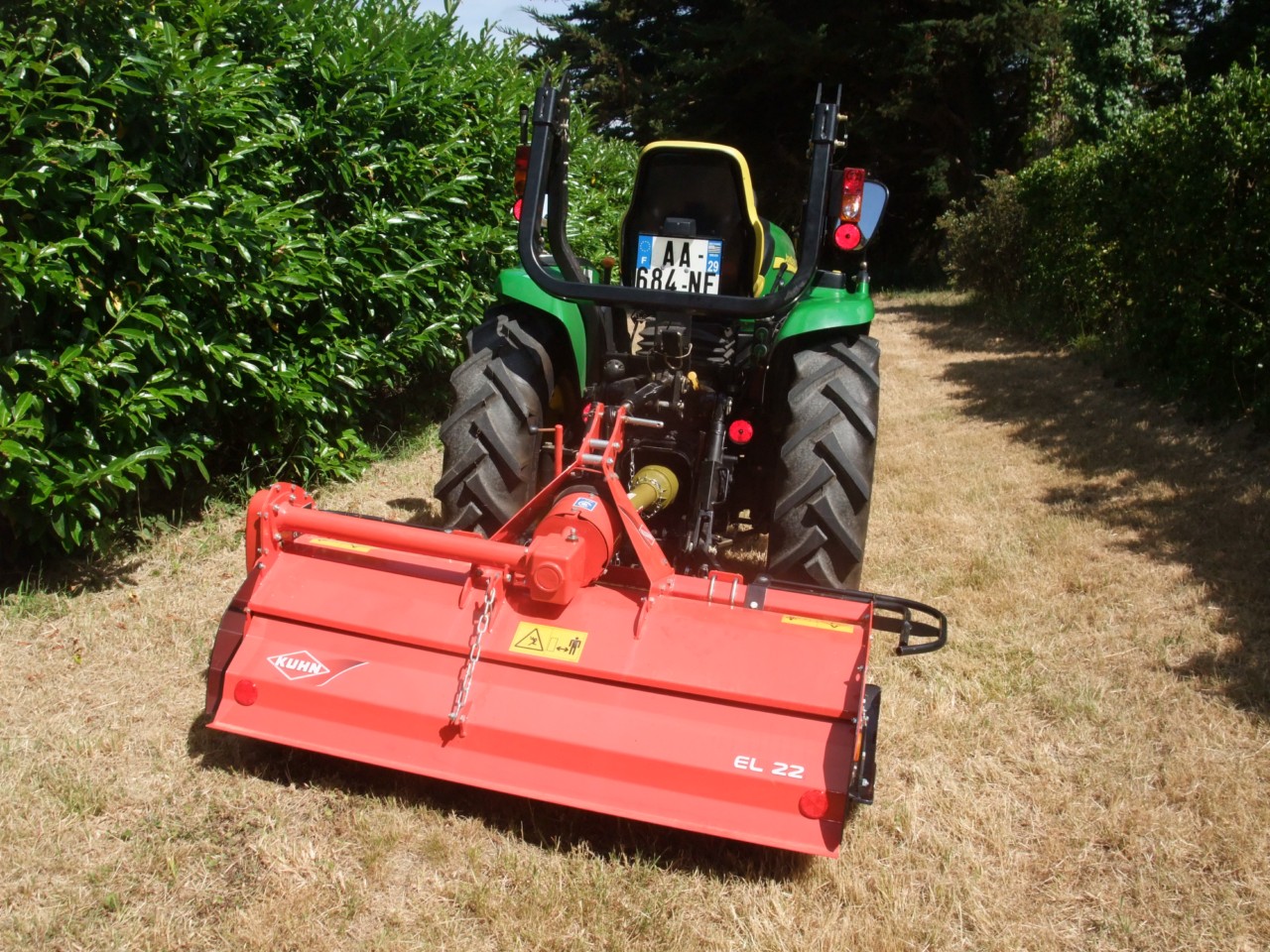

Why not a light-weight unit that will be easier to handle and store ?
