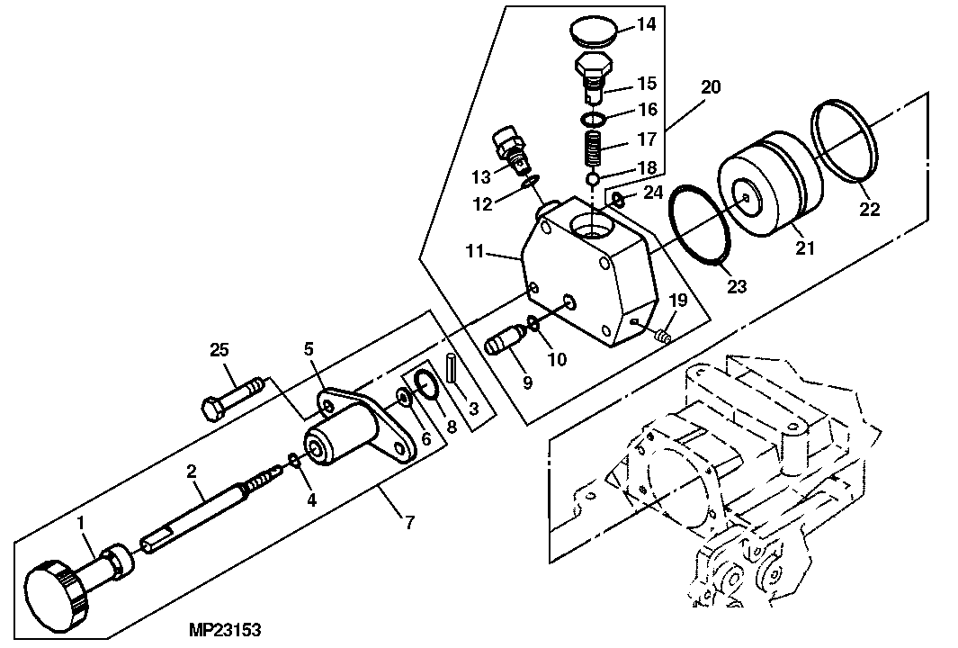

I put the finish mower on it today and it works great coming up - but, when selector put in down position, it does not lower, but rather bleeds down over a period of an hour or so.
I have spun the speed of lift selector valve in and out many, many times and have left it in the position where is would move up and down fastest.
So, given this - should I remove and clean the speed of lift/lower valve first, then move to the up/down selector valve?
/ Three Point Hitch Will not Lower #10
Yes, I would remove the ROD valve. Part #9 is the "valve" that could be sticking.
#11
Thanks, kennyd ...
Any tips on removal - best way to access, etc?
Pull the relief valve first?
How much fluid should I plan on losing?
Need to replace any orings or just check everything well?
Thanks!!
/ Three Point Hitch Will not Lower #12
Remove the 2 #25 bolts. Very little if any fluid will be lost.

kennyd,
I saw another like model experience you consulted on at: http://www.tractorbynet.com/forums/hydraulics/129194-jd4300-3-point-hitch-wont.html
Seems pretty straightforward - I'll give it a shot and see what happens - probably won't get to it for a day or two , though.

Would like to update with substantive news, but I have been unable to get the left hand bolt out!
I do a LOT of automotive mechanic'ing, but this one is driving me nuts - may end up having to remove all the linkages to even get to the bolt head. I stripped the head using the correct size socket! I used at least 100 pound feet and it didn't budge prior to stripping.
Can even get vice grips on it ...
More tomorrow .... aarrrrghhh.
