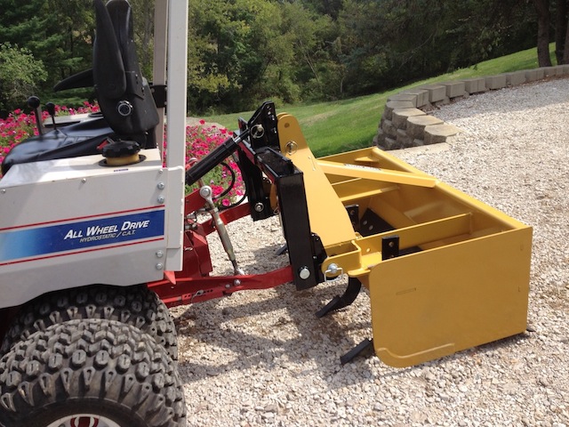

can anyone give me an idea as to cost of three point hitch for steiner or ventrac? does anyone use them to pull small disc harrows or blades? thanks

Ventrac 4500 3pt hitch kit plus hydraulic valve kit required goes full retail at abut $2500.00 if DYI.

so does that mean that a ventrac or steiner might be able to pull a small harrow or blade? anyone out there had any experience? i mainly ask because i have a gravel driveway that requires scraping, i would love to own the power rake but they are expensive. i would also like to use a harrow to plant food plots for deer.
   / Three point hitch #8
I could have bought a (like new) 3ph a while ago, quite cheap and I turned it down. One, I don't like 3point hitches to begin with and the hydraulic issue was a hassle. It is something of a step backwards on a steiner if you ask me.
The Steiner has impressive pulling power for the size of machine.
I was contemplating building a long grader frame out front with a salvaged 3ph blade for playing on my driveway. I am just a little bit leary about eating the dust.

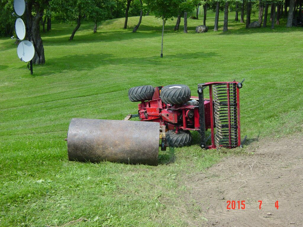

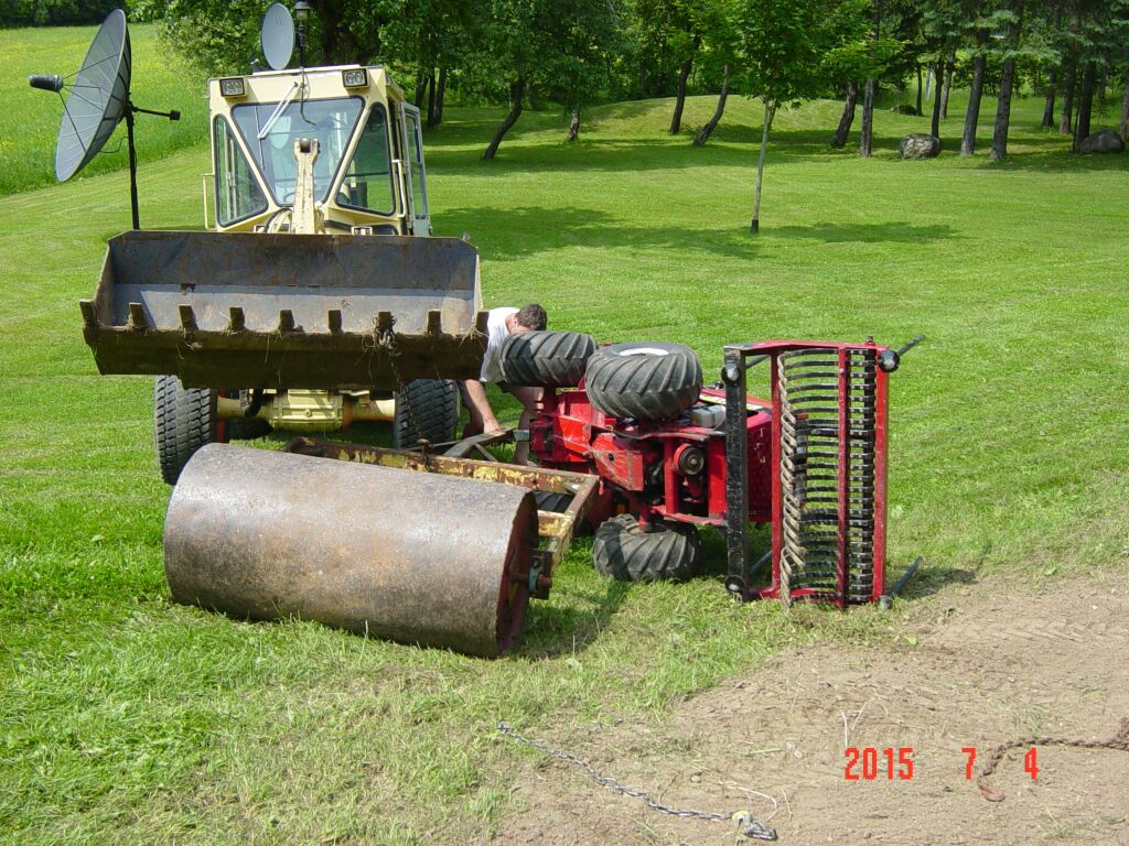

I am trying to find the power rake as well, even though I have a big one (Harley PRO 8). Yes, they are pricey and hard to find.
This stone filled roller weighs a lot and is probably a bit much for the machine. I was rolling grass seed and turned coming out of a hill just a little too soon. It pushed the machine out from under me. My first tractor rollover (kind of) ever.
