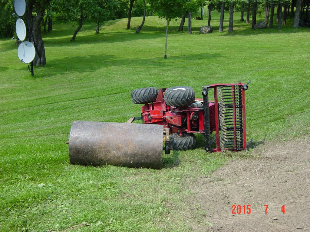

This stone filled roller weighs a lot and is probably a bit much for the machine. I was rolling grass seed and turned coming out of a hill just a little too soon. It pushed the machine out from under me. My first tractor rollover (kind of) ever.

Which tractor rolled?

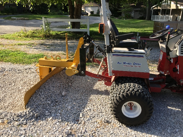

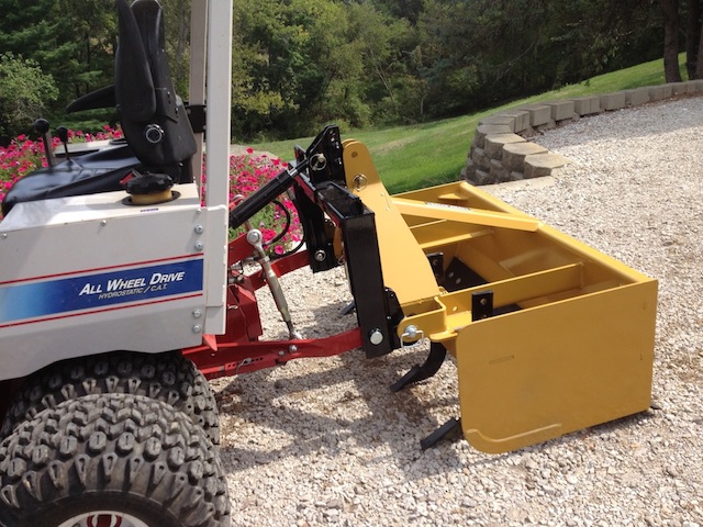

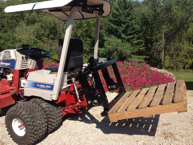

I have a 3-point hitch on my Ventrac 4500Z and several 3-point implememts. The most useful are those designed for carrying and lifting applications such as the pallet forks as compared to draft applications such as box blades and scraper blades. The most fundamental issue is that the tractor is built so low to the ground for stability when mowing on slopes that the 3-point hitch arms are only about a foot off the ground when horizontal in the normal working position for draft applications. Most 3-point box blades, scraper blades, plows, disks, and cultivators are designed for much higher hitch points. So even though it is possible to attach them by adjusting the lift links, the result is the implements cannot be lifted very high for transport. Often this can be overcome by using a hydraulic top link. I do use an EA 4 foot box blade and an EA 6 foot rear blade, but they only work because of the hydraulic top link to tilt the implements for adequate ground clerance. The tractor has no difficulty handling these implements.

Not sure why the first picture disappeared.

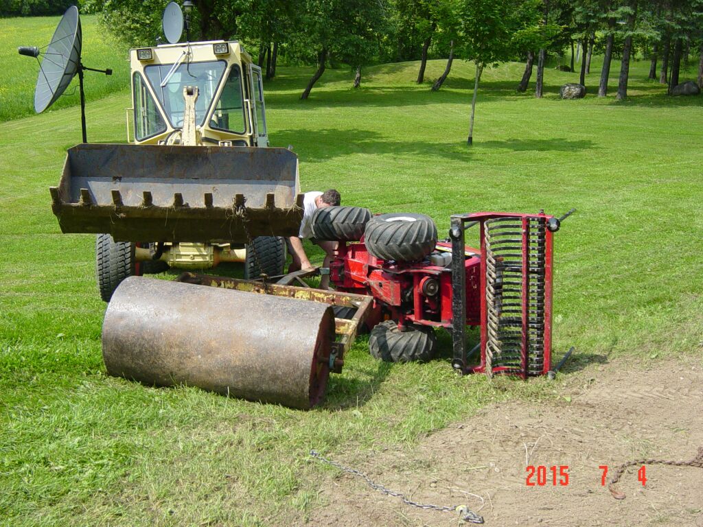

Ouch. How did you get it upright? Any damage to the tractor? Did you have to remove fluid from the combustion chambers?

Industrial Toys, I reckon we are safe to assume that roller is full of ballast.

Investigators say "Speed Was A Factor"
I have duals and should have used them. Never even crossed my mind. For the steepest sections, I was backing up the hill.
/ Three point hitch #20
The tool box got slightly bent and I have yet to figure out a way to make it near perfect. How does one take take out a crease?
I uprighted the machine and let it sit for a while. Then disconnected the fuel solenoid and cranked the engine to make sure it did not have a hydraulic lock. No harm done.
