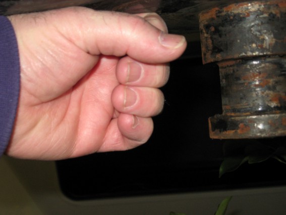

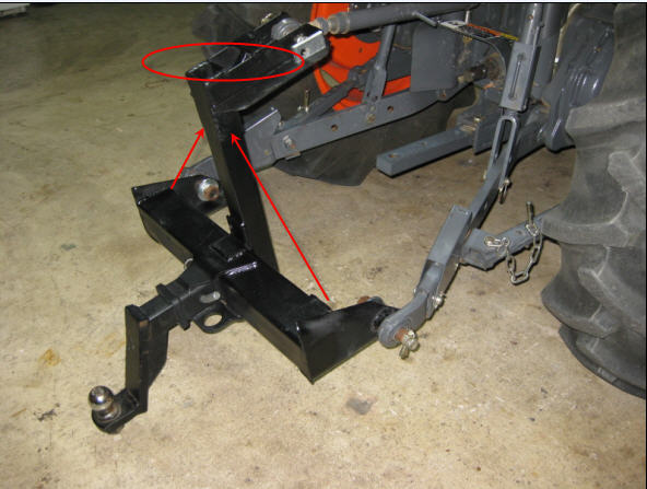

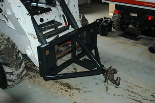

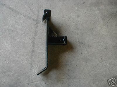

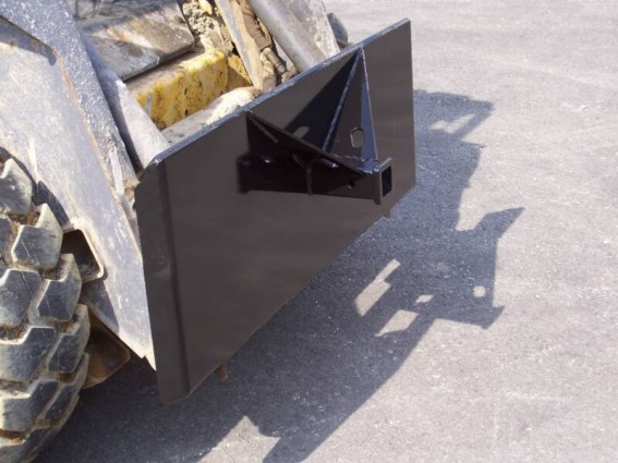

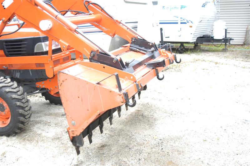

I move my trailers around with my loader bucket. Using the front of the tractor you can turn on a dime with superior control. I welded a receiver to the top of my bucket and made a ball mount with an 18" drop. In the case of your fiver a straight bar would probably work.

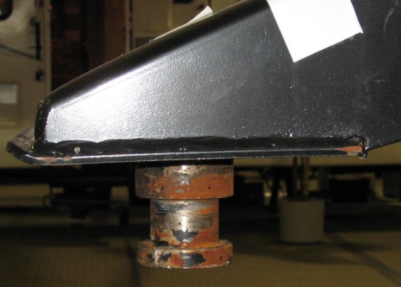

Yes I am thinking about modifying a skid steer quick attach plate with the class 3 trailer hitch receiver for the small trailer and adding a 2 1/2" pipe on the top for the 5er pin. The original pic shows channel with pipe welded in it, the channel I suppose was to spread the loading area but I am not sure that it is required as the pipe against the trailers hitch plate should be enough. The pin goes inside the pipe the edge of the pipe when raised butts into the skid plate on the trailers tongue. Being who I am I will probably make both, lol.

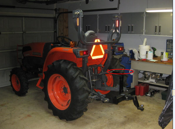

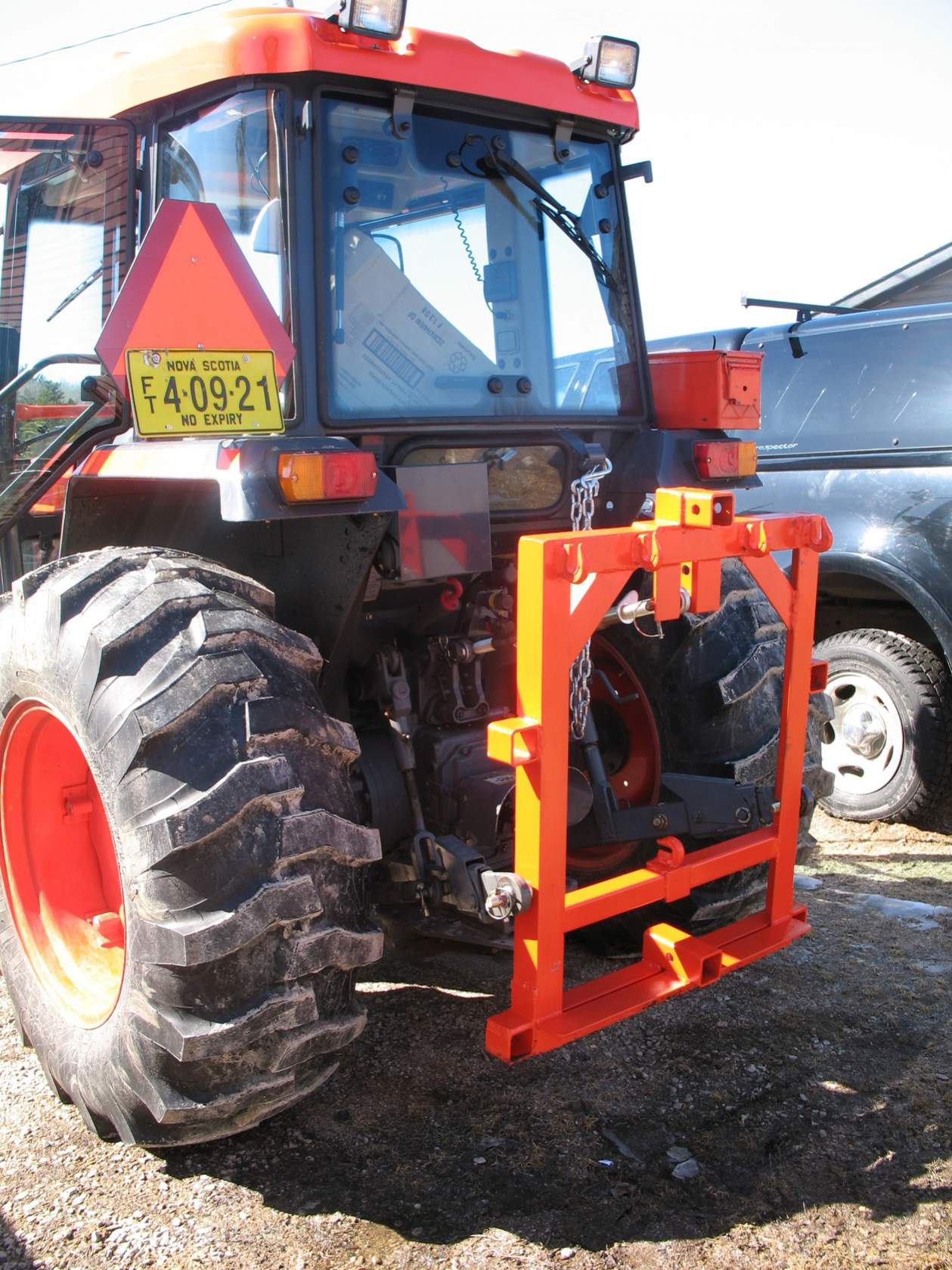

Here are pics of mine with my GN.
Hi clee4020: That is one robust hitch!. I bet you subscribe to the phrase " Go big or go home!":D. That is the way I think too.

You need to put a latch on it. Yes, in all likelyhood the pin weight would keep it there, but what happens if it doesnt? Or when you stop or accelerate with the angle right and it rides out? Best case, you drop it on the landing gear, worst case, you have a runaway trailer. Or, it jumps out of the pipe and the overhang lands on your head.
Go buy a cheap 5th wheel head, should be less than a couple hundred, then attach it to your 3ph frame. Probably find used for less.
Biggest problem will be that the pin on many 5th wheels is far enough under the overhang that you will have trouble getting the tractor back under it far enough and still be able to sit in the seat.

Your trailer and your head. But give some thought to what will happen when it does pop out of there. Because, it will. Just ask Murphy. Do you really want to play chicken with ~10,000 lbs behind you and above you basically unsecured?
Seems foolish to me to take something as heavy and expensive as a 5th wheel and cobble together something insecure by design to save $100. The actual head on my hitch is less than a foot in any direction, not counting the handle. Space isn't an issue. But, like I said, your trailer and safety. Just hope it actually stops when it does pop out of there instead of running over someone.
