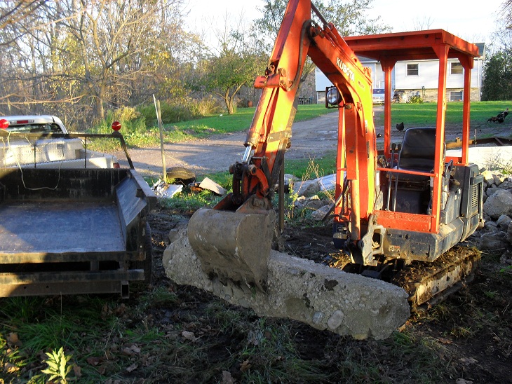

/ Thumb for JD #7 backhoe? #7
I have build a thumb myself. It is not build strong enough my son says :laughing:( he is an professional welder)
This thumb that is bolted on was made to see if it would work. Works great!
If I find some 1/4" steel sheet I wil make a better one.
For now I have done some amazing things with it. Need some practice though:laughing:
Bert
Wow, Love to see some more close up pics of that thumb! looks like exactly what I'm trying to get.

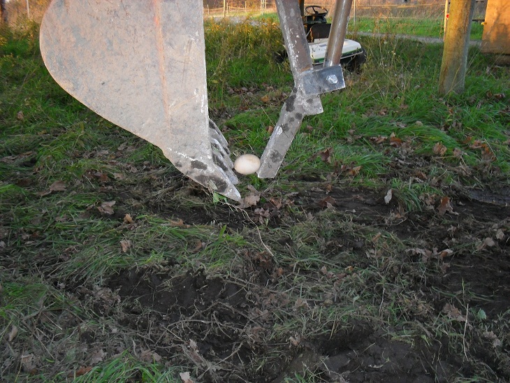

/ Thumb for JD #7 backhoe? #11
Here some more pictures of my thumb. It have built it to see if it would work.
I agree that it is not built strong enough, the welds are starting to crack.
By now I have moved more than 30000 lb concrete, cement blocs and I have used it for logs and other things.
As you can see there is not much room for the bolts between the bracket and the cilinder. I do not want to weld on the boom and I want the thumb to break before some part of the excavator does.
Picture #5 shows what you can do after a lot of practice :laughing:
Bert
