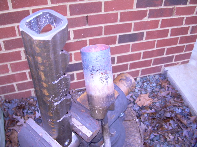

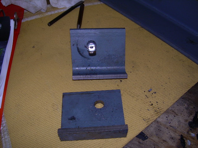

I have attached two more pictues on the thumb parts.

   / Thumb for mini hoe #33
BobRip said:
My biggest problem seems to be that the parts would shift after welding. I would have everything lined up and then weld and it would not be lined up. Does anyone have suggesting to correct this. Maybe I should drill the holes after welding.
I have attached a few more pictures.
Put pins through the holes before welding.
Spot weld everything first.
Only do about an inch of weld on one side at a time so the heat does not deform or move things.
Build a jig and assemble the things in the jig.
Use welding magnets to keep stuff square.
