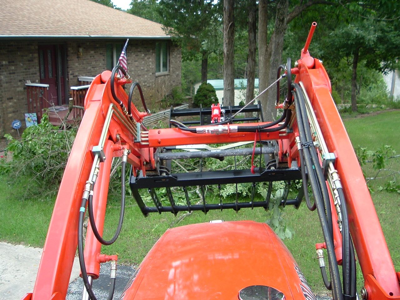

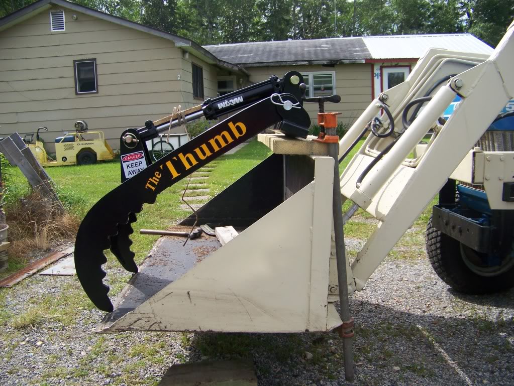

I got my thumb grapple today. I have sitting on the bucket c clamped to 6" of blocking. I have some questions about the install. Does the height look rite for my bucket. I have some 6" angle to sit it on if this looks good. Next question is the hydraulics. The rear remotes have a pic of a cylinder shaft out and shaft in. I'm guessing the hose that's plugged in to shaft out remote goes to the top of the cylinder. Shaft in goes to the port where the cylinder comes out. What is the 3rd port for.
Does anybody have pics of hose routing and mounting. The NH dealer said I needed 16' feet of hose. I measured it at 20'. When I was playing with routing the hose it looks like I'm 4' short, especially for the bottom hose. It really takes up the hose when I curl down.
The first pic is the 3 ports on the cylinder. Second one is the diagram at the remotes. Third is the grapple waiting for approval. Thanks for any advice. This is my first hydraulic project.

I'm not going to address the hydraulics issue, as that's not one of my strong points. The height of your thumb, OTOH, looks pretty good. I like the tip of the thumb to meet the cutting edge of my bucket. I had some metal risers fabricated to make this happen. I planned it out with wood blocks, just as you're doing.

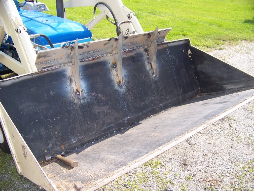

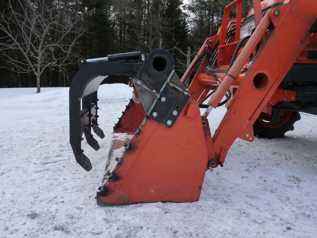

100_0827 (Small).jpg100_0825 (Small).jpgLooks like you should have purchased a shorter version;it can be made to work,you want it to fully close on the bottom of your bucket.With mine I just had to roll an angle iron a couple inches.
You also should make the final connection by bolting on;then it can be removed if needed.

Your shaft out, should go to the bottom of the cyl as that is the extend mode.
Your mounting position looks good.

You want the cylinder fully extended and touching the bottom of the bucket,closes tight.You will find the stroke a little short(doesn't open wide like a full grapple).
At the same time I installed a tooth-bar,the combo works great for brush,logs ect.
Look closer at my first picture in other post.
The only change I made is to replace the front cylinder pin with a bolt,I was forever losing the pins in brush piles.

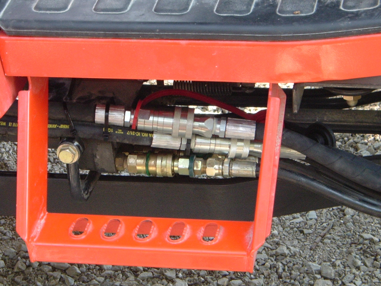

You might need a disconnect at the front so if you want to remove the grapple all you have to do is disconnect 3-4 feet of hose and not the full run to the back of the tractor.

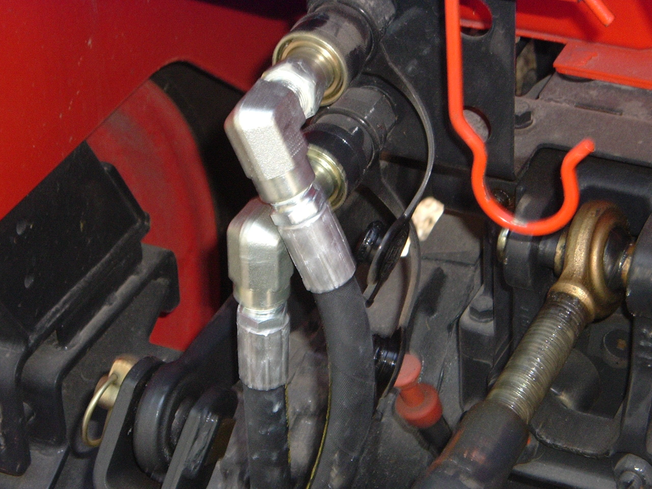

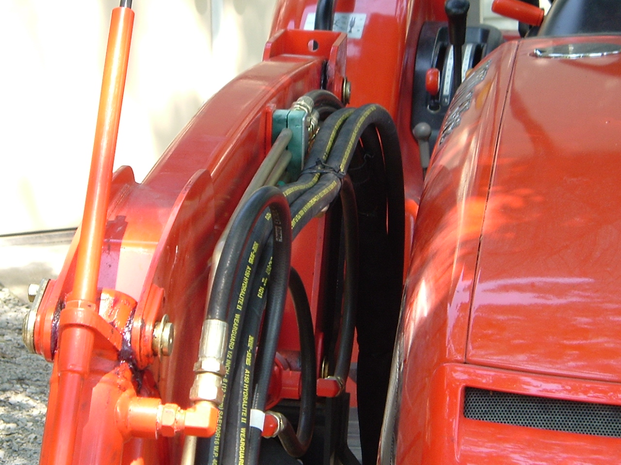

/ Thumb grapple install need help #16
I came off the remotes with 90* fittings. Ran the hoses so they won't touch the 3 pt. lift arms and under the right side of cab where the other hyd. lines run. Went between the HST pedals (you have to be careful here so pedals don't rub on hoses when pushing them) then up the front of cab by the loader hose connections and followed the loader arms to the front. I also used the ready made hose from TSC. I did use 1/2" but 3/8" would work and be easier to run. I originally installed a mount bracket I bought at TSC that holds the hyd fittings but found it too hard to use so removed and let last couple feet of hose hang free. Zip tied every foot or so to keep hoses from moving. The 14' was just enough to get the hose to where you see it on the loader. I also used inline restrictors from GreensMachine at the cylinder end. It can be used without them, just moves faster.

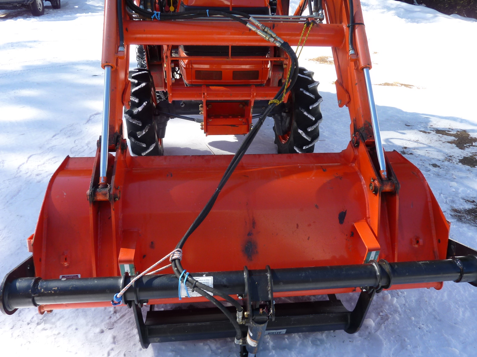

/ Thumb grapple install need help #20
I put a set of QD"s just before the hoses get to the loader tower. Just right where the OEM hoses for the loader connect up. So I have 6 hoses in that location instead of 4. Makes it easy when you want to take your loader completely off. I just use a bungee cord for hose control. it seems to work well. I tie-wrapped one end of the bungee to the hoses mid span, and the other end goes up to a fitting on the loader, an holds everything clear. I used a home made (pieces of metal off of a kubota) bracket welded to the cover that goes over the torque tube. Of course I took it off to weld and paint.:)
