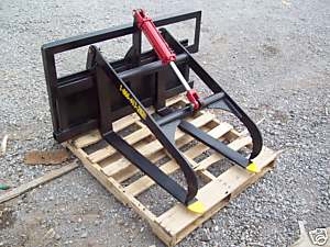

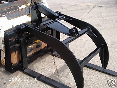

You said fork grapple, so how about something like this?

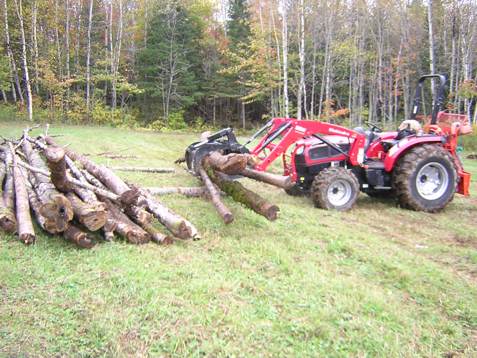

Processor was the wrong word...No I do not have a processor. Mostly Im looking to fell trees and cut them up into 8-10 foot sections. The tractor will come in to move the sections across the property to my area where i cut, split, store, and stack.
For my money, I think you would find a grapple much better than either forks or a backhoe thumb.
I have all three and when I need to move logs, the grapple is the instrument of choice.
Now the safety police will probably get on my case for this, but my grapple will pick up a log and hold it over the bed of a pickup so a second man in the bed of the truck can saw off 16" lengths and have them fall in the truck bed. Drive the truck to the splitter and offload the lengths into the splitter. This minimizes manual lifting, after the grapple lift, the wood is always going down.

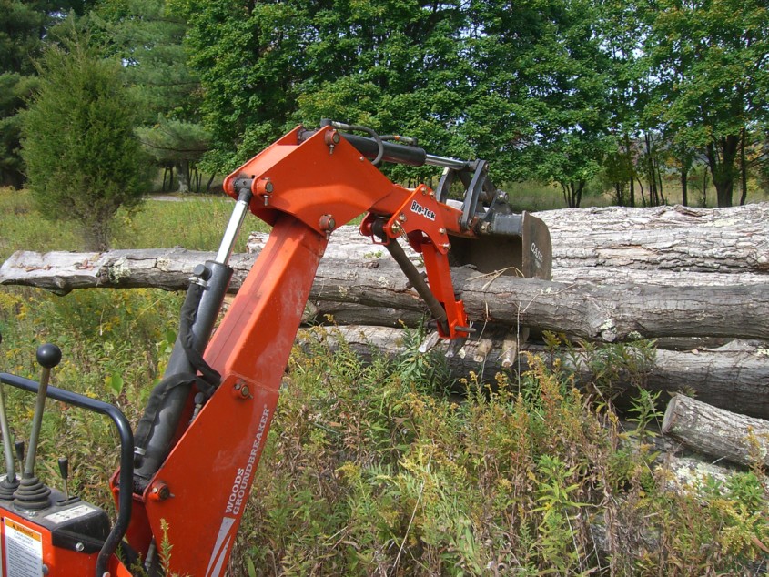

This is what works for me, a Bro-tek thumb on a L 2250 Kubota. For firewood cutting I prefer it over a grapple on the bucket because the front bucket is wide and you are cutting lengths of wood directly over the metal bucket, one slip and there goes the chain. The Bro-tek thumb is every bit as effective as a grapple and costs only about $300. Check out the video on Bro-Tek: Tractor Add Ons.

Thats pretty much what I had envisioned when thinking about a front grapple of some sort. Thanks a lot for all these suggestions and pictures especially. If I luck out and find a decent deal i may just go with a front and rear option so I can do both.
