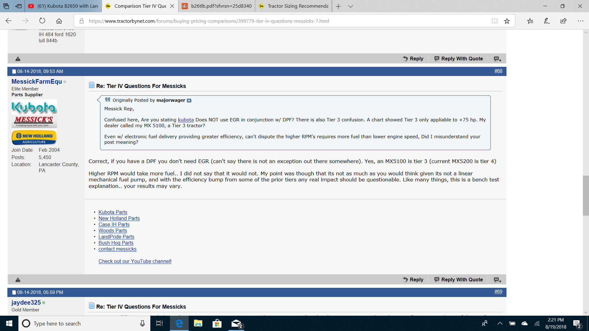

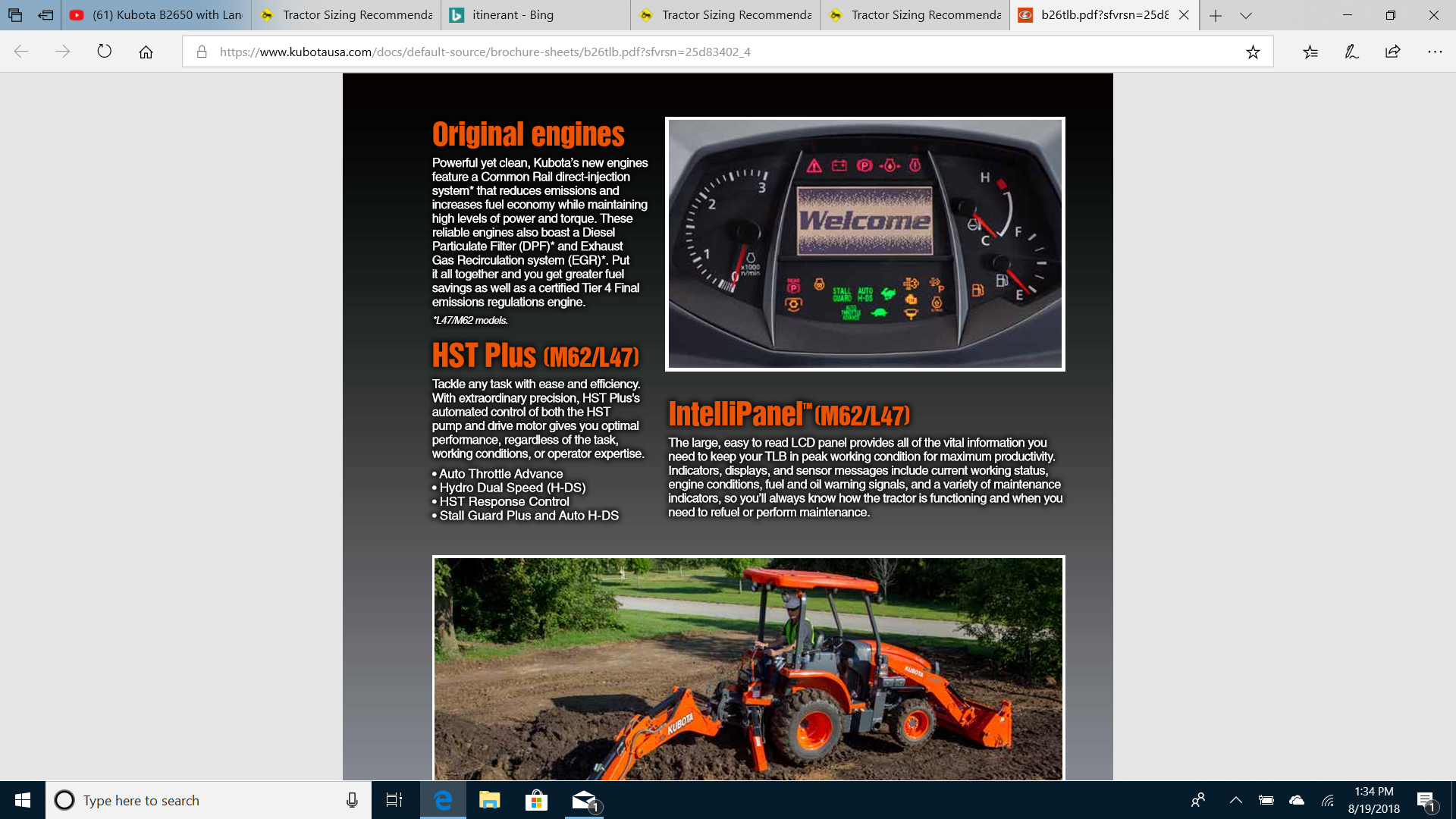

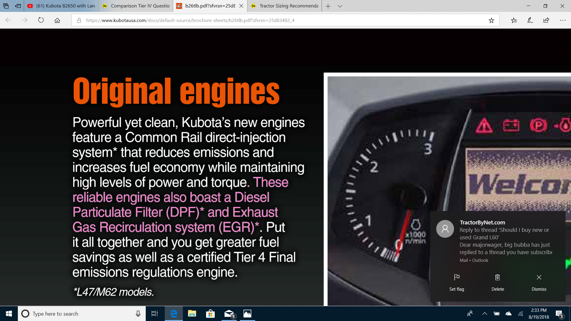

Confused concerning a Messick's post. It was stated that DPF does not require EGR. Yet the Kubota brochure specifically adjoins EGR and DPF. Screenshots below?

They are two different systems. What he is saying is that a manufacturer of diesel engines may be able to design a Tier 4 compliance by just using one of the technologies. Either EGR or DPF. Some require both. Mostly this is true on existing older engine designs where the manufacturer has decided to not spend a gazillion $$ to make a new motor. Such is the case as mentioned about Mahindra designing a new motor recently that does meet the specs with only EGR as it's single method. And Diesel particulates are the "smell" of diesel. Without that you won't even smell like a diesel. Ever sniff closely a new Dodge Ram with the EcoDiesel ? They are pretty clean burning and the exhaust smell especially at idle is pretty darn clean.
Steve

Disagree, tier 4 final is not obtainable through EGR alone. DOC in conjunction w/ EGR is certifiable, or EPA compliant. It was said that Kubota uses DPF alone but Kubota asserts that both DPF and EGR are employed Together.
Interim tier 4 could be achieved using EGR alone as is the case w/ numerous models prior to 2015.

What is your point? EGR alone does NOT meet tier 4 final standards. Mahindra confirms
