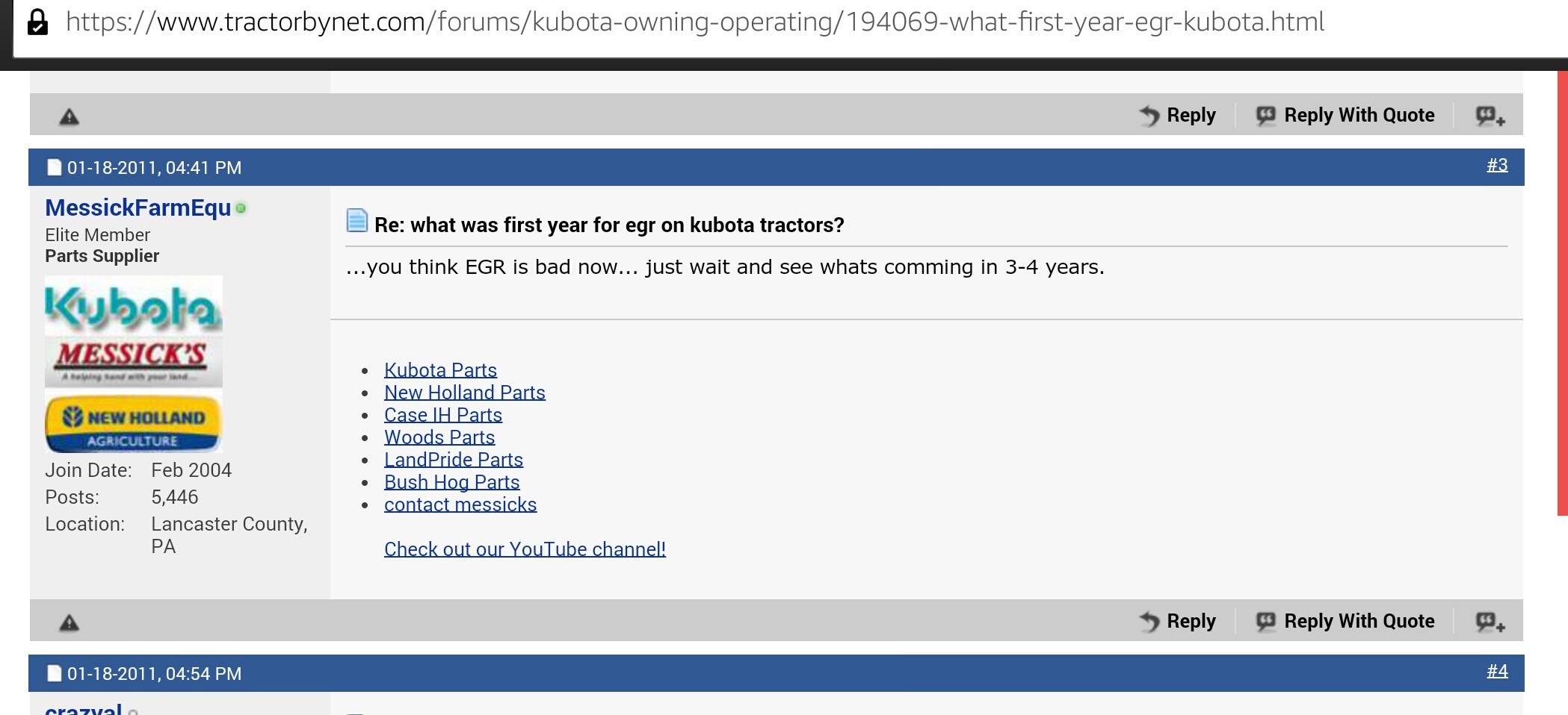

Messick Rep,
Confused here, Are you stating kubota Does NOT use EGR in conjunction w/ DPF? There is also Tier 3 confusion. A chart showed Tier 3 only appliable to +75 hp. My dealer called my MX 5100, a Tier 3 tractor?
Even w/ electronic fuel delivery providing greater efficiency, can't dispute the higher RPM's requires more fuel than lower engine speed, Did I misunderstand your post meaning?

Messick Rep,
Correct, if you have a DPF you don't need EGR (can't say there is not an exception out there somewhere). Yes, an MX5100 is tier 3 (current MX5200 is tier 4)
Higher RPM would take more fuel.. I did not say that it would not. My point was though that its not as much as you would think given its not a linear mechanical fuel pump, and with the efficiency bump from some of the prior tiers any real impact should be questionable. Like many things, this is a bench test explanation.. your results may vary.
