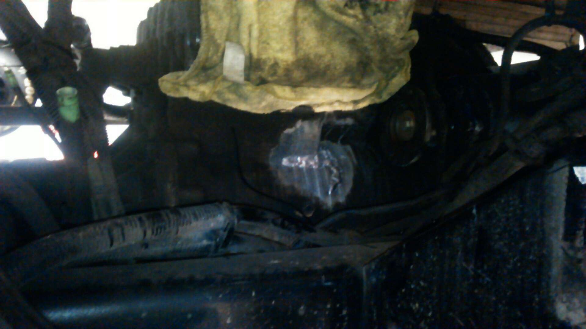

Worst for me is trash trucks, no matter how clean it is the weld will burn some sort of juice which is putrid.
One job I did that i wasn't sure would work but actually did was repair a trans case in a trash truck, pto shaft came lose and smacked the side of the trans cracking it and causing a leak.
Very little access and trans was so covered in gunk, it worked but wasn't fun and not real pretty.
