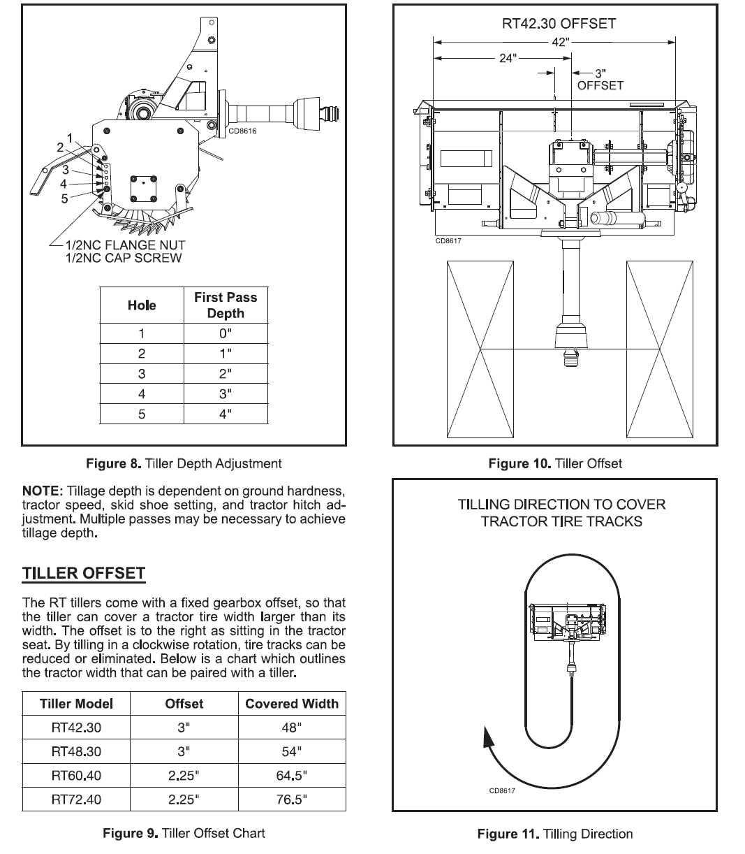

offset can take a few passes to get used to but...we all hit crap when tilling that suddenly puts our machines close to expensive crap. anyone that says otherwise is a liar.
that 3 inch offset protects you.
crank wheel to right pull fwd 1 inch and due to swing you gain a lot clearance on rt side of tiller. straighten front tires back up 6 inches and you are clear of everything.
I will never buy a tiller w/o an offset now.
takes a lot of getting used to though, sometimes seems counterintuitive.
its one thing just tilling your own stuff, gets more important when you pull into a property you have never seen before.
again if unit is captive (never leaves your yard) this don't really matter. my unit is not captive and gets trailered a lot.

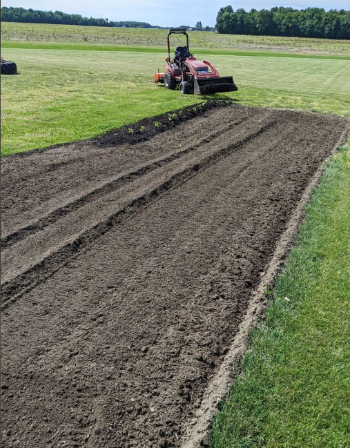

If the tiller width is close to your tire spread, get one that offsets. That way only the last row will have a tire track. And Woods tillers are fantastic. I had one for 22 years before selling it because it was too small for my current tractor.

Just curious, how do you plant your garden without getting footprints in the dirt?

I had a similar answer about tracks. There's a big difference between ~180# me and a ~1600# tractor and how much the dirt will get compacted.

Driving over tilled soil one time will not compact it very much. It's a non-issue. Never had any problems planting where the tire track was.

I have, and with my 4320 which is on par with your MX. No difference that I can tell. Compaction is not a one off. It's not like OMG I have to start all over again.

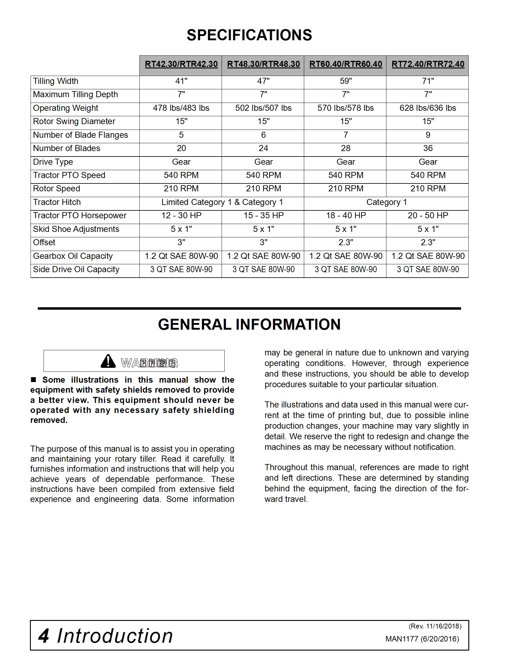

fwiw the woods rt48.30 weighs approx 502 lbs, the rtr48.30 (reverse rotation) is 507 lbs per spec sheet.

Well go for it if it works for you. A lot depends on the clay content of the soil regarding how compactable the soil is and how it affects plant growth.

I'm going to break down this year and buy a tiller.
I'm looking at Woods because it is who makes my blower and what my dealer carries.
Question is, will the GC handle a 60 inch tiller or do I need to go with a 48?
Manufacturer says I should use the 48.
With the spacers on my rear wheels a 48 inch tiller will not completely cover the wheels (~50.5")
I'm assuming that I can use 60 inch - PTO HP is listed as 18-40 RT60.40 – Woods Equipment
PTO HP listed on the 48 is 15-35 RT48.30 – Woods Equipment
GC1725M PTO HP is claimed to be 24.5 so it should be able to run either.
Just want to see if anyone thinks I'm missing something here?
Do you think the 48 will work or should I go with the 60?
just noticed that you saying the PTO HP is 24.5. That doesn't sound right, should be more like 18 or 19 on a 25hp engine. It will still run the 60" tiller, I'm confident in that. If you decide to upsize your tractor at some point you might not need to upsize your tiller too.
Correct, I read the wrong line, PTO HP is 19.6. Another reason not to do with the 60 as the tractor is near the minimum required to run it. If I had been paying more attention I would not have even thought about getting the bigger one.
