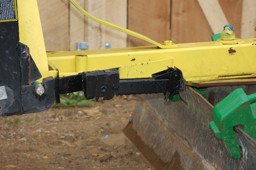

   / Tiller kickstand #14
Here's the stand retracted and folded up.

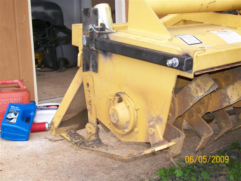

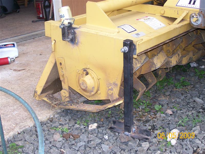

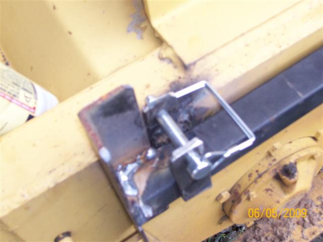

   / Tiller kickstand #15
I'm in the same boat as you, New KK. it likes to "roll" forward when disconnecting. here is my idea:
I'm going to weld a stud (or tap threads) into the rt forward outside of the tiller and mount a 1x1 tubing as the kick stand. When not needed I can pivot it 270 degrees and it will lay in a cradle along the top edge, perhaps with a pit pin to hold it down. May work on it this weekend.. if so I'll post pictures
   / Tiller kickstand #16
Well, this place got me fired up, Dad and I got busy after I got off from work and built the kickstand. Here are the pictures.....

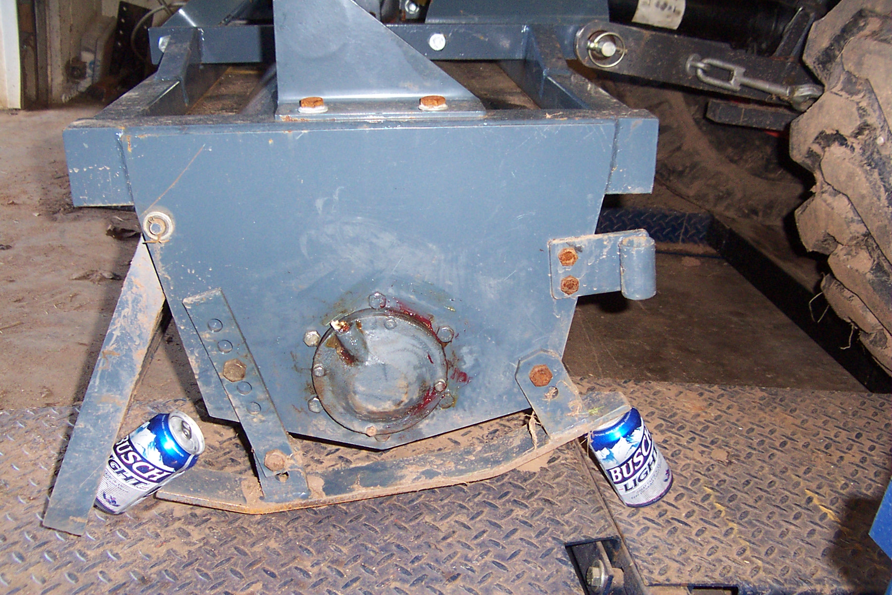

   / Tiller kickstand #19
I do like the beer can ballast.. How well does it work? :D :D
