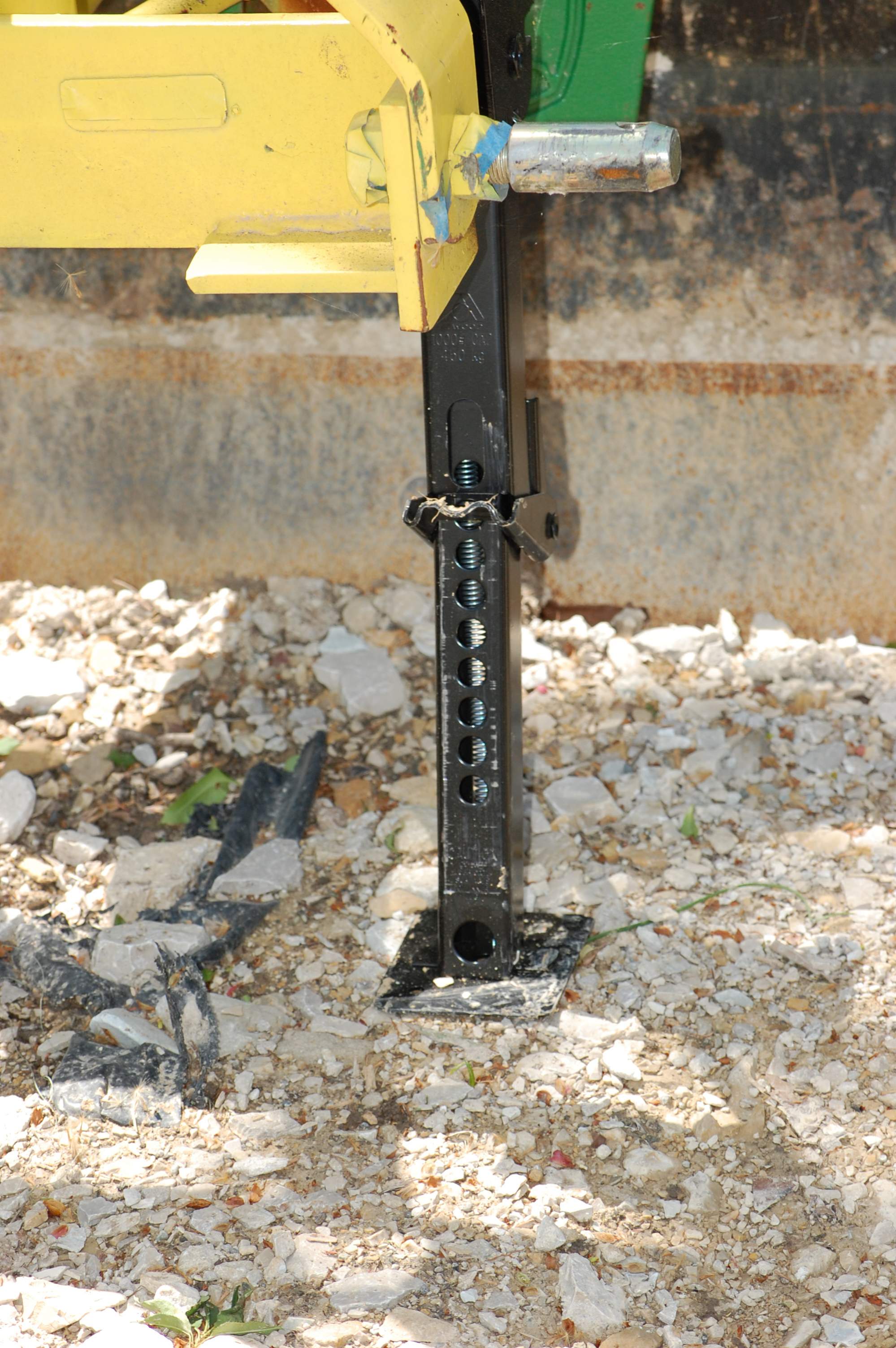

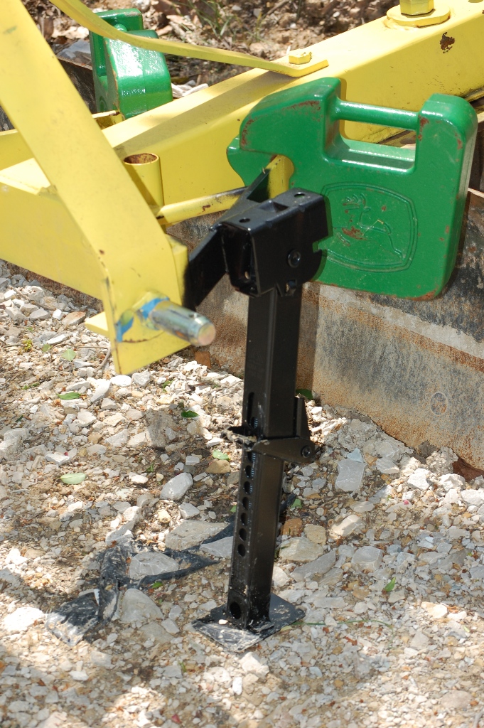

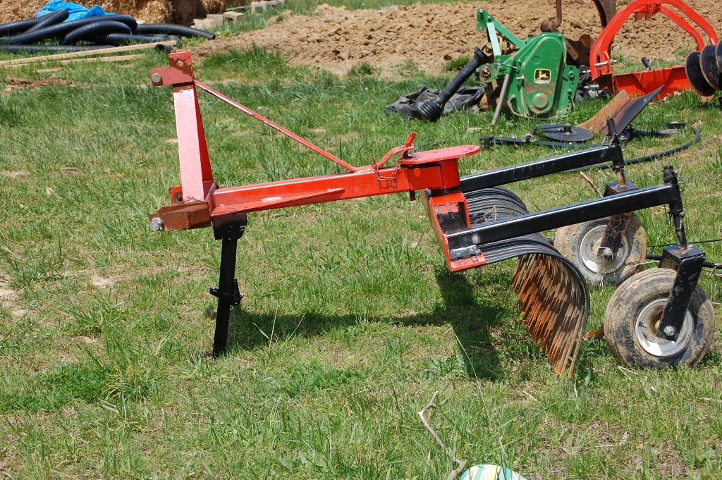

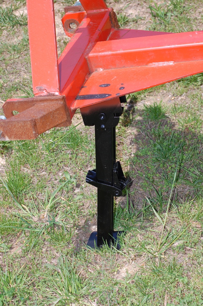

I don't have one on my tiller, which has a decent kick stand already, but here is what I did for the rest of my stuff.
I used the adjustable stabilizer jacks for trailers. They're ~ $20 ea, hold 1000 lbs and seem to work well. I added a spring so they retract automatically when you press the release lever (with your foot).
I use my rake and blade away from home a lot and didn't always have an even surface to swap on. With these stands the quick hitch doesn't have a problem attaching when the implement is on uneven ground.

Wow, very nice. And, where do you find these jacks?
/ Tiller kickstand #8
Thanks,
It's an Atwood 275200. Most trailer and RV places have them in stock or they can be found all over the net. There is a handle they sell seperately that isn't really needed unless you plan to put 1000 lbs on the jack.

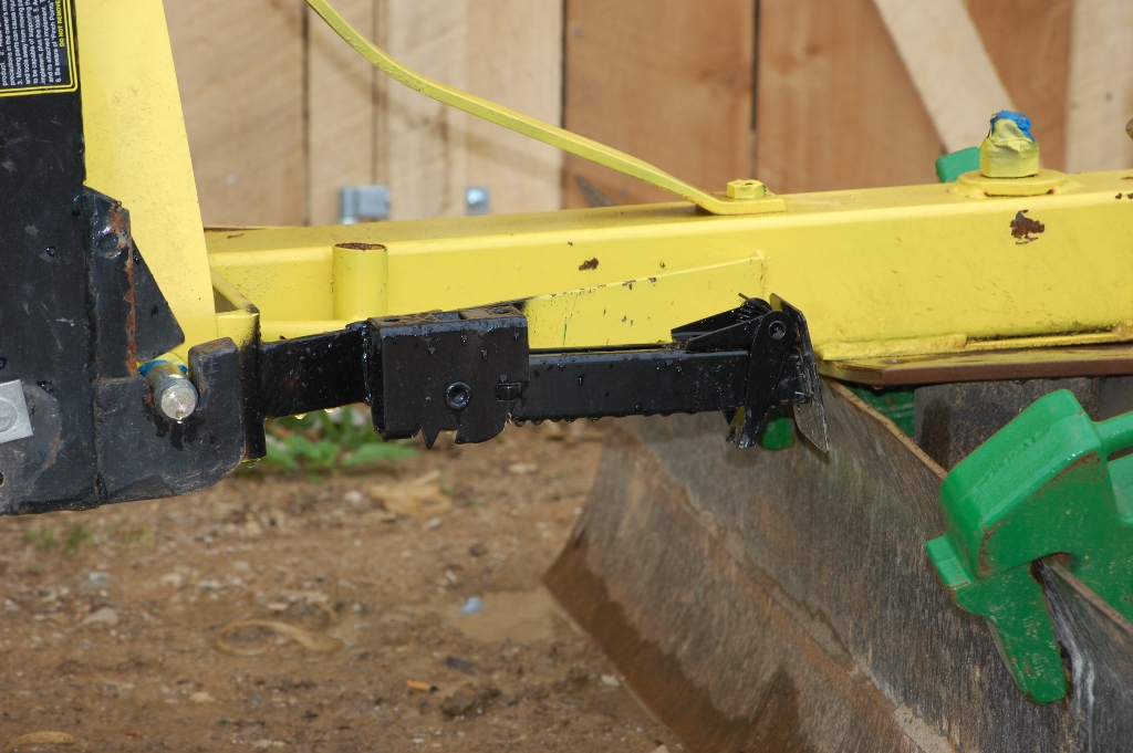

Not only do they extend and retract but they also swing up and lock in place. All in all they are very versatile, especially for the price. If it ever stops raining I'll take a pic or two of them retracted and folded up, very compact.
I bought mine locally but this place has them pretty cheap:
Atwood Stabilizer Jack - KMT Trailer Parts

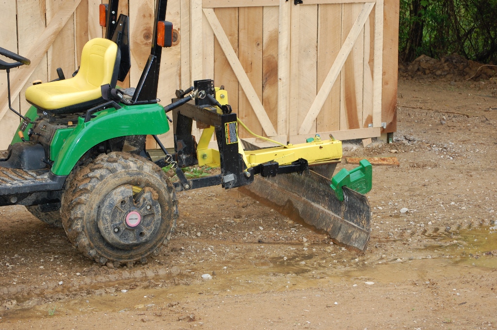

Here's the stand retracted and folded up.
