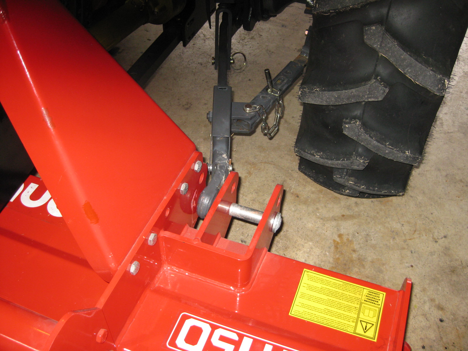

I do like the clevis hookup on the Tonutti. I don't like the chain drive though. Also I think they may only have 4 tines per flange. A KK XB would be about $200 less than the Tonutti with my dicount for buying a tractor from the guy I think I like the Howse as well, just don't have any sellers in my state. Wouldn't want to buy without seeing. Shipping would kill me too. I like how the Howse sets back further. Seems like that would be a nice feature. This morning I was thinking I would go with the KK, now I'm back to being confused. Wish I could line them all up to look at. Not sure if they will be at the farm machinery show next month or not.
Wonder if anyone other than that does the clevis hookup?

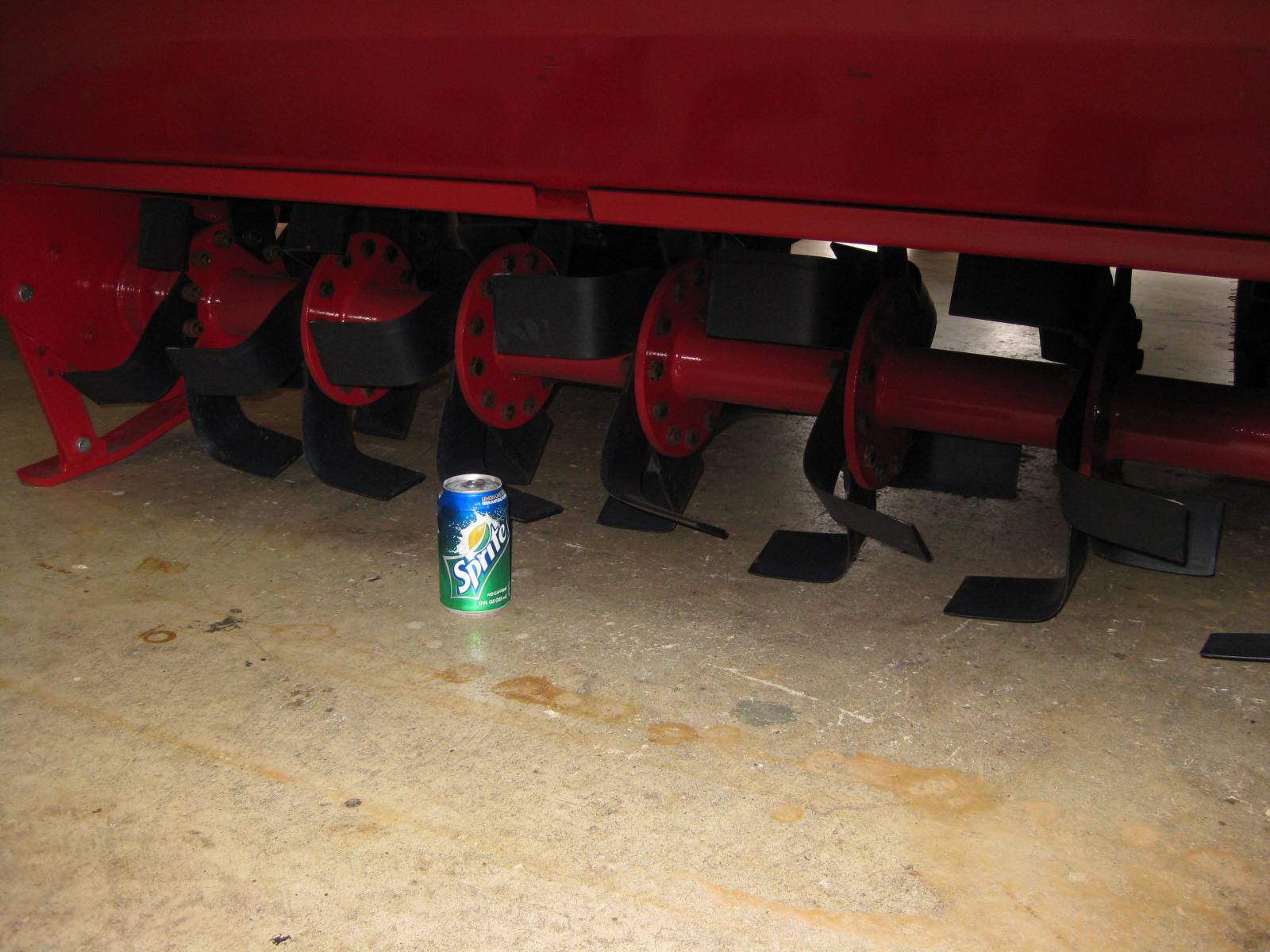

I think the Phoenix has clevis hitch.. The tonutti I have has 6 tines per flange.. I also think the tines are heavier and larger than some others?? Pics below.. Chain vs Gear?? still dont know which I like better- gear souds better.. but just dont know how better it is? Again price made my mind up...
AndyG

So you got the Tonutti cheaper than the KK XB? My prices
KK XB - $1,199
Tonutti - $1,400
