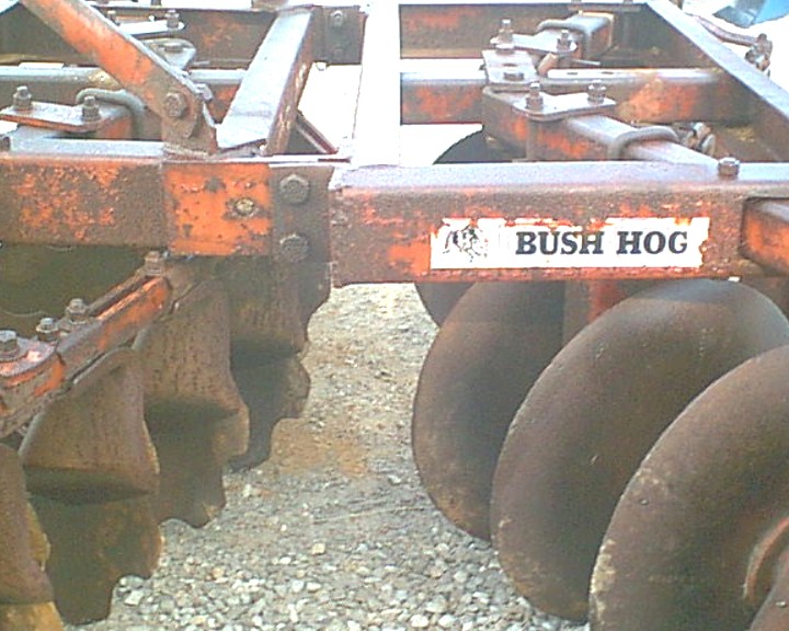

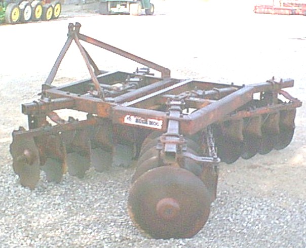

WE just got in this week a Used HD 6 1/2 foot Bush Hog Brand Lift disc with back gang that will fold up over the front to make a bog. It is on roller bearings and no breaks or welds. It does have heavy scrappers. $1195. Ken Sweet
