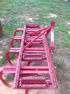

I have Workmaster 55 4x4 with a frontend loader. I just bought a Fred Cain Feild Cultivator 9 shank. This is a handy and very usefull piece of equipment. If you have roots, rocks, and hard gound this unit will work better than tiller attachment. This attachment pulls hard and has springs on shanks when you hit rocks or roots that will not dislodge.
This is my favorite piece of equipment.
