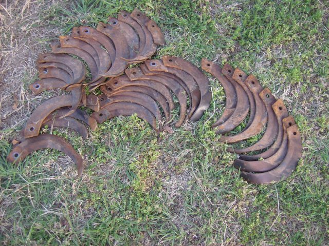

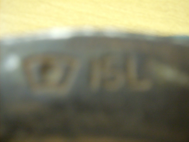

OK I'm posting some tine picturetiller 005.jpgtiller 006.jpgs. The numbers on the one blade is 15L

That is a big pile of tines that you have.
If you replace 100% of the tines, then you may have some flexibility in the design, for example using straight tines vs curved. Would straight tines put more stress on the end holder?
I assume the tine must fit tight into the slot where it connects to the tiller, and the bolt should fit tight, but otherwise there may be some flexibility.
Depth of a straight tine vs curved tine might best be measured on the tiller.
You could probably make a reasonable facsimile out of straight bar steel relatively quickly. Mild steel or hardened steel? Although 36 is quite a few to make. But, at $5 to $10 per tine, commercial tines do add up too. Of course, the cost of steel would also add up.
You could also cut and weld a new end to each tine, which then eliminates problems with needing to reproduce the mount.
Perhaps it is time to build a forge
   / Tiller tines #11
Again...that is a very unique tine design/mount setup...But...
...If worse came to worst and you can't find OEM (type) tines...you should be able to adapt the tine mounts on the shaft to accept a common tine of similar size...
There are more sophisticated ways of adapting the tine mounts on your tiller...but it might be worth a shot to buy some really cheap (common) tines and have them welded to the old tines adapted (cut) to make a close match to the OEM tines...
[note to CliffordK]
just noticed the last line of your post :thumbsup:

That looks like grey market tiller. One of the vendors that still do grey market importing may be to help. I had bought two grey market tillers and converted (a lot of work) the single bolt to two bolt flange style that took KingKutter tines. Those single bolt style were use in the Japanese rice paties and just don't do well in any soil that's rocky. bjr

Hi Roger,
What you got their is a old style Yanmar rice tiller with out the sheet-metal guards or guide wheel .
These tillers are designed for orientals rice fields that were for century hand tilled by human labor.
So they only work well if you have dirt only no rocks and roots . They were included in several package
deals in the US and many of them have set unused as the owners were looking for a small grass cutting
rig for property they own . Just recently I was given one similar to yours . Tines are available but high priced
and they are still designed for wet dirt only . The good news is it tills the dry ground like power ,very fine .
These tillers and the tines they have on them are designed to till flooded fields while semerged in water .
What I would suggest is working your ground with a disk harrow first or making several passes with ripper blades
down on a box blade first before using the rice tiller. This will ensure you don't snag a root or chunk of junk
with the tiller. They don't have any way to protect your tractor PTO gears from damage if you do happen
to snag something . Slip Clutch is the best insurance on the drive shaft. The video is not your tiller but shows what

Why would you not simply refurb the tines you had? I once took aprts, cleaned, straighten, and sharpened a Bolens tiller I got for free with a tractor 'cause the seller (a big used tractor picker/seller) said they were no good anymore and unfixable (You cant fix tines. You cant sharpen tines!). He also said I would never be able to use it to till my clay yard with a 10hp tractor. But it and the tiller did it just fine... sold the combo for a $300 profit :)
Not looking at your in person, but they looked like they could be refurb'ed and made to work.
