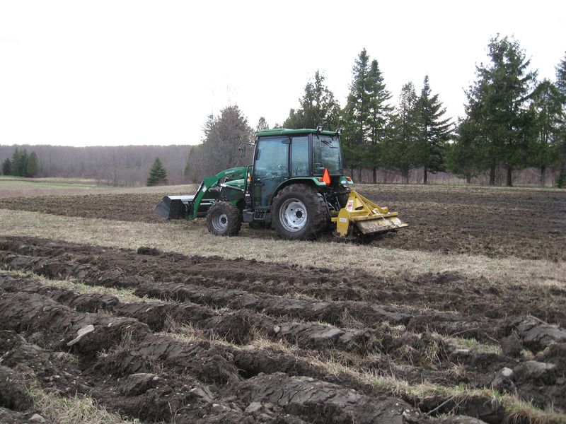

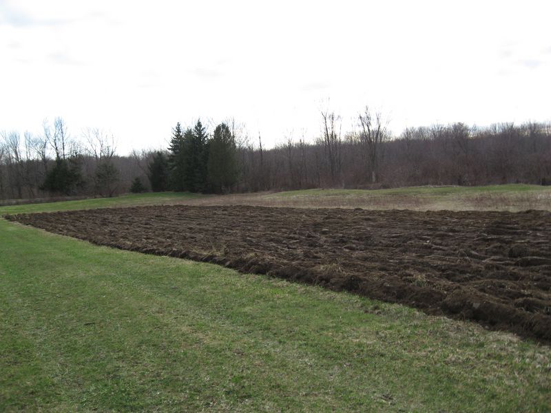

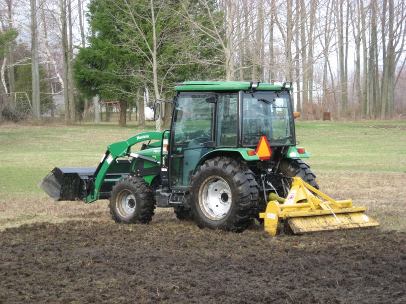

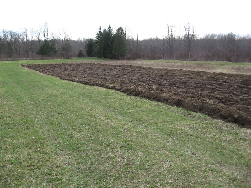

Her some pics of the new tiller in action. The field was a little wet but worked well. As I said before it has not taken me long to do it and I will probably going to make one more pass after I pick some rocks just before I start planting. Also have some pics of a field I plowed just before it started raining again.

   / Tiller vs Disc...Need Help to decide #19
Thats some rich looking soil. Now you need a drag harrow to smooth it out! What was the price on the tiller. I just got one of 1600 for a 6' KK
#20
The soil was still pretty wet when I tilled it and it was a little clumpy. I think when things dry up and I pick the big rocks out I will hit it again with the tiller and turn it into dust. I got mine for a little cheaper 1599:D . But so far I love it. Just has to dry up. the next week is suppose to be rain free and in the upper 60s to 70s.
