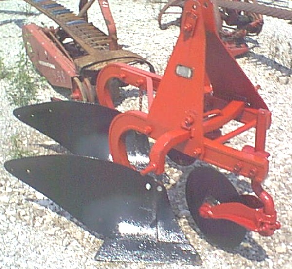

If you were going to plow then disc, what kind of plow would be preferable for clay soil?
   / Tiller vs. Harrow #38
A bottom plow in clay soil. Ken Sweet

I bought the nicest 2x16 Dearborn plow I could find. It is P A R A D E ready....and my tractor pulled it so nicely....and it turned the sod over...picture perfect. BUT.....I wont use it anymore. :(
On my soils I have about 4 or 5 inches of rich, black loam...which lies over about 1/2 mile of sand. Turn the black dirt over and put it deep.....and pull the sand up on top.....and you lose the value of the soils. Instead.....I can rip and then disc my land....or oftentimes just use the tiller to mix a the black top soil. Saves moisture too! Our water table is only a few feet below ground....so deep rooting plants thrive....and we get pretty frequent rains. :thumbsup:
So....which is better?.....IT DEPENDS ON YOUR SOIL. Give it some thought. :)
I fall plow every 4 to 5 years, but I go more than about 5 to 6" deep when I do it. Then every year between, I leave the garden trash on top through winter to preserve soil and then disc the stalks/trash/vines/etc to chop them up, and then run the chisel plow in two directions, let it sit for a couple of weeks and disc before planting. Of course, I plant with a Flex 71 planter for all of my row-crops.
If for some reason I need a more finished and smooth soil for rows, I just run a hand tiller down where my row will be and then plant.
