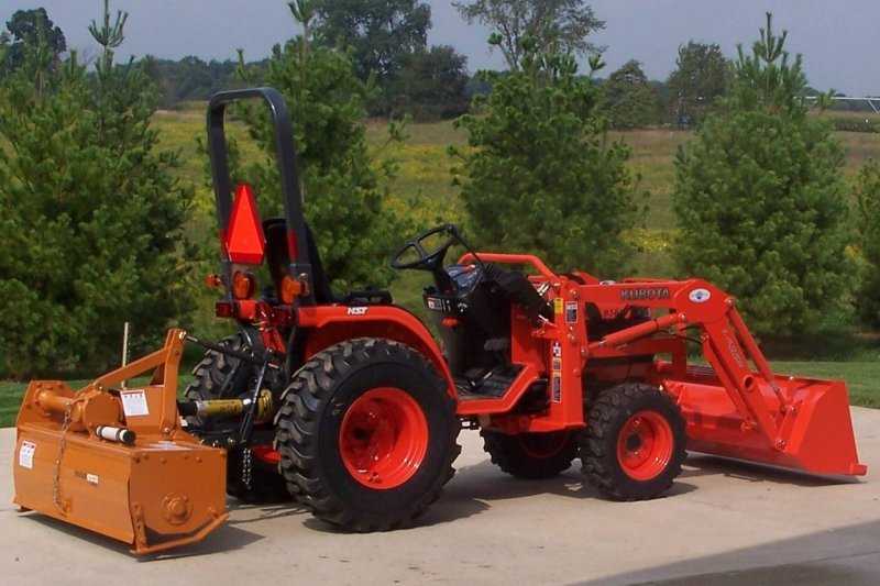

I run a 52" Woods on a B7610. It's the pimply faced little cousin to the 2410, but with the same 24 HP engine. In my soil, the 52" is a handful for this tractor when the ground is dry. Keep in mind, I have SUPER HARD clay soil. It is almost the consistency of concrete after a two week drought.
If your soil is looser, the 60" would probably be just fine. Photo of my setup attached.
