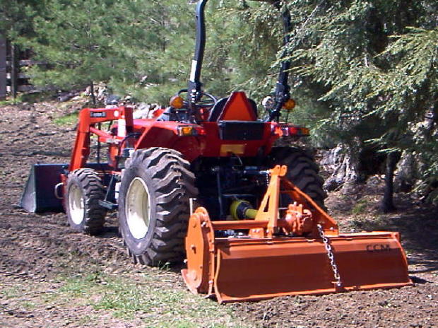

i have the ccm 66" tiller and also have 31 pto hp. it covers my tracks and barely works the engine at all. i dont think i would have any problems running the 72" in my soil, which i am not really sure what it is but you cant put a shovel in the ground without hitting a rock. i have broken 1 tine so far and wasnt that suprised with how many rocks i have, and i could probably use to loosen up my slip clutch a little. you can get the tines from mark, i think its around $17 for 2 with shipping. other than that no problems and happy with it.
doug
