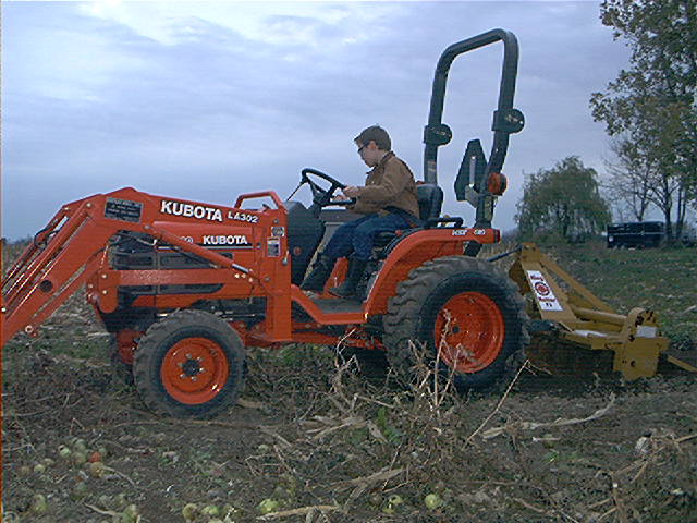

   / Tillers.. Which is better? #27
We think our KK60 is very good for the price and holds up well, even with the rocks we sometimes find.
