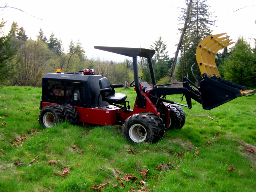

   / Tilt Dump Cylinder Saga #7
Hey JJ...
I see what you are seeing ( on the stock setup the angle from the QA Plate is too severe) but I am not sure what the cure is.
I beleive in the photo it is a factory setup. This is a newer 1850. What could I change to reduce the issues you are seeing?
As I said, this is a temporary fix. If the wife goes to work next week I am getting some custom cylinders made.
   / Tilt Dump Cylinder Saga #9
Woodlandfarms in jj picture of the tractor the cylinder is attached to the longest side of the upright part of the rollover that is one thing that I was trying to say is that if the cylinder is hooked to the shortest side then the cylinder rod would hit the rollover pin before it reached the end of it's stroke and that might be one of the sources of the rod bending. I thought that maybe someone had replaced the rollover pin and put it in with the upright part in the picture upside down. In either case if the max of the rollover is being reached before the full extension of the cylinder it would cause you a problem I believe.
   / Tilt Dump Cylinder Saga #10
If you use the cyl that you have now, the easiest change point, is the length of the solid bar link. I think you need a link bar with say three mounting holes to give different angles of dump. You only need about 10 degrees up from level, and 90 degrees down.
Depending on the attachment I am using, I have to select a mounting hole in the link. You could play around with a piece of wood with holes bored in it to test things out.
In the picture above, with the cyl fully extended, the rod travel is 18 in at the bottom of the curl arm assembly. The top part of the curl assembly is shorter, and therefore, it will move less, maybe 14 in. This 14 in will cause the bucket to tilt up or tilt down, so many degrees. If you change the mounting point, the degrees of tilt will change. The amount of bucket tilt will be determined by where the end of the link is attached, and that looks about 5 in from the bucket pivot point.
Trial and error should help you find the best solution.
There is a maximum length on the tilt cyl rod to keep it from crushing the tubes connecting the lift arms. You could even try a wood test stick there to find the optimum rod length.
