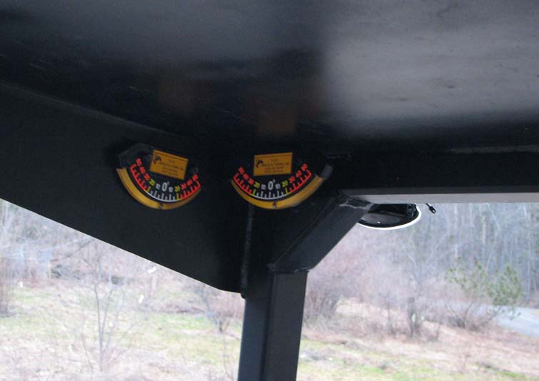

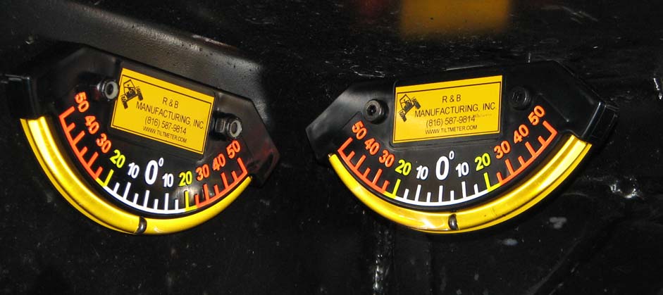

I like also having a fore and aft tilt meter because you can check a suspect slope forward and see what it reads before trying sideways. I have it more for curiosity because I can not imagine even trying the 45ー slopes my tractor is rated for.
