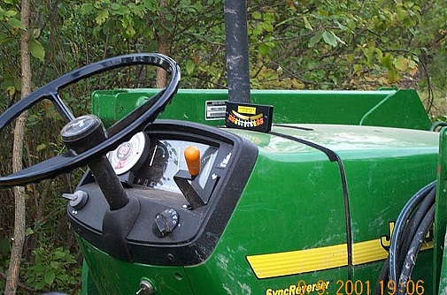

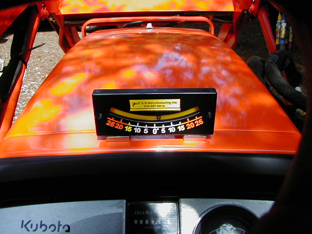

Hi EBS, and all the Guys,
I recommend in the instructions that come with all the
tiltmeters that a magnet not be used to mount the meter.
Two reasons. First, the ball is stainless steel, but still
slightly magnetic with a strong enough magnet. Second, a
magnetic mount will allow the meter to move out of level if
struck with a limb, etc. Lets say it is moved 5 degrees, and
you think you are on a 15 degree slope, only to learn from
the accident investigator that you were on a 20 degree
slope. BUMMER!!!!! Don't say old Rick didn't tell you so.
