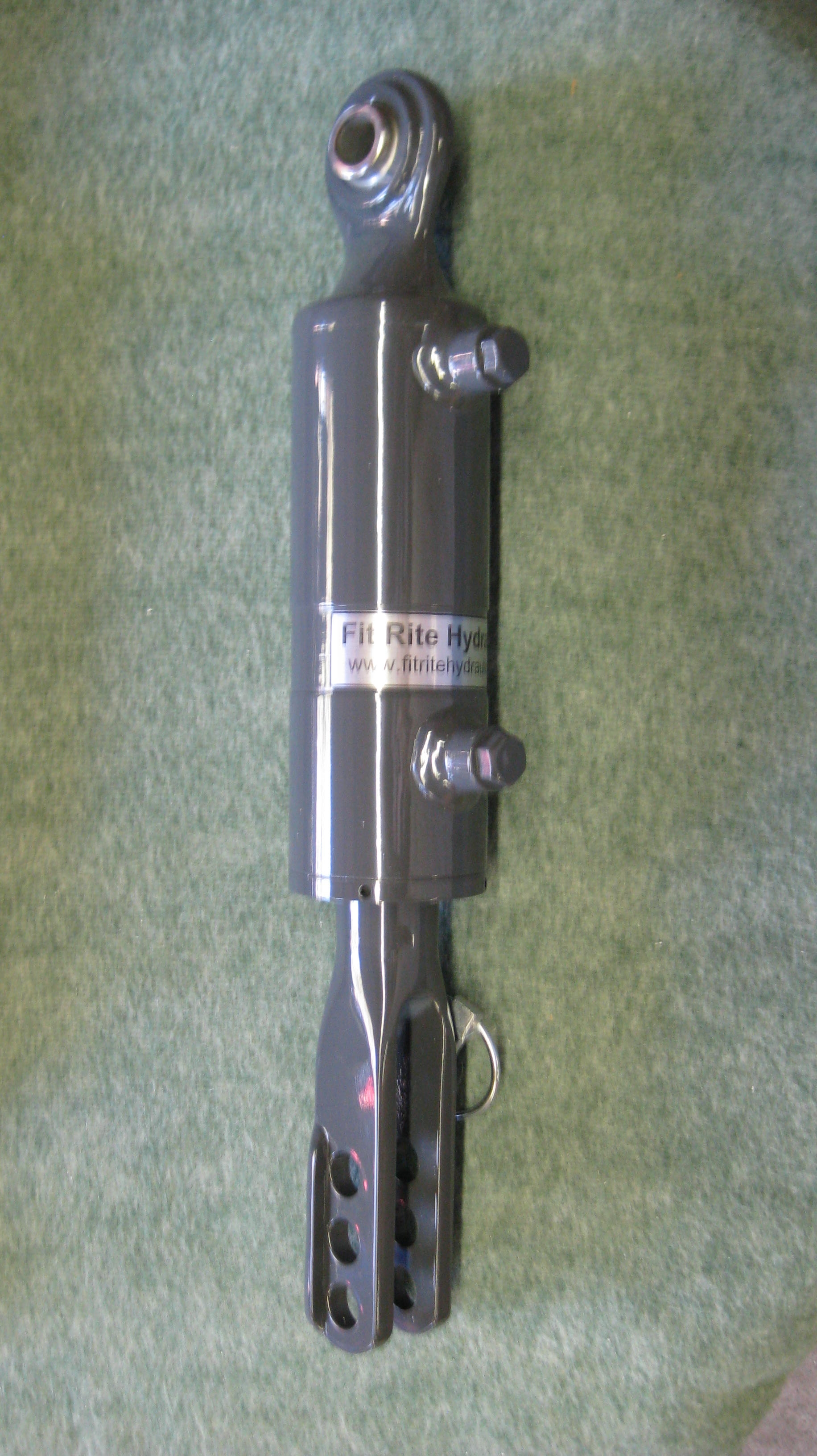

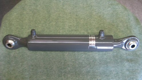

If you decide that you want the best T&T set, $1419.49 tax & shipping included.
/ New Attachments coming this week!!
#11
Thanks. A couple questions:
  1. Do you fabricate your own hydraulic cylinders?
    • If yes, do you sell seal kits or do they use common off the shelf kits available all over?
  2. For the M59 I believe the 3PT can lift right under 4000lb, would you go with the 2.5" or 3"?
  3. Which brand and model hose do you use?
    1. 3\8 or 1\4?
  4. I use skid steer quick connects, so I won't need the AG style, not sure if that's part of your kit or not, but maybe save me some money :D if It is, ha ha :)

Yes, I build all of the top & tilt cylinders that I sell.
I do not sell seal kits, they are warrantied for as long as I am in business.
You can get about any cylinder seal that I use from MCmaster-Carr. Seals are always available, you just have to look.
2 1/2" cylinders with 1 1/2" dia rods. I have built many of these sets for the M59 & M62 TLBs, have had ZERO issues to date.
I use flexdraulic R17 hose. The cylinder hoses would be 3/8" hose.
I do not supply flat face couplers, maybe you should just take care of all of the hoses needed for this installation. A $178 credit including the shipping cost.
I'm fairly sure that I sent you a quote last year. Maybe take another look at the quote from Oct 26 2024.
