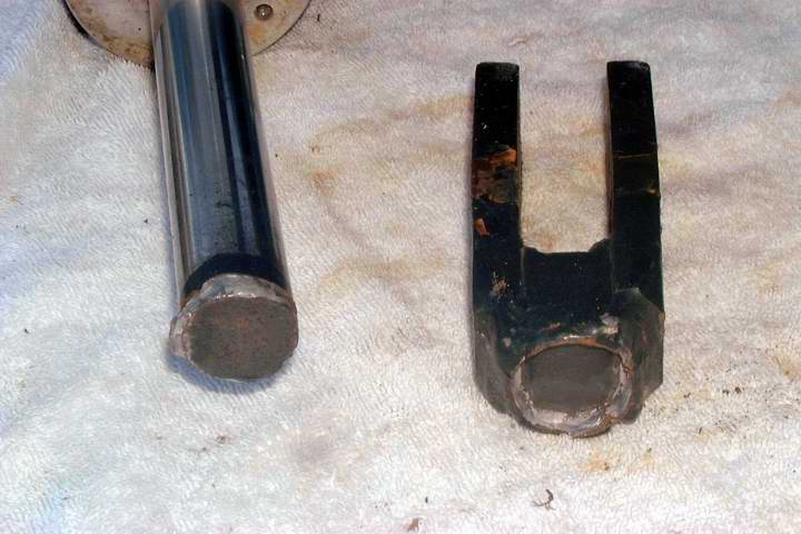

I was using my subsoiler today to dig up some shallow roots in brush when I heard a crack and looked back to see that a lynch-pin had been plucked out of the left lower link. As a result the arm came off the pin and the subsoiler twisted. the stress was enough on the remaining right lift arm to snap the welded-on fork off the bottom of my tilt cylinder (see attachment). I think the weld should have been a lot better than the picture shows, but all things considered, it will be an easy repair. I'll also take this opportunity to take about 1-1/2" off the cylinder's rod because it's about that much too long.
The way I figure it is if you work in brush enough, you are going to have these things happen from time to time. /forums/images/graemlins/frown.gif

Grind a large bevel on the end of your piston rod before you weld it up. It will not break the next time.

I don't know for sure, but I think that if this is a two-way cylinder you could damage the piston and/or piston seals by shortening the cylinder rod. It will bottom out in the retracted position before the piston bottoms out inside the cylinder. Maybe some one else knows more about it, but I think I would check it out. /forums/images/graemlins/confused.gif

actually, by the looks of the cyl, if you shorten it that much, it will bottom out on the end of the cyl ( which isn't a real big deal) but the weld will try to go under the end seal, and will ruin your seal.
push your piston all the way in, and mark where it enters the seal. then pull it all the way out b4 welding, and make sure nothing goes past that mark, or you'll have troubles.

You are exactly right, Jim. I didn't mention anything about it, but I think my TISCO cylinder should have been welded much better. My welder and my level of experience are not that good, but my NH dealer has excellent welding in his shop. I'm going to take the cylinder to them and ask that the rod be cut and beveled before being rewelded.

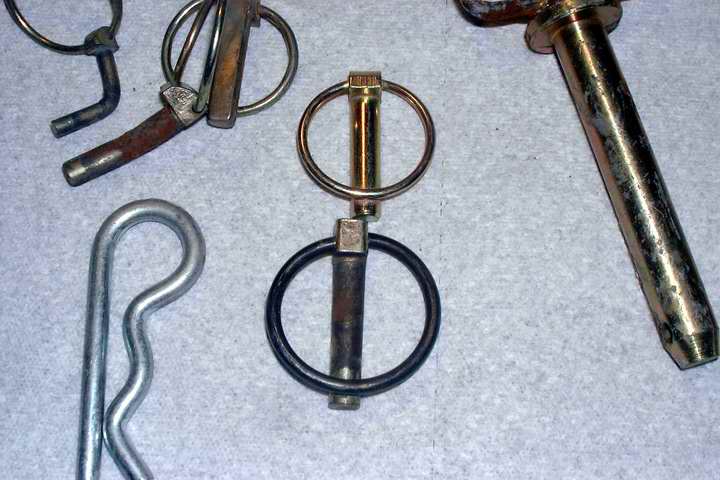

johndeere2210 & theonlybull: Thanks! Your advice is excellent. It turns out that the rod has 5" sticking out when fully retracted. I'm baffled as to why the cylinder had about twice as much rod as needed for it's full travel. Maybe that was to keep heat away from the seals while welding on the end of the rod. /forums/images/graemlins/confused.gif Anyway, after I shorten the rod, it will still have over 3" to spare when retracted.
beenthere: I change implements a lot. Yesterday, I had a boxblade, two different style bale spears, and the subsoiler on my 3PH in a period of less than two hours. Generally, with my boxblade and bale spears, there is no danger of getting the lynchpins plucked out. I had a brainstorm and decided to try the subsoiler to grub up some roots. It's pins are very exposed and my decision to use the cheap, 3-for-a-$1 lynchpins was a mistake. Your method of using bolts is one I've used before. Also I use a hairpins and push them all the way through when I run my rotary cutter. I've found lynchpins that cost $1.50 ea are much better, but don't get your finger caught in them. /forums/images/graemlins/blush.gif I'm attaching a picture of the "good, bad, and ugly" pins. The brass color pin is cheap and ends up like the stack of bad/ugly pins in the upper left of the picture. The larger pin is much better and the hairpin is almost foolproof when pushed all the way down into the big loop. /forums/images/graemlins/cool.gif

All the beveling in the world will not help if you don't get proper penetration. Having an experienced welder weld the fork to the hard piston is a good idea.
